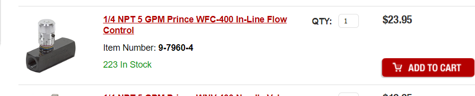

In order to slow operation of frt end loader boom down you could install an adjustable flow control valve similar to photo below. I installed a valve similar to one in photo on a Kubota M4900 FEL so large rd bales were easier to lower after raising.

Interesting Jim! Where does that go in the line? Can it adjust the flow from just anywhere? I guess so since it's a circular route. A very small adjustment would probably do the trick.

I put that valve in the curl dump circuit on my Branson. It's to reduce "bucket flop". But it can be adjusted to slow the dump motion.
It's a simple one way needle valve. You'd need one for each set of cylinders (raise, curl) and each direction that you want to slow.
If you put one in the pressure line to the loader valve that would restrict flow to the 3pt and any other hydraulic valves, which is not what you want.

So you'd need 4 of them? Put one pointing in each direction on the raise cylinders and one pointing in each direction on the curl cylinders? Can they be connected right next to each other? Strange that with all the technology on today's tractors there's not a way to adjust something like that. :(

If you used needle valves without the one way feature you'd need one per circuit. I put my valve where the flexible hose connects to the hard line on the loader frame. I can reach it while standing in the operator's station.
I slow the engine down when I want the loader to move slow. The pump's flow is rpm dependent.
