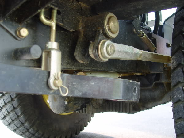

I have a 2520 and don't know if the lift linkage is exactly the same or not.
I think what Kennyg is referring to when he says adjusting the up limit to the frame is this:
Start there underneath the tractor. When the deck is in the raised position, that lift arm should be 1/8" below that black pin. In this pic the lift arm is way too low. There are 2 adjustments to be made - one shown in the pic, and the other on the linkage going back to the 3 point hitch. You have to make these adjustments in small increments and find a balance between the 2. Be very careful not to adjust it up too high - if the arm goes hard against that pin you will start bending stuff.
The exact procedure should be in your deck manual - try reading that.
You also might get some more responses in the proper section:
http://www.tractorbynet.com/forums/john-deere-owning-operating/
   / Adjusting cutting height for John Deere 2320 Onramp 54" mid mount mower #6
On the 2320 there is no stop for the lift arms as shown on prosperity's picture. The uplimit is a bar on the mower frame (in front of the gearbox) that will hit the frame if it's lifted far enough.

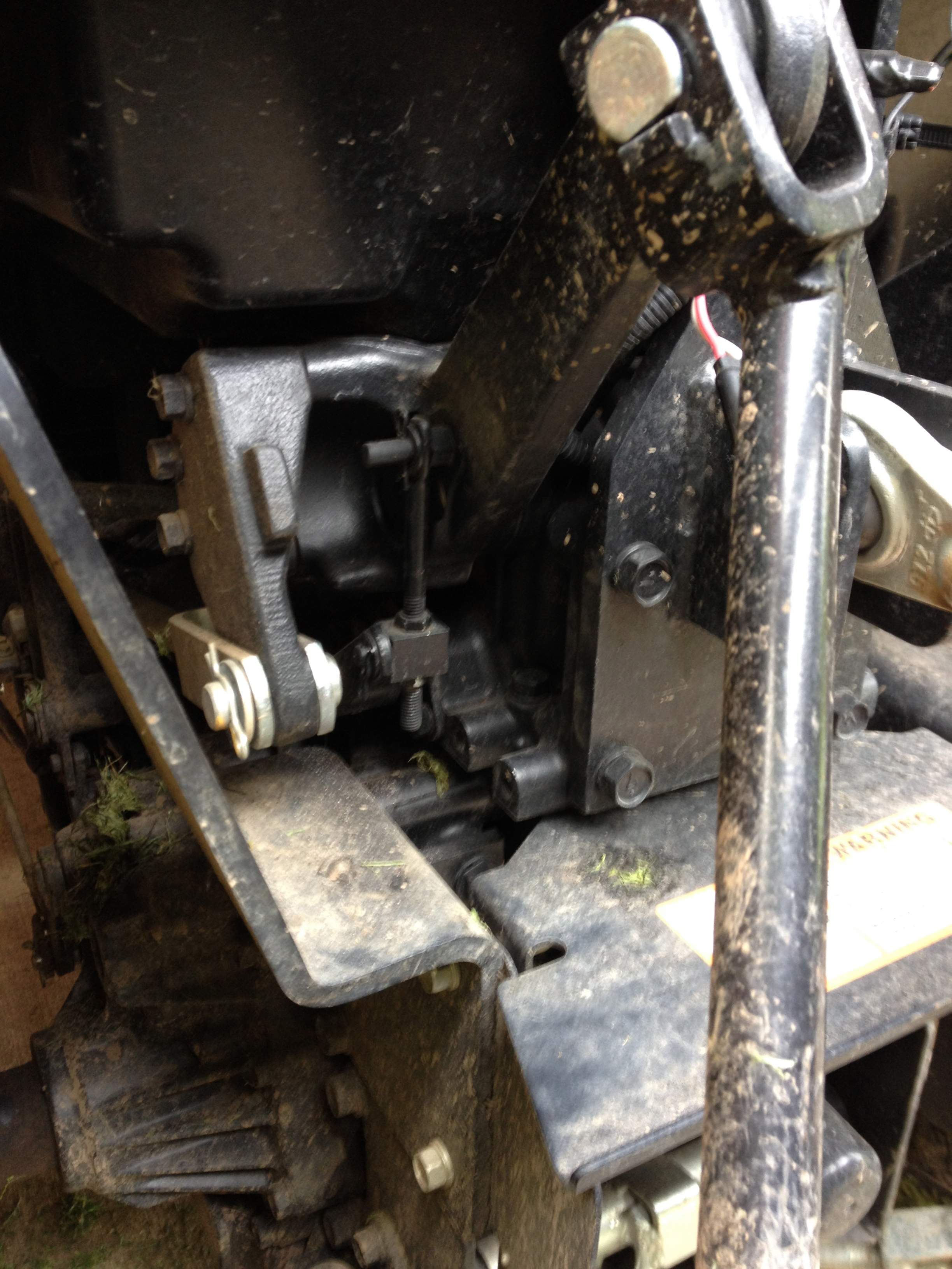

I have a 2010 John Deere 2320 with a Onramp 54" mid mount mower. I am having problems adjusting the height of the mower. The max cutting height is 3 1/2" when the mower is all the way up in the locked position. When I put the 3pt mechanical lever down on the highest setting on the mower deck height adjustment knob the cutting height drops to 2 1/2". The manual states the cutting height is 1-6", the highest setting I can achieve is 3 1/2". I would like to mow my lawn at 4" and field at 6". What do I need to do to increase the cutting height?
I have a 2013 2320 and it also has a faulty deck adjustment system. The mower deck is within an 1/8" of the stop, and my highest mower adjustment is about 2-3/4". Deere needs to redesign the cam so that the steps correspond to usable mower height range. The adjustment to the 3 pt hitch doesn't help the adjustment knob at all. If it picks it up high enough so the cam can turn 360 that is enough. Any further shortening of that link will just bend the arm or mash the deck into the stop. My mower arm links are adjusted up all the way and have no adjustment left - in fact the threaded rod would start to hit the clevis pin if they were threaded any further.
