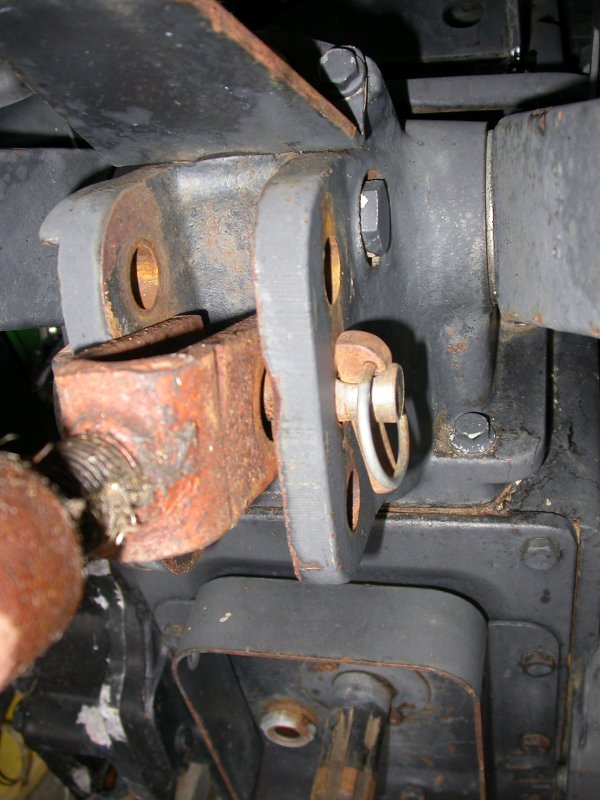

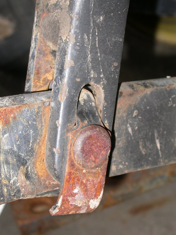

here is a picture of the locking tabs that connect the lift link to the lower arm. there is alot of space above, so not sure if this is reversible so that the lower arms sit 1" higher.
i have the top link in the center postion.
looking at the tractor from a distance, it doesn't look too bad height wise, but it's only 16" off the ground.

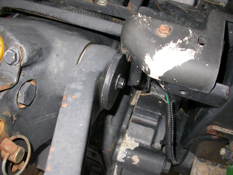

here is the upper arm/rockshaft, with a picture from the parts page. the upper arm is bolted on, and is splined to engage a splined shaft. if all of the splines are equal (not indexed somehow w/ a larger tooth), one could probably slide the upper arm off, rotate a given number of teeth, and change the max/min height. not sure about the geometry of the stabilizer links if max height was changed.
i'll probably just leave it alone for now.

Just checking if you are aware that slot and tab is for changing between floating and non-floating links.
