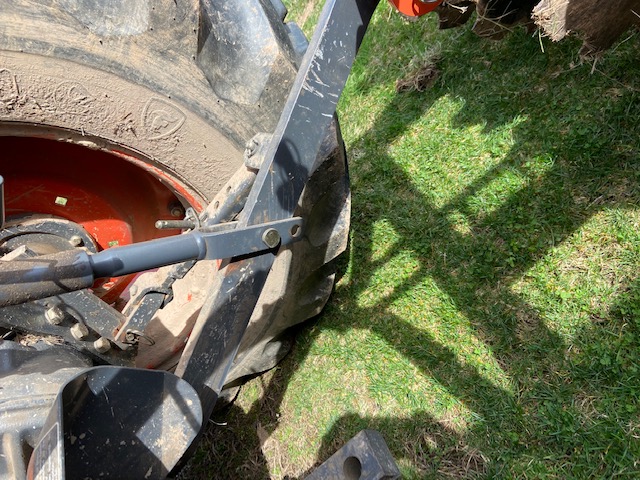

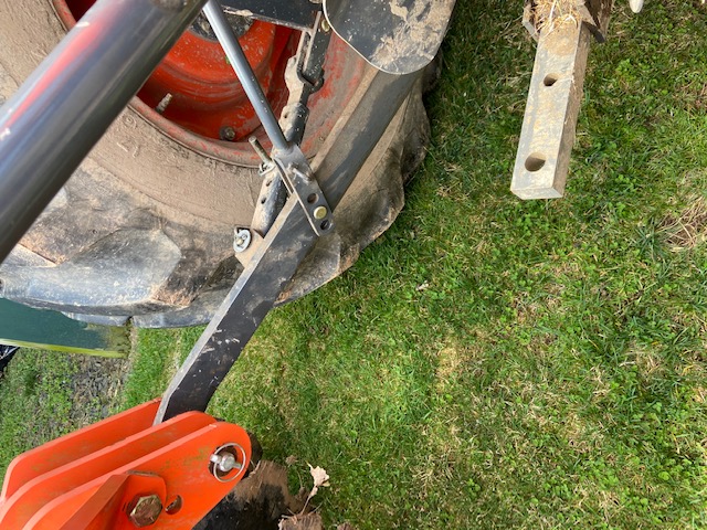

I have a Kubota L Series with these adjustment holes between the lower links and lift arms:
The manual explains what holes to use with the top link and why but makes no mention of these. Where should I have these set and why? Thank you.

I use the adjustment holes on mine so I can raise the load higher from the ground. Example, I have a 250gal tote that I converted to a sprayer. With the lift arm in the lowest hole the tote is only 9-12" above the ground. Using the top hole the tote is now about 18" above the ground. Yes, I could move the pins on the tote lower but it is easier to adjust the lift arms.
