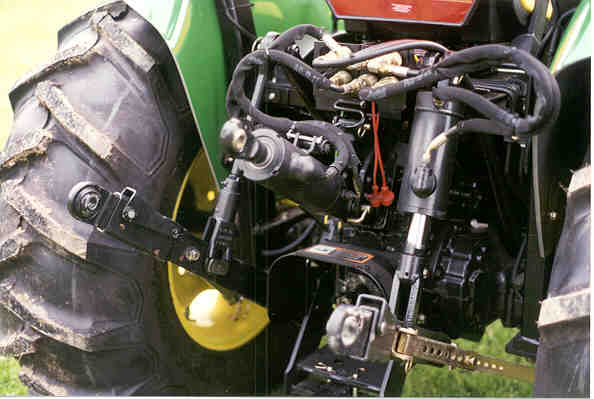

Pat....
In the attachment you can view the two telescoping draft link ends. The top levers will pop up a bit and the ends then extend about 7-8".
...Bob

Rancar,
That is what I am looking for thank you for posting the photo. I will try to see if they have them for a 4700 and see how differnt they are.
