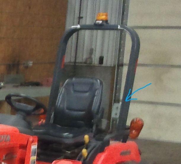

I had a BX2660 that I just traded in. On the rops, on the left side, there is a plate where the slow triangle mounts. I took the mount off. I went to Home Depot and got a outdoor single gang pvc outlet box with a blank cover and gasket. I then mounted the box on the plate and ran my wiring to it. I drilled two holes and installed toggle switches with the outdoor rubber boot over them and it worked awesome and looked like it was supposed to be there. I don't have a very good pic. I'll try to find a better one, but here is what I do have.

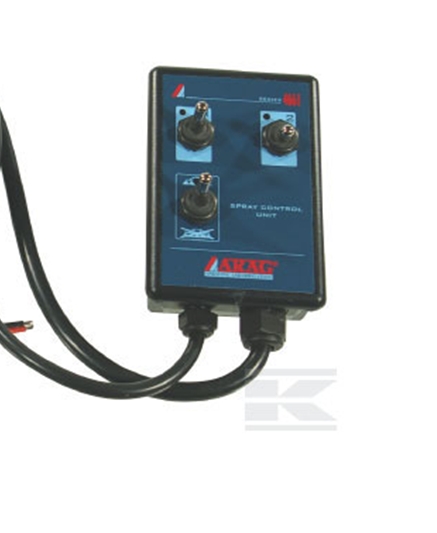

Found this box with switches. The location on the ROPS is not so good. Need to be able to operate them asap when I'm at the end of the field.
Problem is where to mount the box. On the fenders no room.....

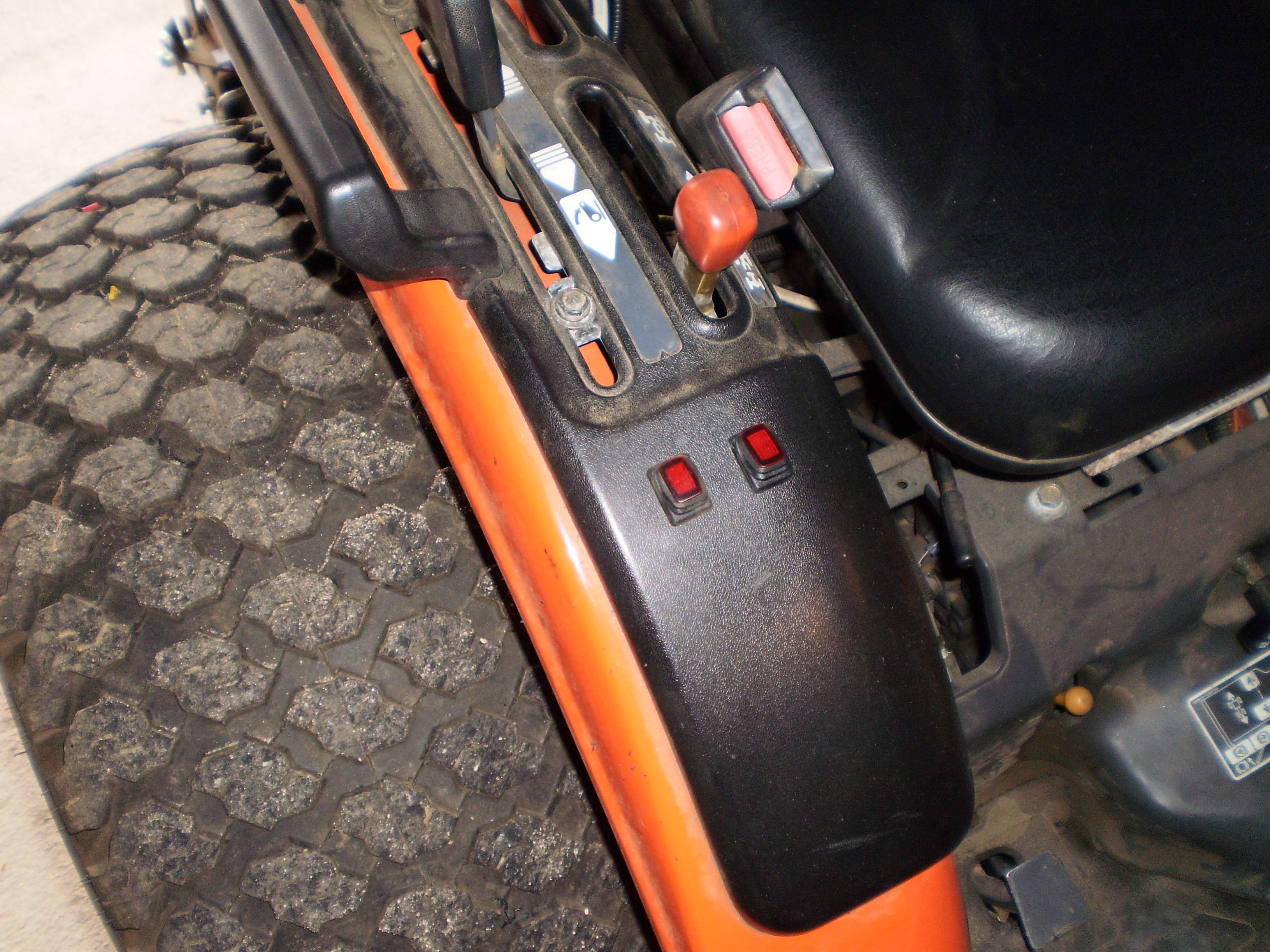

I added some small round illuminated switches in the lower area of the dash. I Bought them on Ebay and so far they have worked very well and look nice also. Got red, green, and red and they are flush mount so no accidental on or off.
