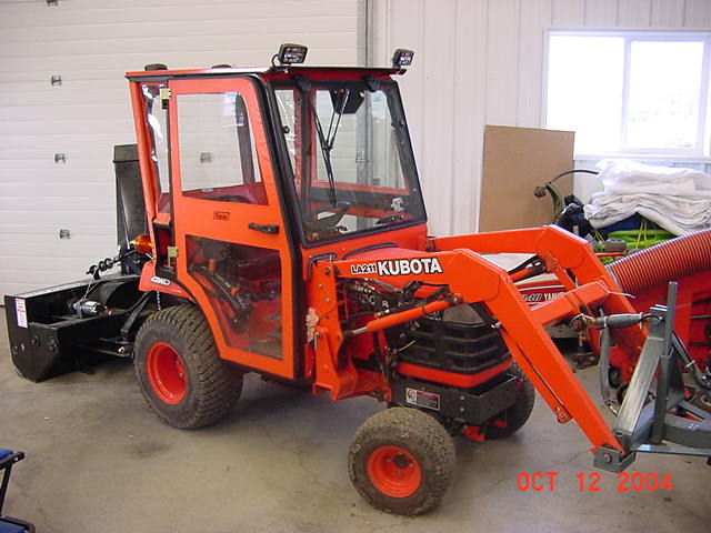

   / Additional Lights without alternator upgrade #4
I recently installed a Curtis cab on my BX. I added two 55 watt rear and two front. I hooked up a voltmeter to my battery, turned on the factory front lights, and the meter showed a drop from around 14 volts to about 13.25. When I turned on two floods, and let it sit for a bit (half throttle), it dragged down to close to 12 volts. Turning on two more floods brought it below 12, and was still dropping before I gave up and ordered the alternator. I still had the heater to switched on. I have all sorts of charging capacity now, with the alternator.

   / Additional Lights without alternator upgrade #7
What brand cab did you purchase? Can you post some pictures of it???? thanks Junk.......
   / Additional Lights without alternator upgrade #8
Junkman, it is a Curtis Cab with the soft sides. I'll try to get some pictures tonight (keep forgetting). It installed quite easily and it is a lot better than sitting out in the cool breeze like I have done in the past, but it isn't near as nice as a factory cab on the larger tractors.

   / Additional Lights without alternator upgrade #10
Here's a picture of the cab
