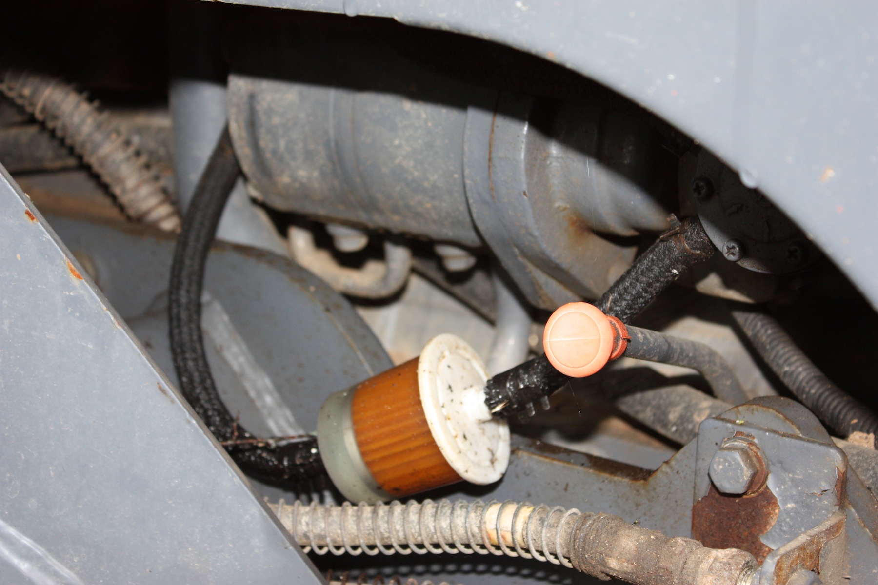

Will anyone who put an additional (extra) fuel filter on their CK30 tell me/show me where they put it?
Thanks!

I put a small in-line one between the tank and the fuel pick up pump.
Will post a pic later...
Lloyd

Thanks for the picture, I've been staring at that single filter for years!!

   / Additional Fuel Filter CK30 #5
jimmyj,
There has been some problems lately with crud coming out of the tank and creating a problem with the fuel pick up pump. The filter corrects the problem...
Lloyd
PS: the factory filter is installed after the fuel pick up pump - before it goes to the injector pump.

Why, is the factory one not adequate?
The factory filter is between the lift pump and injection pump, any crud or debirs in the tank can get in the lift pump and plug up the diaphram. A simple in-line filter as pictured takes care of it.
