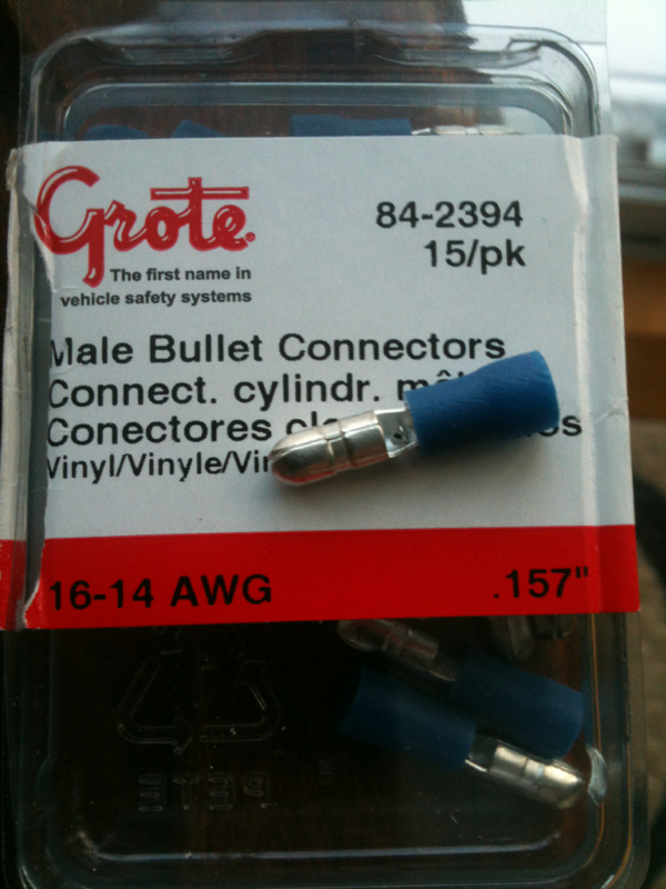

Thanks for your help Fuggley, next time I'm in town I will pick up a set of corresponding connectors and probably just mount the light where the existing holes in the support plate are.
   / Adding work Light to Rear for Snow Blowing #6
Male .157" bullet connectors like this seem to work ok.
