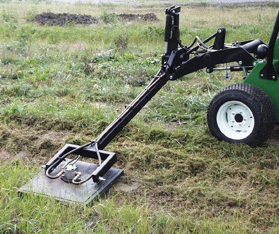

These are some of the hyd cutters from Power-Trac. The one on the green mower, is using 8 GPM's for the hyd motor.
The larger hyd cutter on the red machine, is using about 15 GPM's to run that one. It also has a counter weight. Both are fully articulated.
To add your equipment to the bottom of your post, select MY Home at top, then on left, select Edit Signature.
Copy and paste your equipment and attachments from your profile into your Signature
