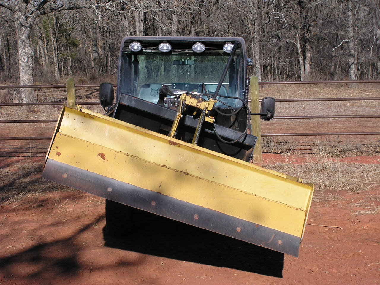

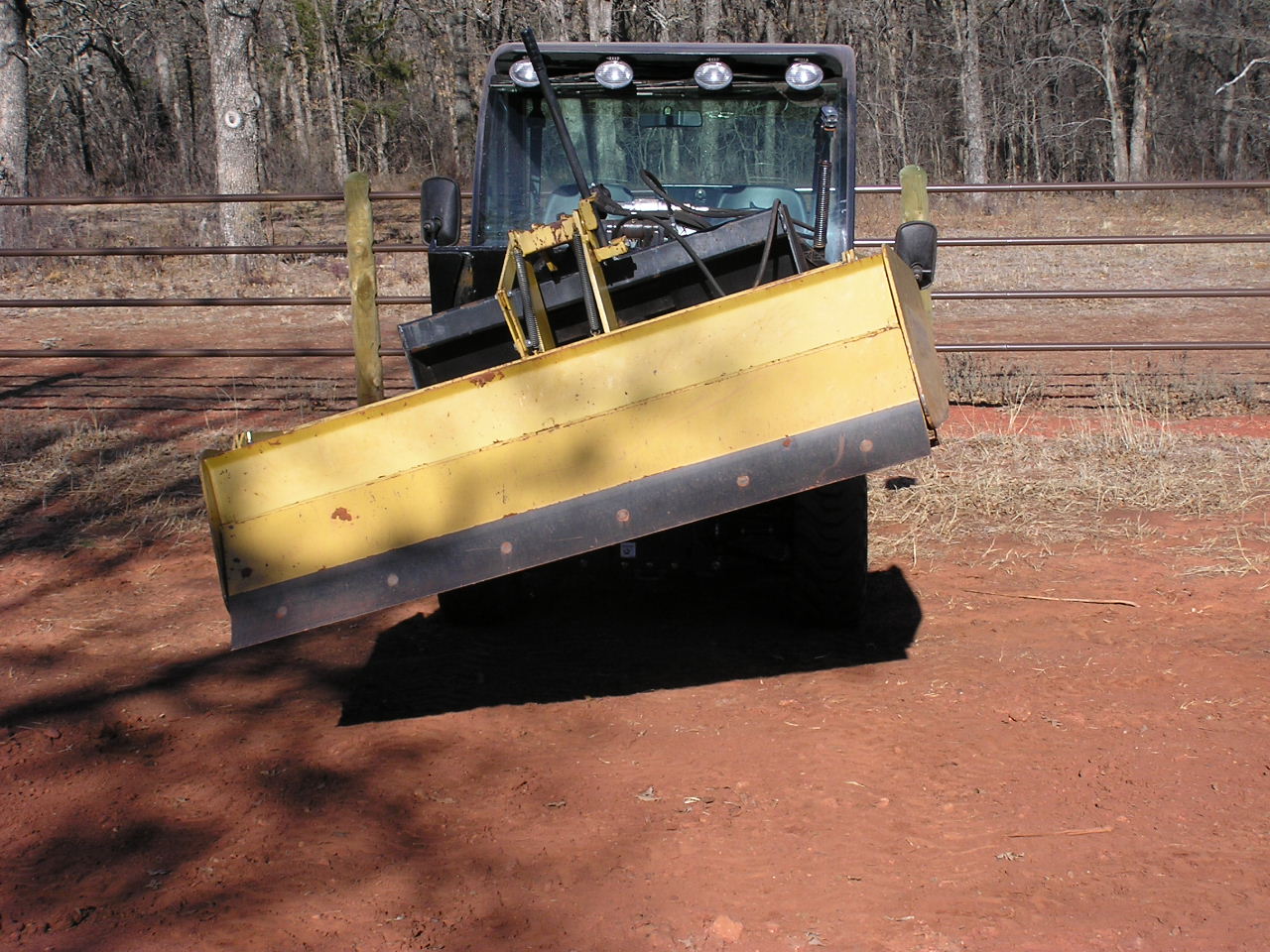

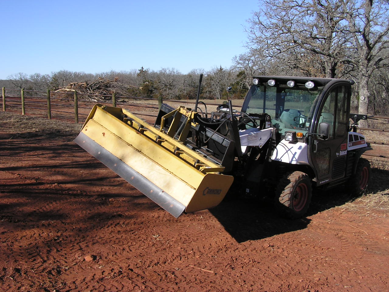

Just so there is no confusion, what you want is curl.
This is tilt.
