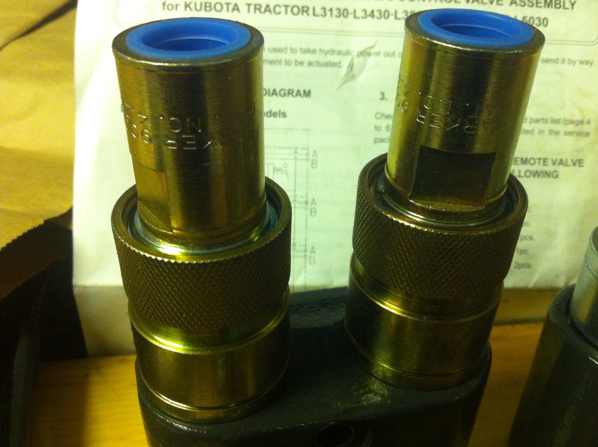

I plan to add a third RR and also re-instate the 2nd which is currently disconnected. Its QDs are instead connected to the hydraulIc PTO circuit. But the idea of a hydraulic PTO at the back of the tractor appeals to me so I want to keep that as well. Preferring to stay with the original style QDs I have found some part kits on ebay. As my current remotes doesn't have float it would be nice with a float-equipped.

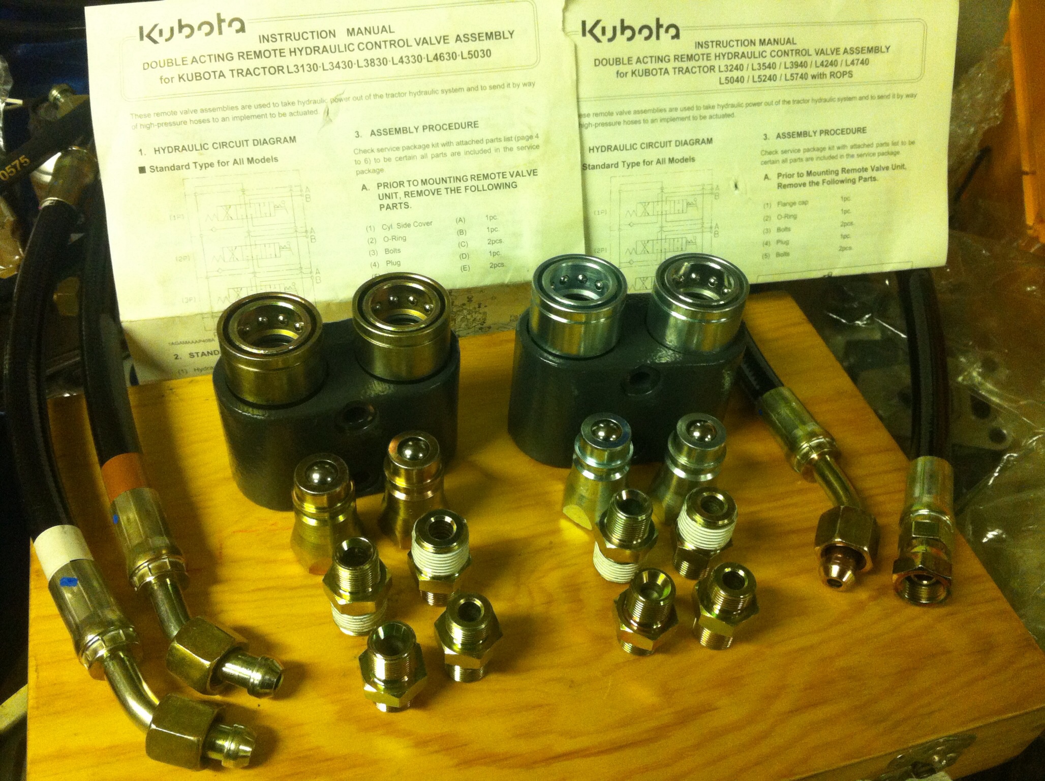

I have bought the following;
L8307 Third position remote lever kit for L30 series
L8304 Float detent valve
L8337 Third position remote lever kit for L40 series ( just for the QD parts and hoses)

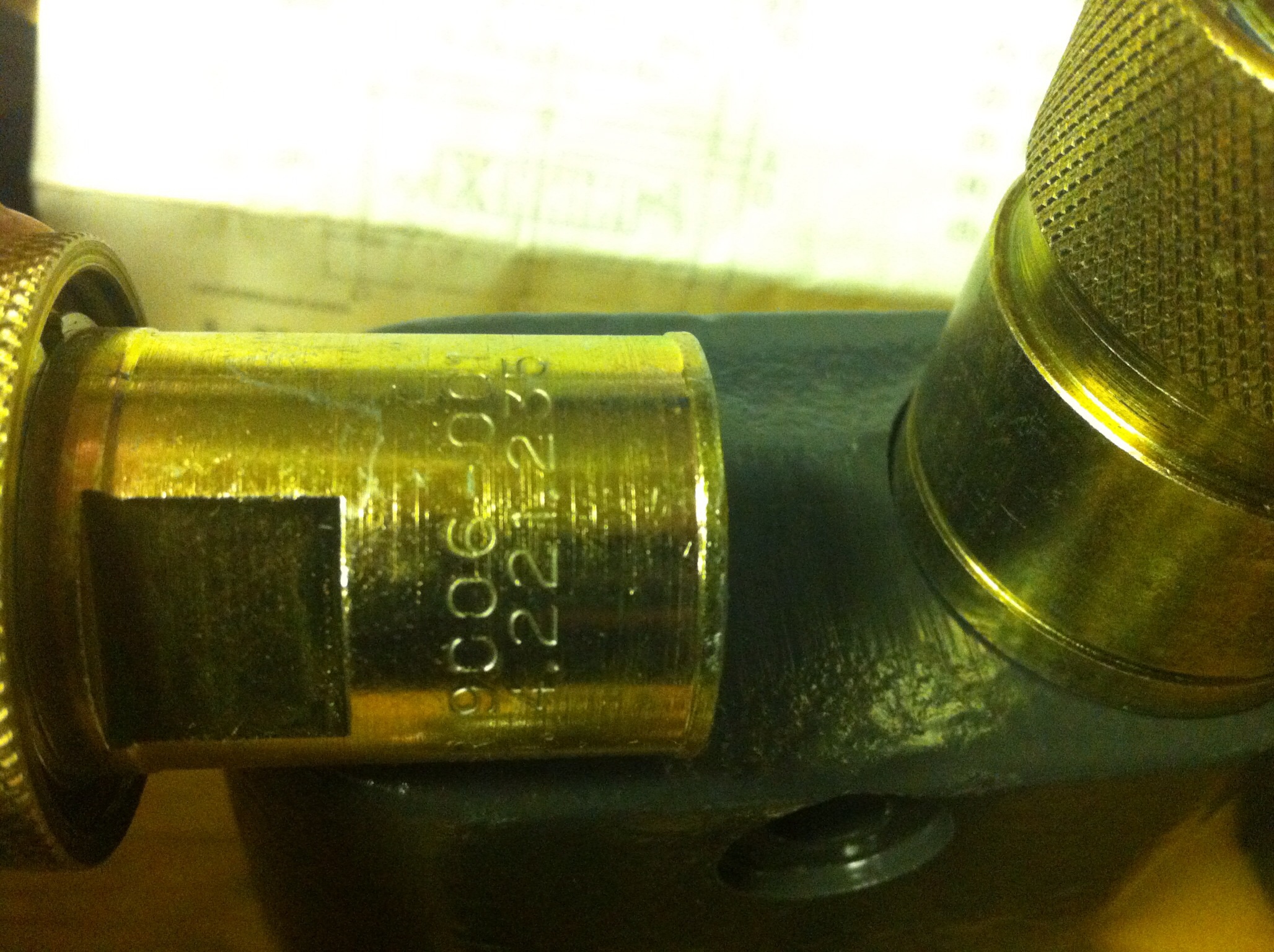

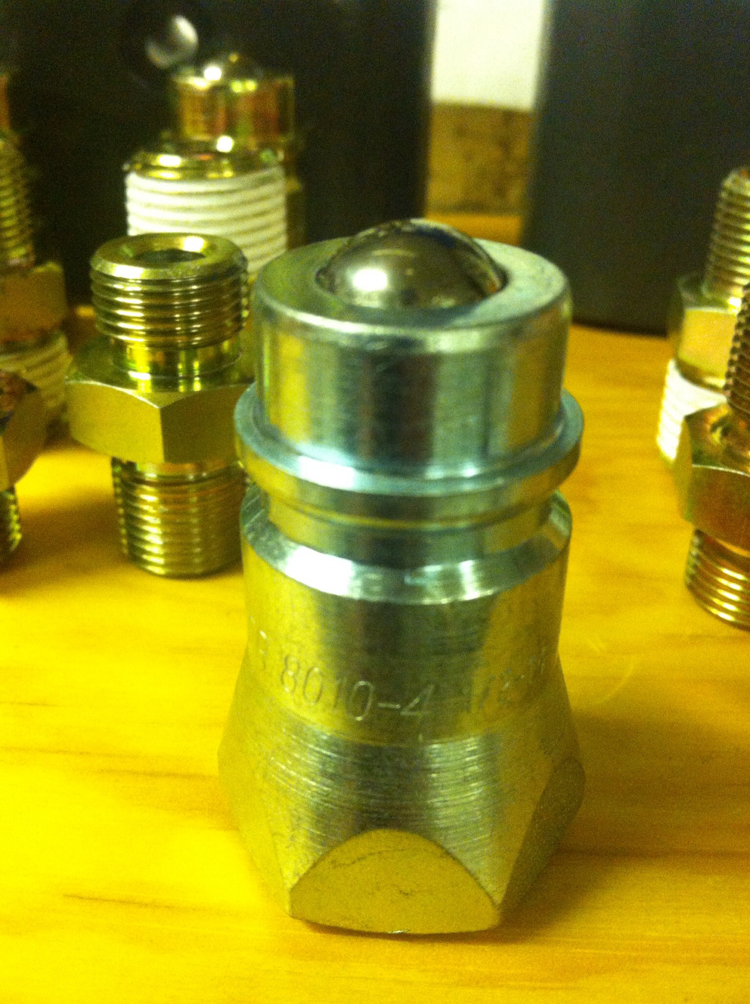

The female push-pull QDs are Parker 9006-001. Unfortunately a version with NPT thread, hence the pre-taped adapters that came with the kits. The rest of the fittings, hose ends and valve body seems to be standard BSP 3/8". The male QDs are Pioneer 8010-4, also with NPT threads which are useless to me, but I can just throw them away.
The interesting part will be to see if a third valve will fit on a cab model, it seems mighty tight in there. Just waiting for a replacement valve top bracket to arrive and I will get to it. Will report if it fits or not.

If adding a third valve section you will also need longer threaded rods that hold the valve sections together and you may get a set of O rings for the section also .

Yes, the longer M8 bolts and O-rings are all included in the L8307 kit. I just took the photo of the hydraulic parts.
Also the lever, lever handle, pins, decals and new M8 bolts for 3 stacked QD "sockets" are included. Might need to make a custom bracket to get the 4th QD set on the side and start a new stack there, not sure if 4 will fit on top of each other, and in any case that would mean using M8 threaded rod cut to the right size.
