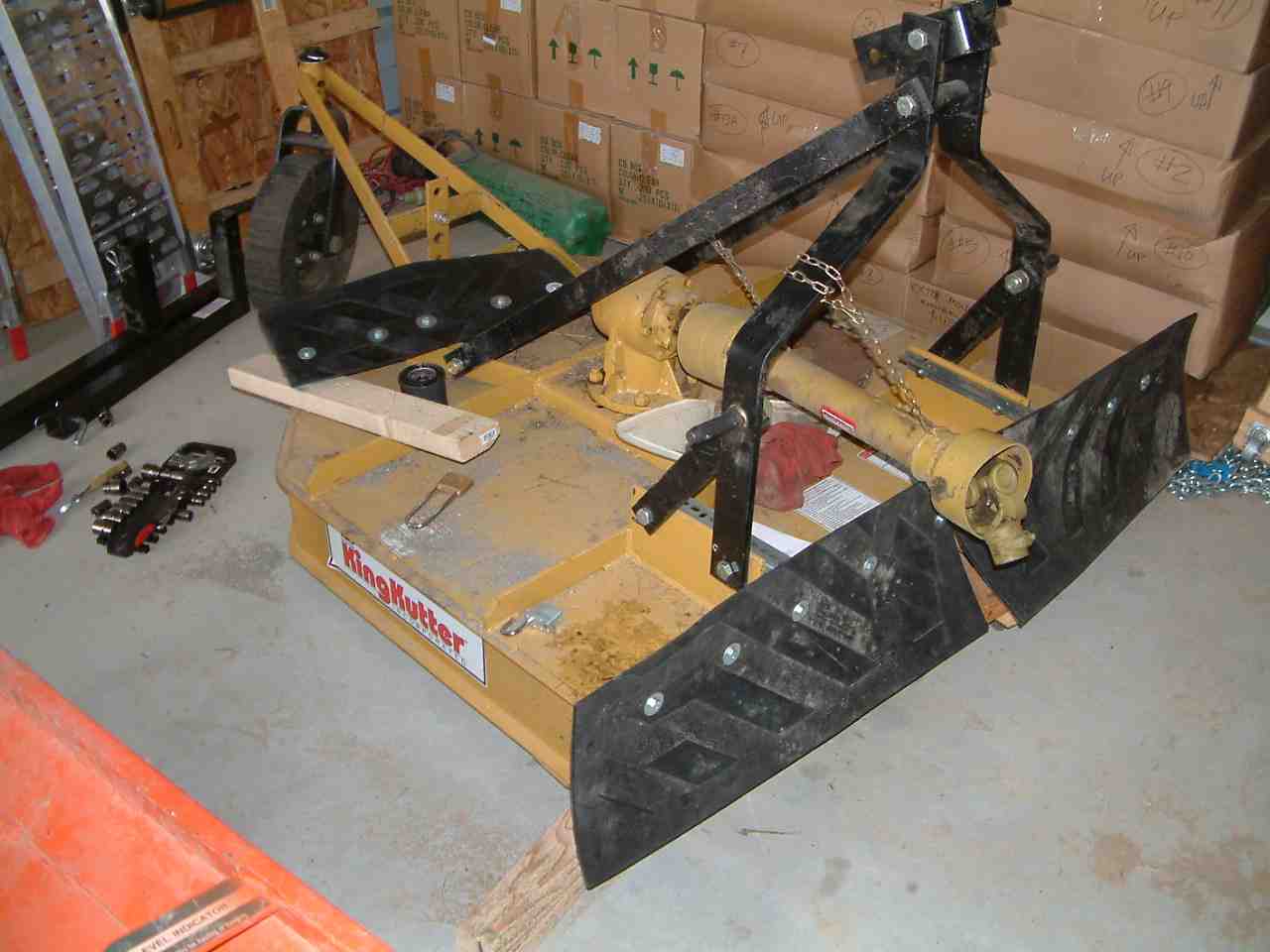

Here're a shot of the rubber debris shields on my KK brush hog (48" wide). Use the mower on my Kubota B7510HST.
Just used lengths of slotted angle from the local hardware store and attached the front shield to the hog via the 3pt hitch bolts. There's a front and a rear shield. The rear shield is attached via the bolts that hold the rear wheel frame to the mower. Got the rubber from the local Petro truck stop trucker's store.
The shields seem to work OK without trapping an excessive amount of clippings under the mower. I generally mow with the rear of the mower about 2" higher than the front.
Basic idea is from Soundguy.
