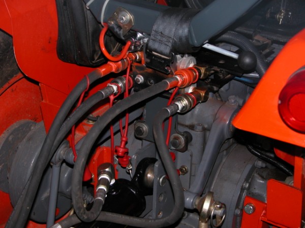

I added a single set of rear remotes to my Lk2554. I assume that they are similar. I bought a kit from my Kioti dealer. They only offer a single set of remotes for my tractor. I then took the two lines that go to the quick disconnects and plumbed them into a dual selector mounted on the vertical ROP support bar behind the seat. This effectively gives me two sets of remotes. If I remember correctly the Kioti kit was about $350 and the dual selector from Surpluscenter.com was about $75 plus fittings and hoses and disconnects.
The Kioti kit is well designed and can be installed in a couple of hours. They only thing that was a problem was the QD's from Kioti. They are not a standard version and I couldn't find a supply of the mating plugs, so I converted all to a standard version.

I took some pictures of the setup I added to my LK2554. I also put in a couple of shots of the chute rotator I put together for my snow blower. I bought the single remote setup from Kioti. (they don't offer a double for my tractor) I piped the outputs that normally go to the Quick Disconnects to a selector valve and added 2 more QDs to give double remotes that I have to choose between with the selector lever. It works out to be a pretty good compromise.
This one is of the selector looking behind the seat where I located it. (seat is flipped up)

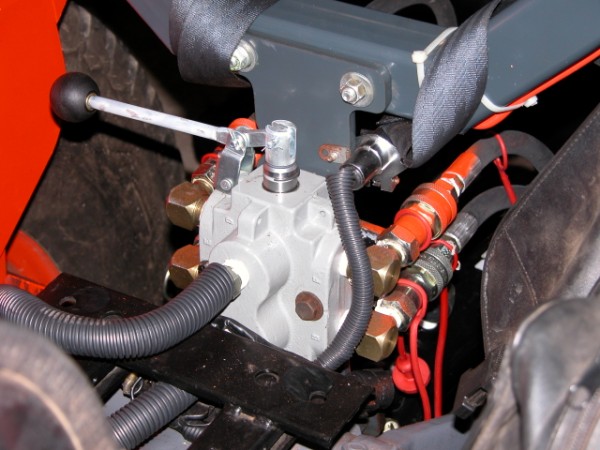

Picture 2 from the back of the tractor showing QDs

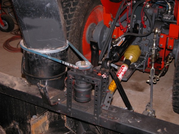

Picture 3 shows snow blower chute rotator
