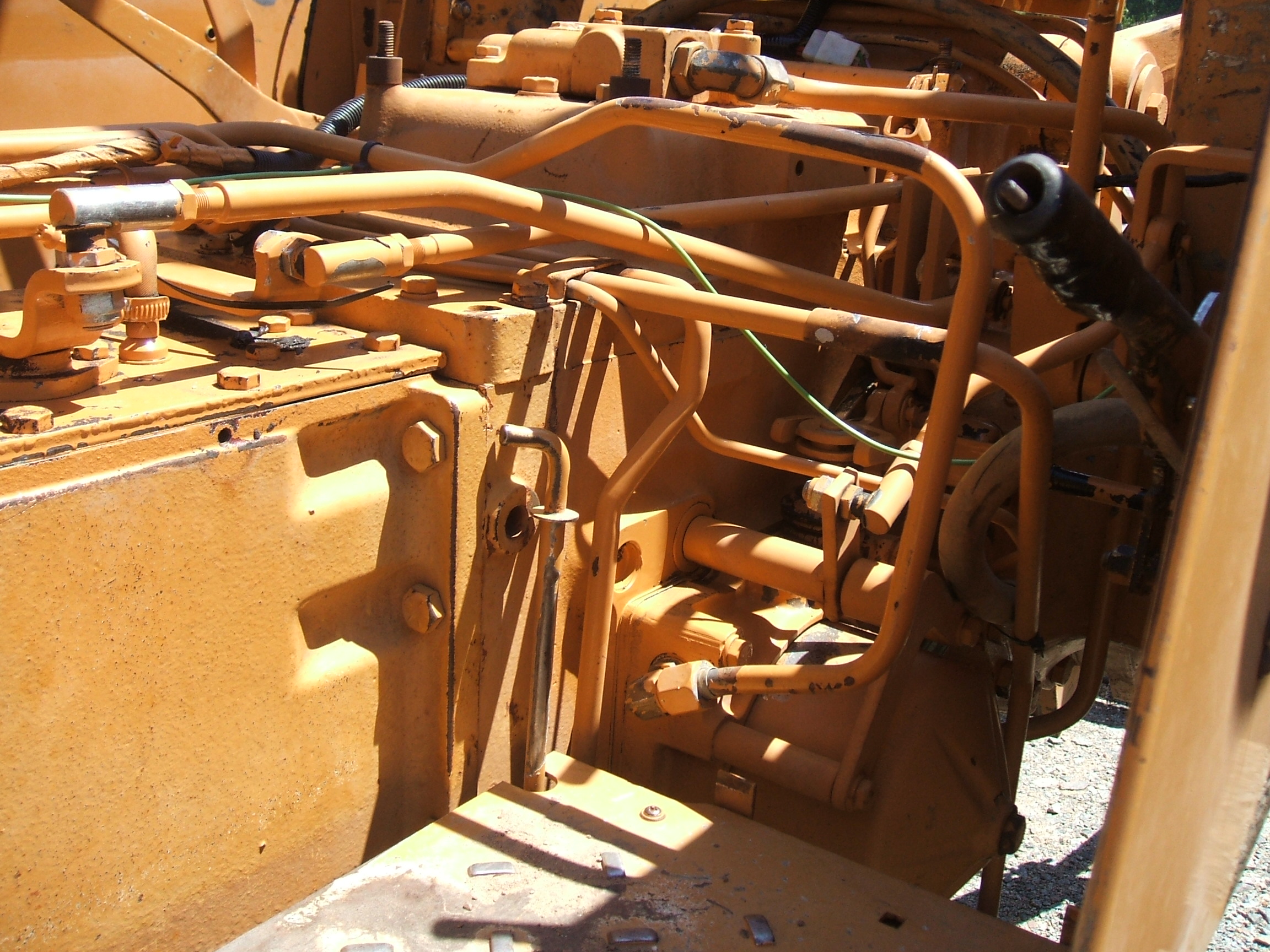

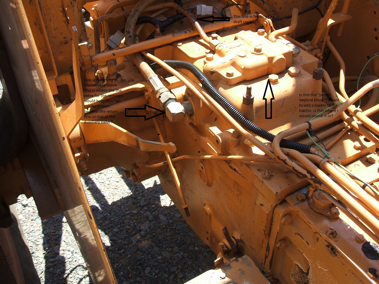

Hello,
I have a 1988 Case 380B and want to add a loader and hydraulic remotes to it. This is Case's utility version of the 495. I have attached a picture of my setup and I am hoping someone can give me some advice. I am also looking for the auxiliary valve and remote set up.
I realize that the loader could run off of the remotes but I would like to "hard" plumb it into the tractor. Do I have a "power beyond" block on top of the trans? One of the lines coming out of it feeds the draft control valve.
Where the large hose threads into the side of the tranny is where the book shows the remote valve bolting onto. The hose is running back to the multicontrol valve. Is there pressure on this hose and they have the pressure just dumping back into the return? Once I bolt the remote valve on, would this hose then become the return for the remotes? Any help would be appreciated. Thanks, Eric

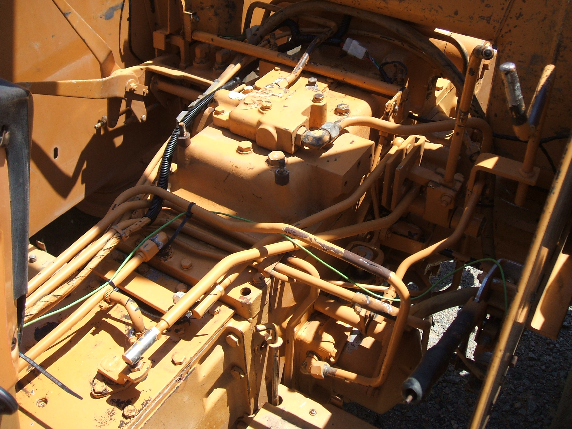

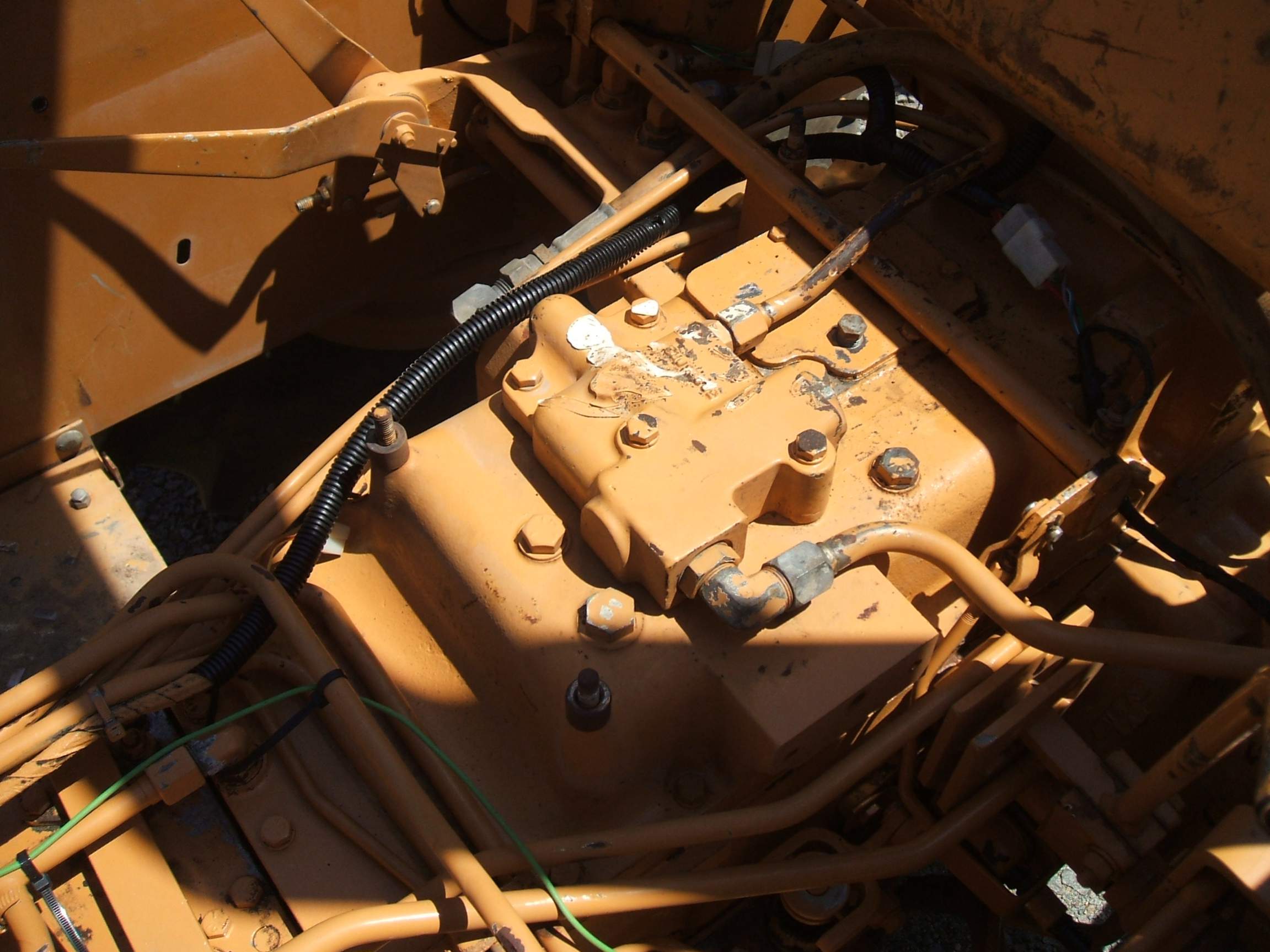

A couple more pictures.

What is the function of the valve in the pic.
If you can determine if the hyd system is an open center hyd system, then you can add a loader valve with PB is series with the other valves.
If it is a closed center, you can add a loader valve in parrallel with the other valves.
