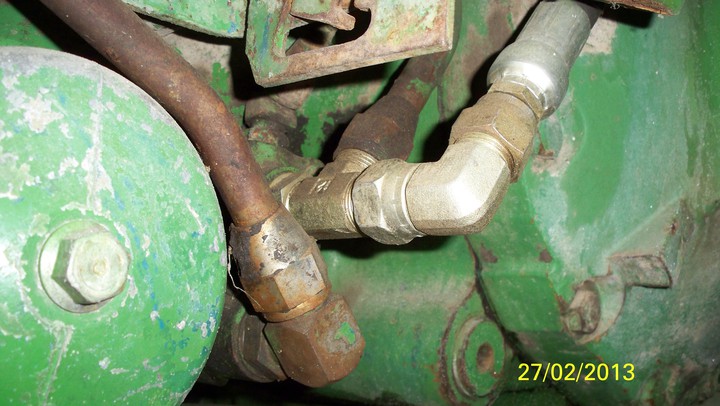

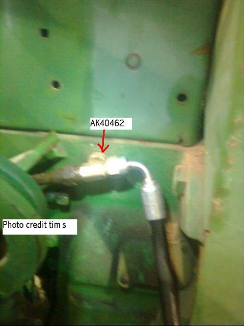

I may need to add remotes to a JD 3010 to run a round baler. On my Ford 4100 I added a loader by just plugging into a set of remotes to feed the loader valve. Would this approach work (feeding another valve by plugging into existing remotes) with the closed center system on a 3010?
Thanks!
   / Adding remotes to a 3010 #2
You could add a spool valve by attaching hoses from tractor to valve similar to photos.
