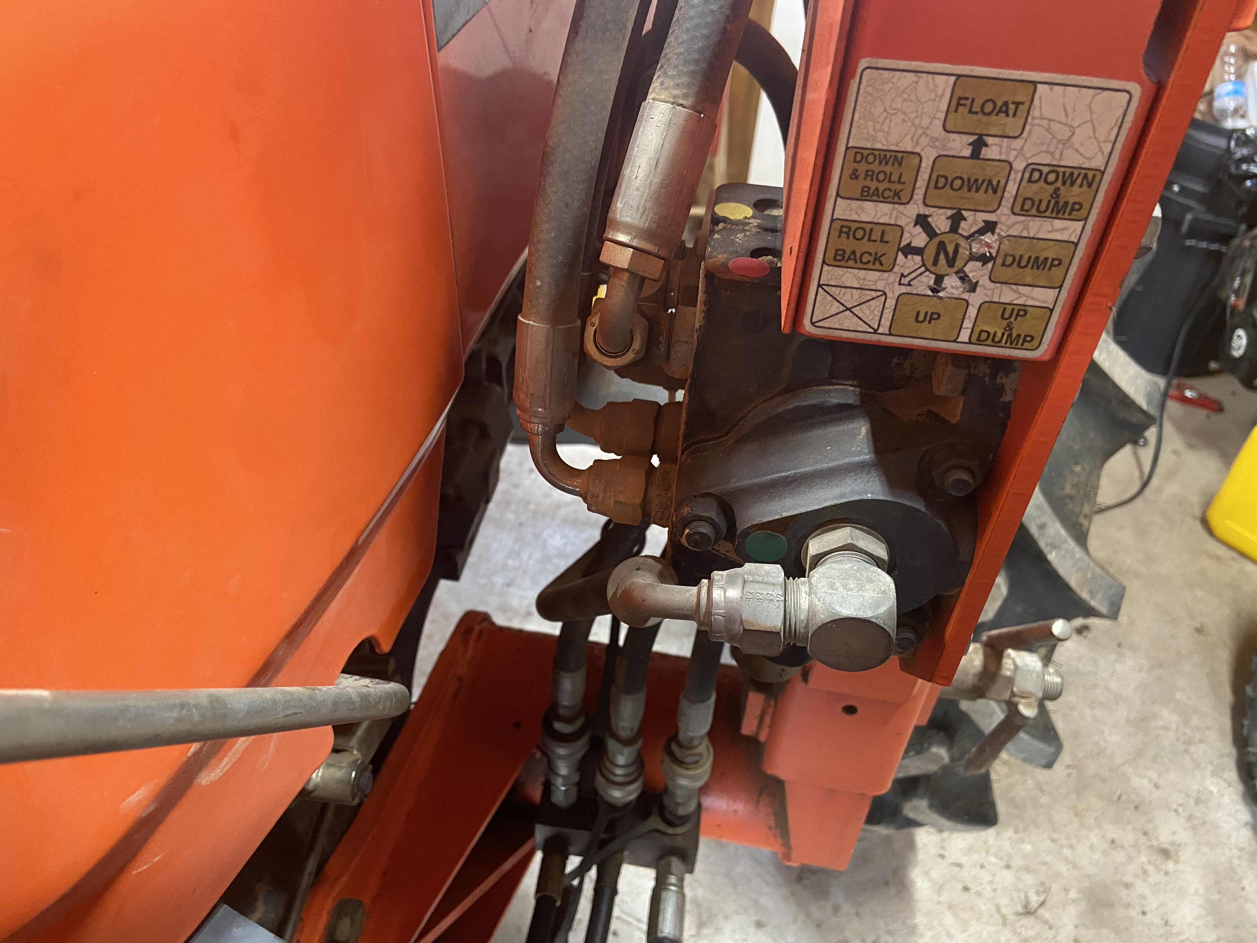

Your system is open center. Do you have six or seven hoses coming off of the loader valve. If seven, one will be for power beyond and should route back to power the 3pt hitch. The valve you source for your remotes would need to be open center and have power beyond sleeve installed.
Your new valve would get power from the power beyond port on your loader. The power beyond on your new valve will power your 3pt hitch. The Tank line from your new valve will tee into the tank line from your loader.

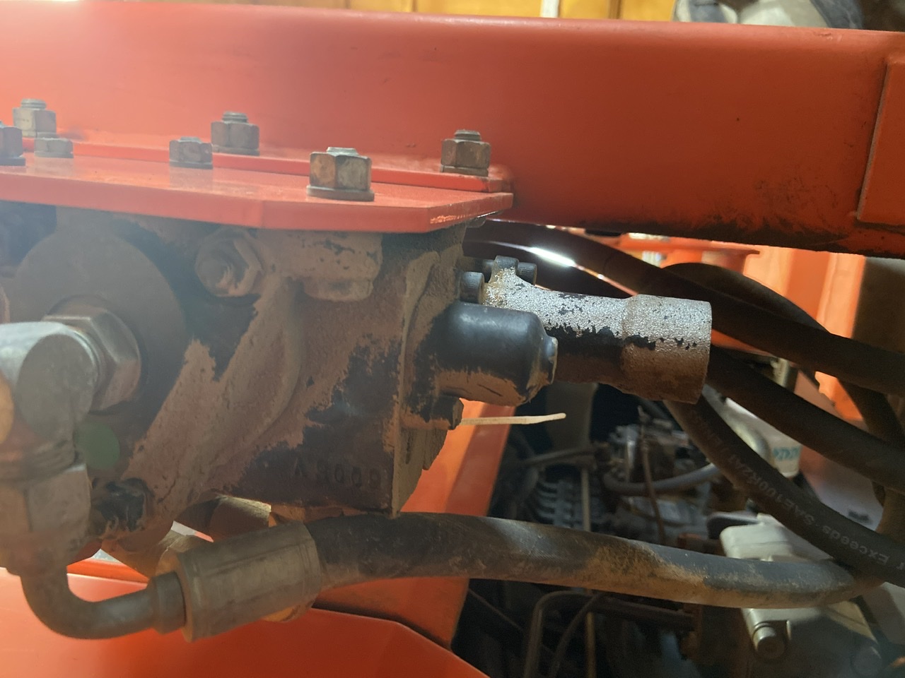

I have seven hoses coming off the loader valve. 6 come off the inside portion and one comes off the front. I致e attached a picture

So, that’s a horrible picture...and it’s sideways for some reason. I’ll try to get a better one in the morning. Thanks for the reply.

One can't successfully Tee into the open-center hyd system on a tractor similar to your M4700. Teeing into OC hyd system allows oil to take the path of least resistance rendering some of the hyd control valves inoperable. Added hyd valves must be attached to open center hyd system in series not parallel.

Sorry for the delay and thank you all for the reply’s. Here is a better picture of my loader valve. I’m assuming the power beyond is the one coming off the front of the valve?670B2383-0164-403B-B2C2-A1C2EFC986BC.jpeg
