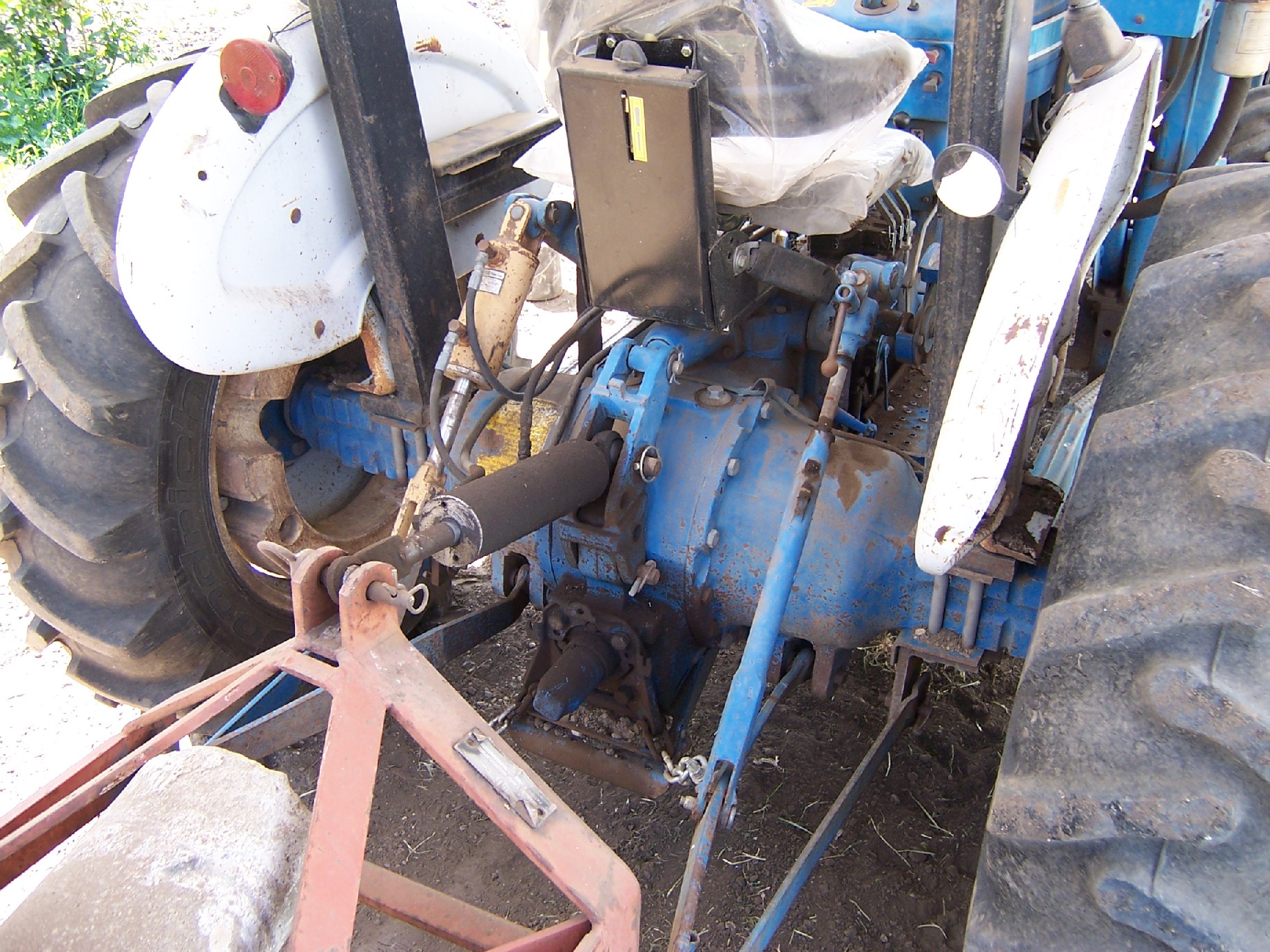

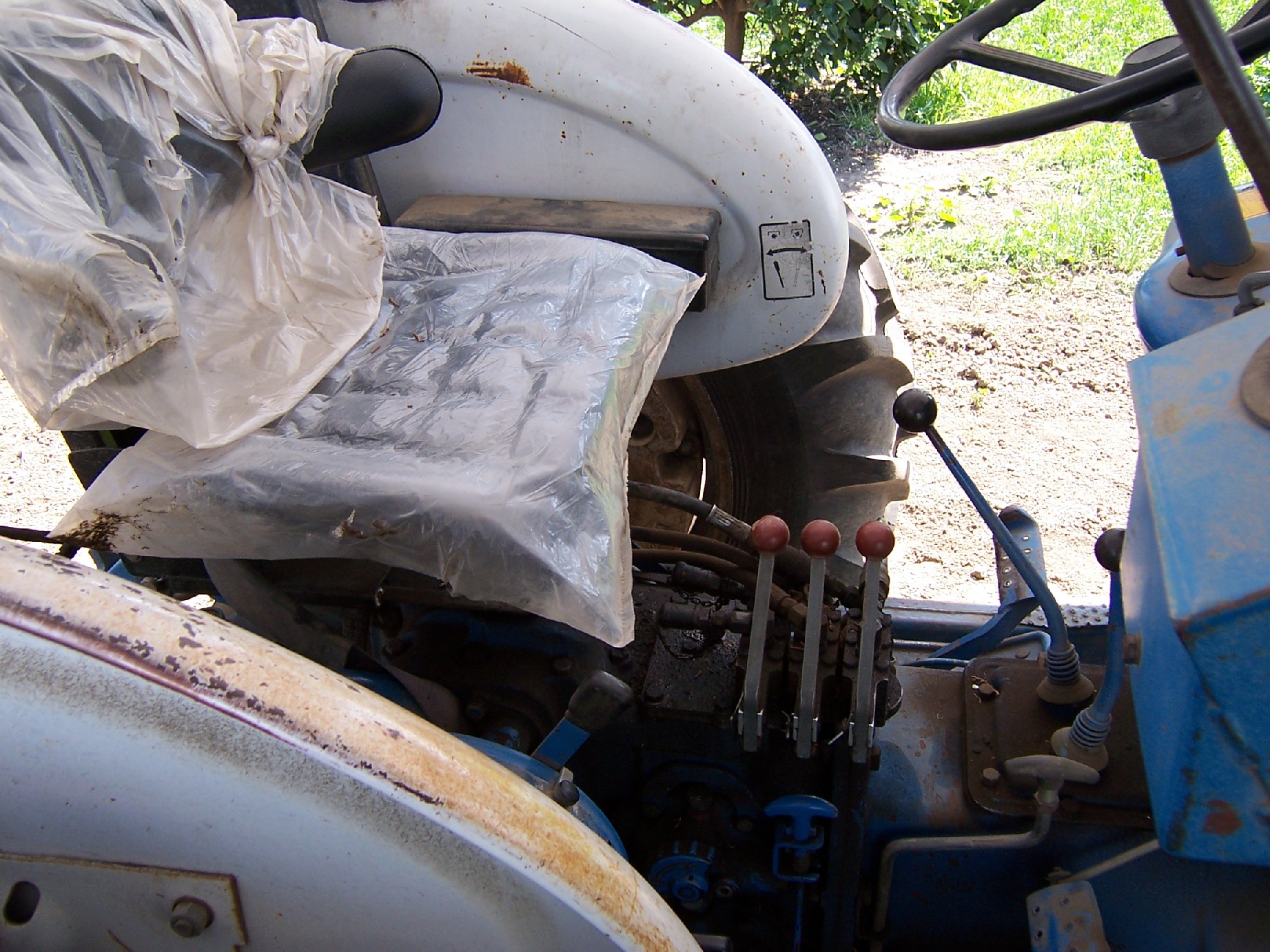

Good day,
Would someone please explain how I can add new hydraulics to my tractor so that I can use my New Holland 2910 with an old 3 pt backhoe attachment.
Presently, I have 3 hydraulic valves that control my 3 pt hitch, but I need two new connections (larger connections) installed so that I can plug in the old ARPS 3 pt. hitch.

I see only 2 spools being used for the 3pt, one for the top link and one for the tilt link. That should leave you with one spool remaining.
If you want to use that spool for a backhoe then you will have to use a bungee cord (or something similar) to hold open the third spool's lever. You will then need to figure out what size and type of connectors you will need. I don't see where the third spool's work ports go to so you will have to see what connections are available and get adaptors to match your backhoe hoses. Discount Hydraulic Hose will have everything you will need.
A few more pictures of where the third spool's connectors go would be helpful.

Jerry, I see the 3pt position control lever in the first picture.

Some of the MF and Fords that had auxiliary hydraulic were plumb so that one of the spools operated the lift , instead of the normal lift handle. That may be the way his is. It depends on the way the spool is made that replaces the hydraulic block-off plate. It is actually the design of the passages in valve instead of the plumbing. I shouldn't have used the word "plumb".
   / Adding New Hydraulics for NH 2910 #6
You have three remote valves. I have the same aftermarket valve stack on my 4000. You are currently ony using two; the third can be used to power the backhoe. Larger couplers are not necessary; 1/2" couplers will handle the flow from your 2910. Additionally I hope the backhoe does not use the tilt cylinder you presently have in place of the toplink. This is a safety concern, the hoe should be rigidly mounted to the toplink bracket on your tractor. Be sure to place the draft control fully in 'position' for backhoe use. This is also a huge safety issue. if you have any questions or concerns about safe attachment or operation of a backhoe attachment, post photos with the questions.
