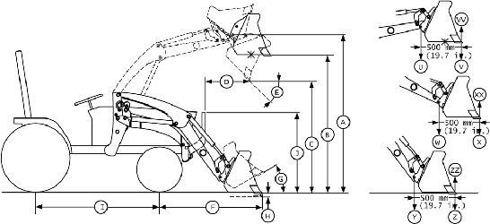

Is there any way to get a little more lift capacity out of the front end loader? I received an order of animal food by truck this weekend. It was at 2,000 lbs per pallet. My Tractor says 1,750 is the max lift. But coming off the back of the Semi. I couldnt get more than 1,550. Are there any ideas? Is the Joystick control valve part o the problem? Or should I be happy with what I got and quit whining? /forums/images/graemlins/confused.gif Note: This is a Compact tractor from Farmtrac. 360 TLB package.

The rating of 1750 lbs could be at the pivot pin, not out on a set of forks. Once you reach out further, your lift capacity drops quickly. Also, lift capacity changes as you go up in height. What you can lift off the ground, you may not be able to lift up at 4' in the air off the truck. Your hyrdaulics will only do so much, what it is designed to do, so I doubt there is a problem there. The system could be checked for flow and pressure if you suspected more of a problem.

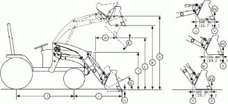

Here is what I mean about lifting specs,,, they assign a different spec for every possible scenario it seems...
In this example, item U has max lift capacity to full height of 1598 lbs, where item V is only 1122 lbs.
Those values change, if only lifted to 59", W is 2125 lbs, and X is 1649 lbs.
So, as you can see, a maximum lift value may be only good for the weight at a certain position on the loader.
(these values are on the new JD 300CX loader!)
