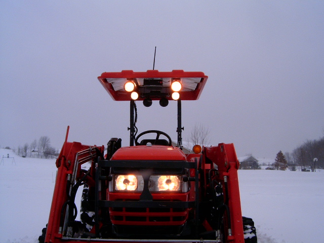

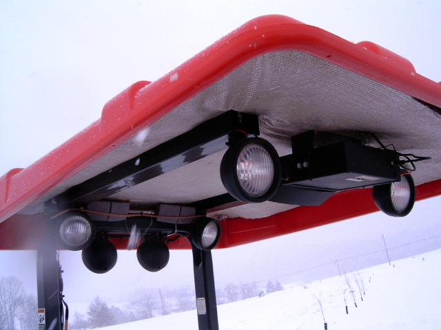

   / Adding Lights to my canopy #7
Does anyone have pictures of canopy's with lights installed ?
I have been running these lights on my canopy for 5 or 6 years now with no problem.
4 facing forward and 2 facing rear.
