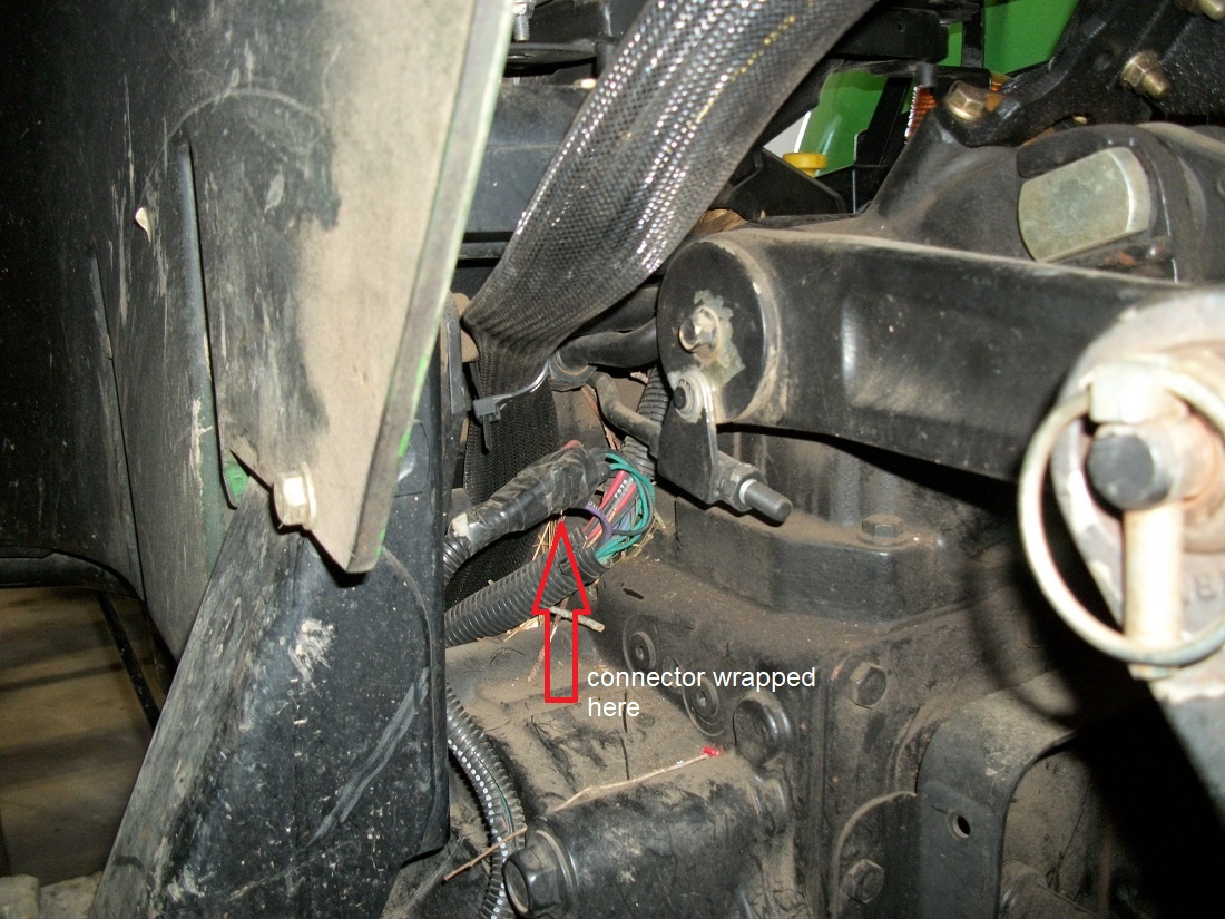

Hello members,
I have a JD 4400 CUT. I would like to add some additional lights and an auxiliary outlet on the rear for a sprayer. Where can I find a hot lead powered by the ignition switch. I would add and auxiliary fuse box powered though a fuse by a relay that would be powered by the switched hot lead. Can anyone point me in the right direction? Any suggestions would be appreciated.

Likely you will find it to the left side at the rear of the seat (base of the ROPS). That is where I found it on my 4300. Wires folded over the connector, and I think strapped.
Is hot when the tractor light switch is in the full clockwise position (work lights).
   / Adding Lights to my 4400 CUT #4
Pic of mine wrapped up with black tape.

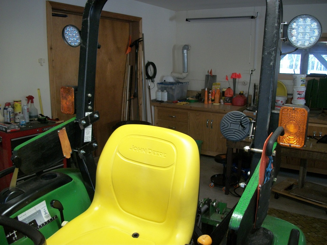

I've added three LED work lights to my ROPS and have some great lighting for night time work.
This first snow plow run video shows the difference early in the video (0:50) when I switched them off to just the front lights that are hiding behind the mesh guard.
Snowplowing Jan 14 - YouTube
Lights fit nicely on the ROPS, 2 facing forward and one to the rear. No problem with the load so far.

Looks great. Your lights appear small enough to not cause you an issue. I have an LED bar that supposedly uses a lot of juice I haven’t measured it but reduced the fuse down from 15 to 10 and haven’t popped it yet. Seems to be a margin of error for the manufacturer.
