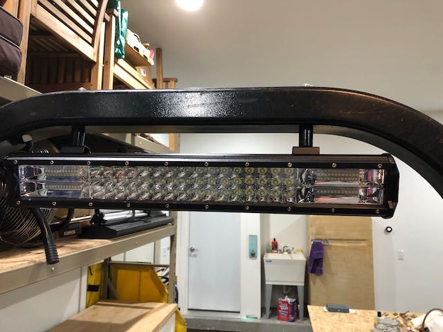

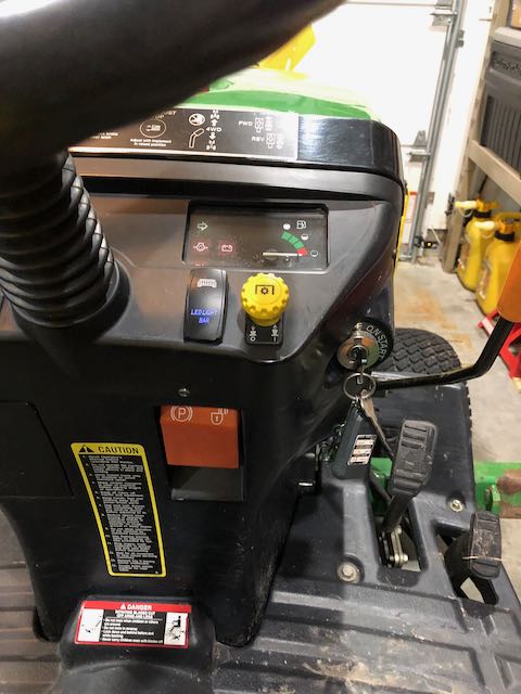

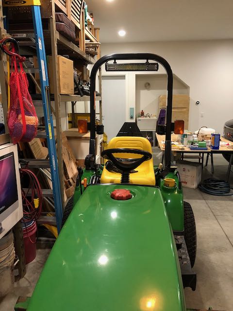

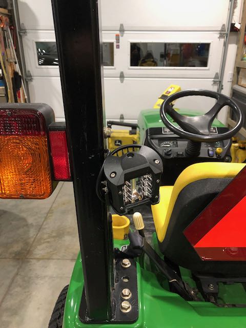

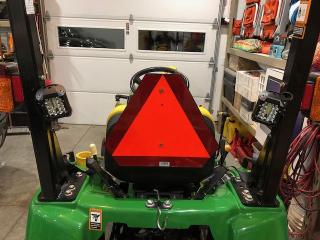

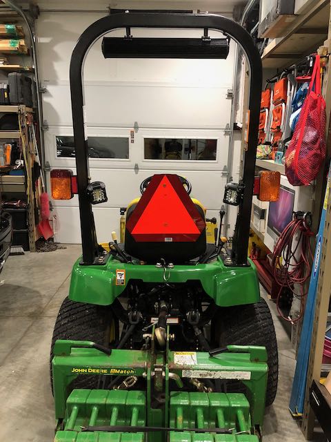

I just did this exact light setup on my JD 2210. 20” under the tops facing forward and two 4” cubes on each side facing back. I used the switch that came with them and put it in the dash. I saw the trailer wire but wanted the full range of lights in addition to the work lights. I wired the relay that case with the lights directly to the battery.

Here are the pics:
Here is what I bought. Not sure of the Amp Draw.
20" LED Light Bar AUSI 288W Triple Row LED Bar Offroad Driving Lights+2Pcs 4" 60W LED Cube Pods Fog Lights With Rocker Switch Wiring Harness for Jeep Trucks Polaris ATV UTV Ford Boat,1 Year Warranty
by AUSI TECHNOLOGY
Learn more: https://www.amazon.com/dp/B07QS7ZR9Y/ref=cm_sw_em_r_mt_dp_U_JAadEbKR0V5E3
