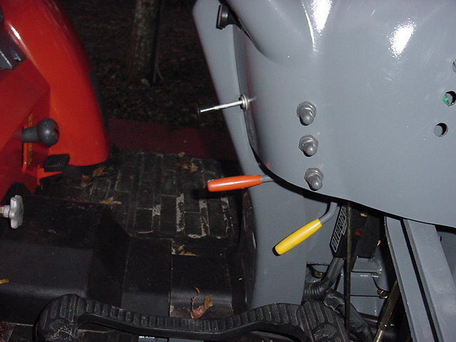

   / Adding lights to CK20 #4
That should be plenty of light. My only concern with that type of a switch is moisture getting into the switches contacts unless that has already been addressed.
I used toggles with the rubber boots

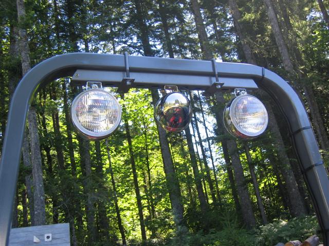

   / Adding lights to CK20 #5
my light bar made with electrical mounting channel and u bolts made at a spring shop --- you may want a bug whacker mounted up there too to kill the bugs attracted at night to the light.
Be sure to run a dedicated ground because ROPS flops and is a poor ground...
Maybe I'll have the switch mounted by next spring---who knows, a water resistant one seems a wise choice.

Tractorlegend, Nice photo. That is a real nice looking light mount set up. Using the piece under the ROPS to mount the lights was a great idea. If I add lights to my CK20 I might try to do it in a way similar to your set up. Right now I can drive into my garage with the ROPS up, with about one and a half inches of clearance. Your style set up basically causes no change in clearance.
Charlie
