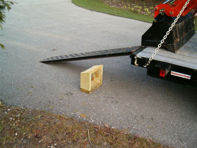

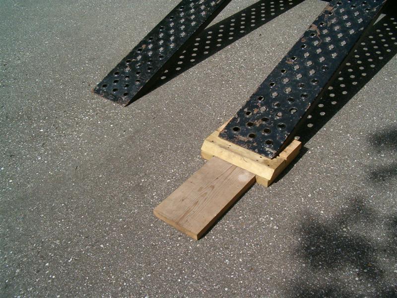

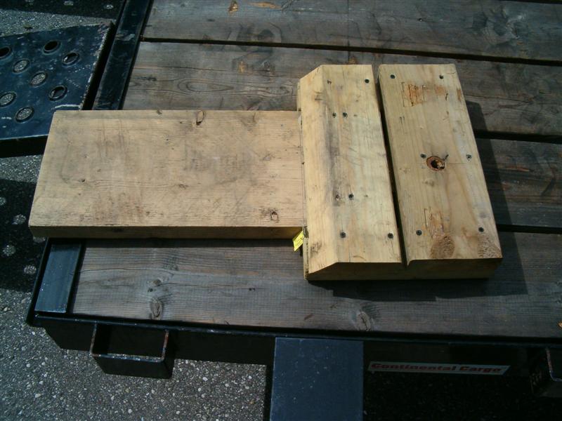

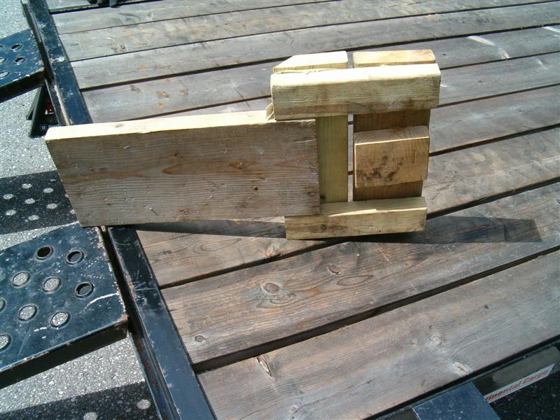

Do you really have to add length? Try this first. I jacked up the bottom of my ramp by making a plate of 2x10's designed to raise the tires up 3" before loading the ramp. The modification worked perfect for me.
rimshot

For just 18" extension, go with Rimshot's idea.

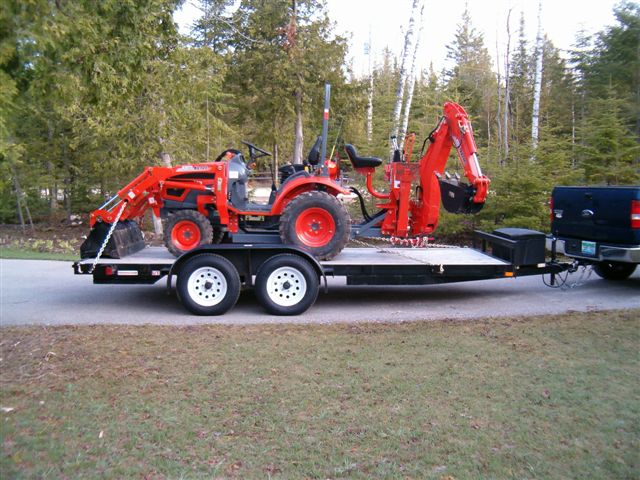

My trailer is a 16' car trailer. The first time I loaded my tractor those car ramps really bowed. I believe if I was to load a car aboard the trailer the front wheels would be safely aboard the trailer deck before the ramp got the weight of the back axle. With my CC-20 fitted with FEL and backhoe both axles are on the ramp and at 4000 lbs rolling up that ramp was tooo much so far as I was concerned nnot to mention to steep and the bottom of the backhoe boom was dragging too much.
In addition to the fact I had to fashion the ground plate for the base of the ramp, I felt I had better chok the center as well. this is the simple chok I came up with and it stiff legs the center of the ramp perfectly by allowing the ramp to only deflect slightly. I found that if I just placed it ahead a very slight bit the ramp was then allowed to deflect just a bit making the bottom and trailer hook grab much better. Placed tightly and the ramp wants to teeter off. Youi need some deflection for this not too happen.
I always place jackstands at each rear corner. Use parking brakes and park on th towing truck and lock trailer hitch when trailer is mounted.
A longer ramp would have definitely folded for me.
rimshot
