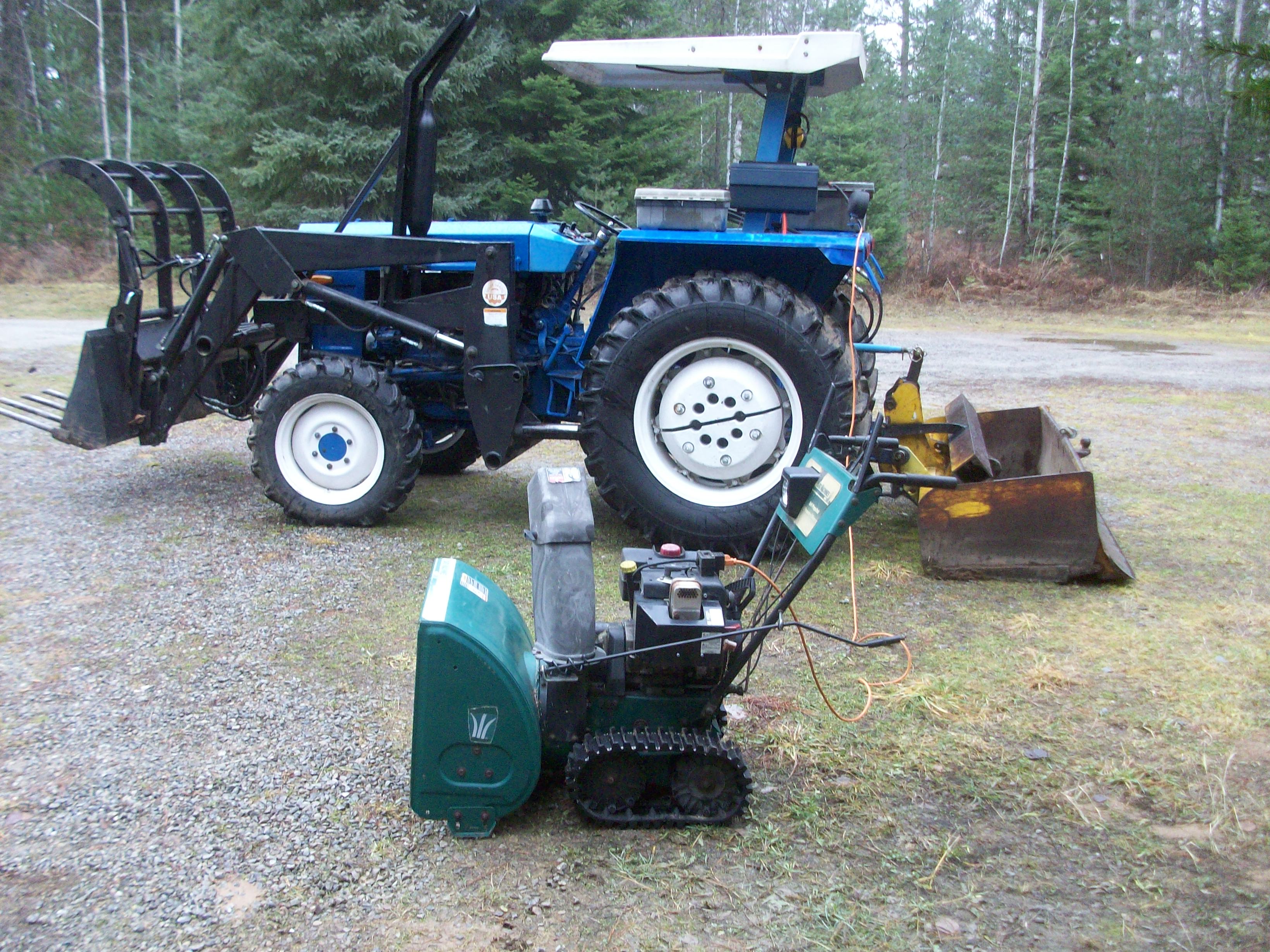

Several members have ,
use mine for an electric 3/4 hp pole saw, drills and such.
picture was for a member who wanted to use the 120 vac starter on a front mounted snow blower, and needed to know if an inverter would work.
tested the idea with my 2000/4000 watt surge HF inverter and it worked fine.
Also used the tractor/ inverter to keep the fridge , lights and satellite TV on during a couple power outages before we got a good sized generator.
My tractor only has a 37 amp alternator- but has dual 12 volt batteries in parallel so it works ok for short term high inverter loads.
If the charging system ever gives a problem, a decent output delco 10si will be in its future.
ps I put a switch between the inverter and batteries.
IIRC the inverter has large electrolytic capacitors that are (in circuit) when the cables get connected, did not want a slow drain on the tractors system.
