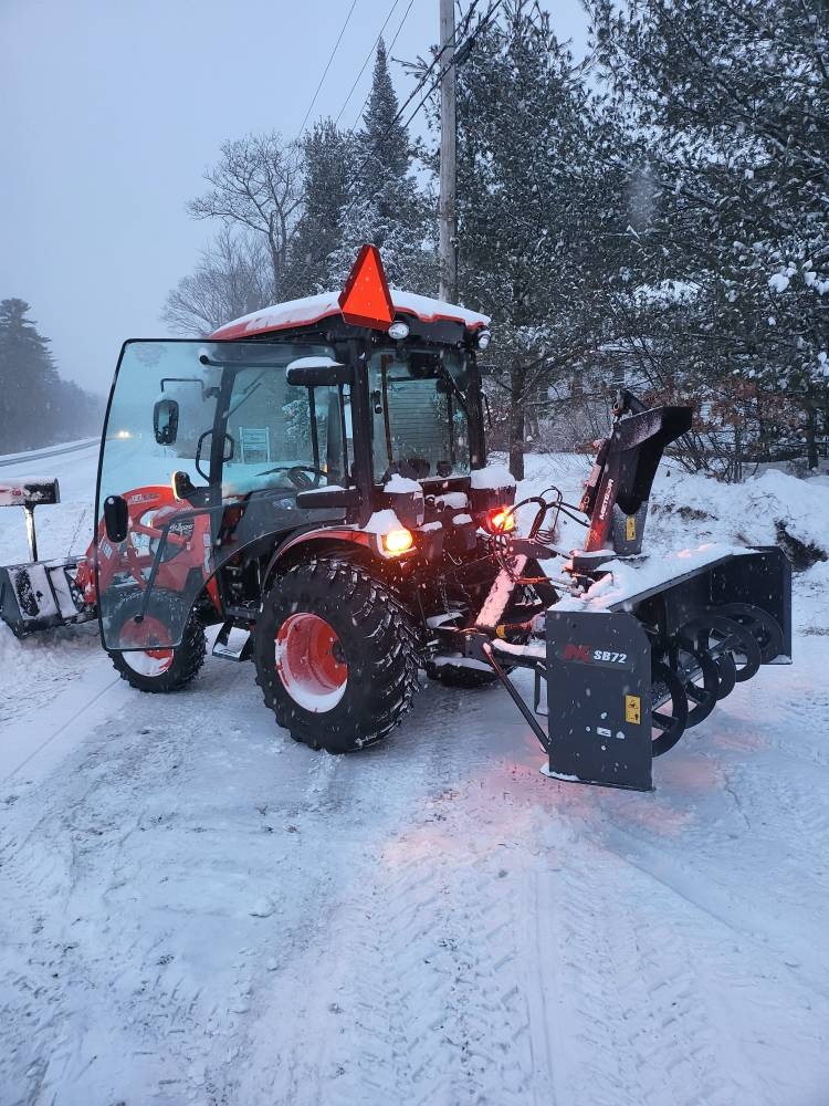

Has anyone ever installed an intermittent wiper control on Kioti cab tractor? It is my biggest complaint on this tractor. I hardly ever need the wipers on full go. It is usually misting out or snowing out and all I need is a wipe every few seconds or so.
