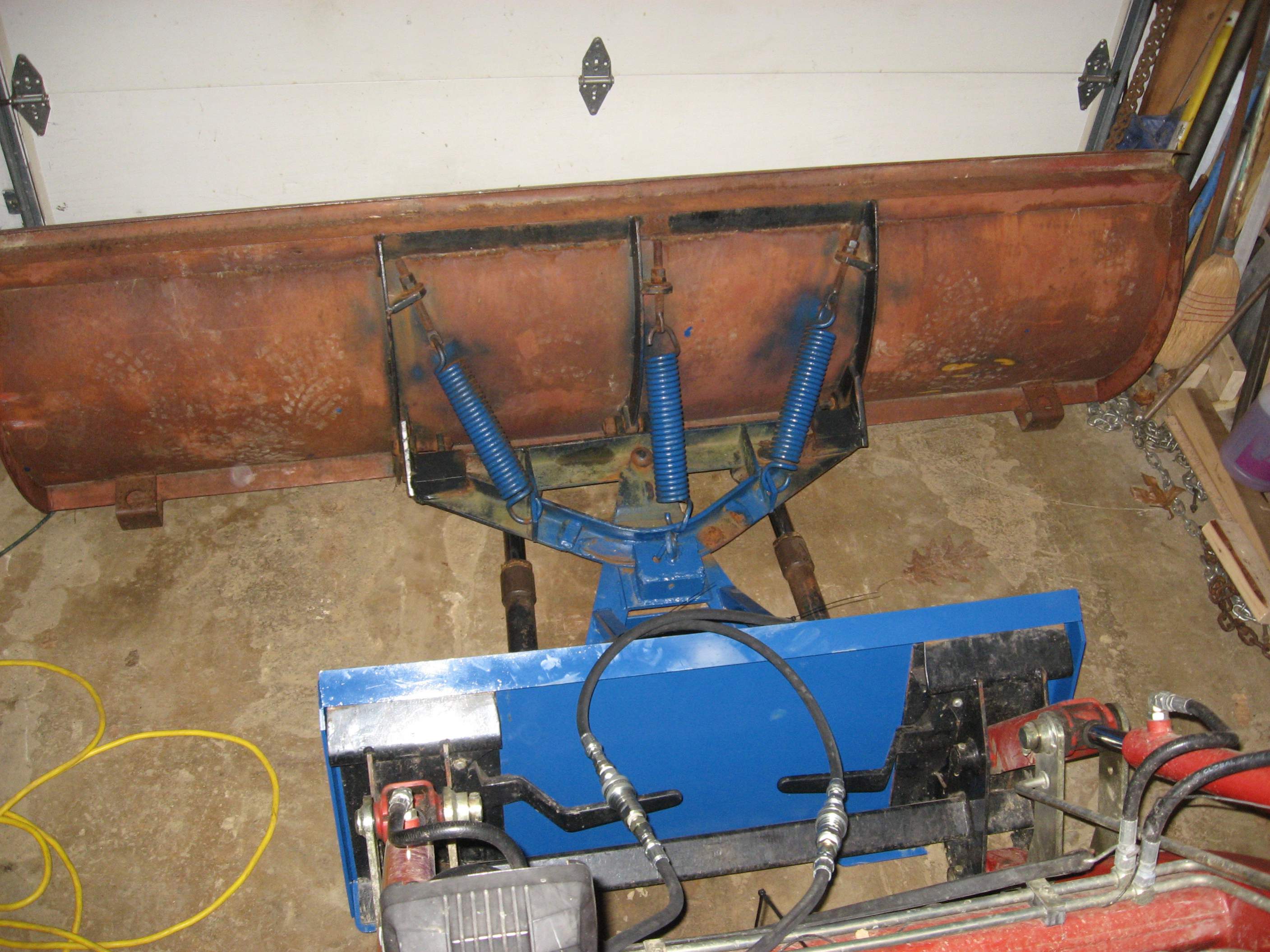

I've actually got a snow blade on my loader that I've hooked up using the rear remotes on my tractor. Works great. As far as disconnecting the grapple lines, I thought of that issue when doing the power angle on my snow blade. A set of quick disconnects make short work of it. Two sets of these in 1/2 (should be the same at the remotes in the rear) will do it.
ISO 5675 Agricultural Hydraulic Quick Disconnects
I wanted to be able to quickly go back and forth between my snow blade and the bucket. Pull the levers on the QA, disconnect the hydraulic quick connects. Done.
You can see the disconnects towards the bottom of the picture.
Pardon the blue color and lack of paint on the blade. Blade was free (with cylinders) from a friend. Used a skidsteer QR plate to adapt it to my tractor. The blue paint is 2 cans I've had laying around for 8 years. I figured I'd use that to cover it up for the time being as this is a work in progress. It'll get finished and a good coat of paint once it's refined and she'll look pretty for next year.
