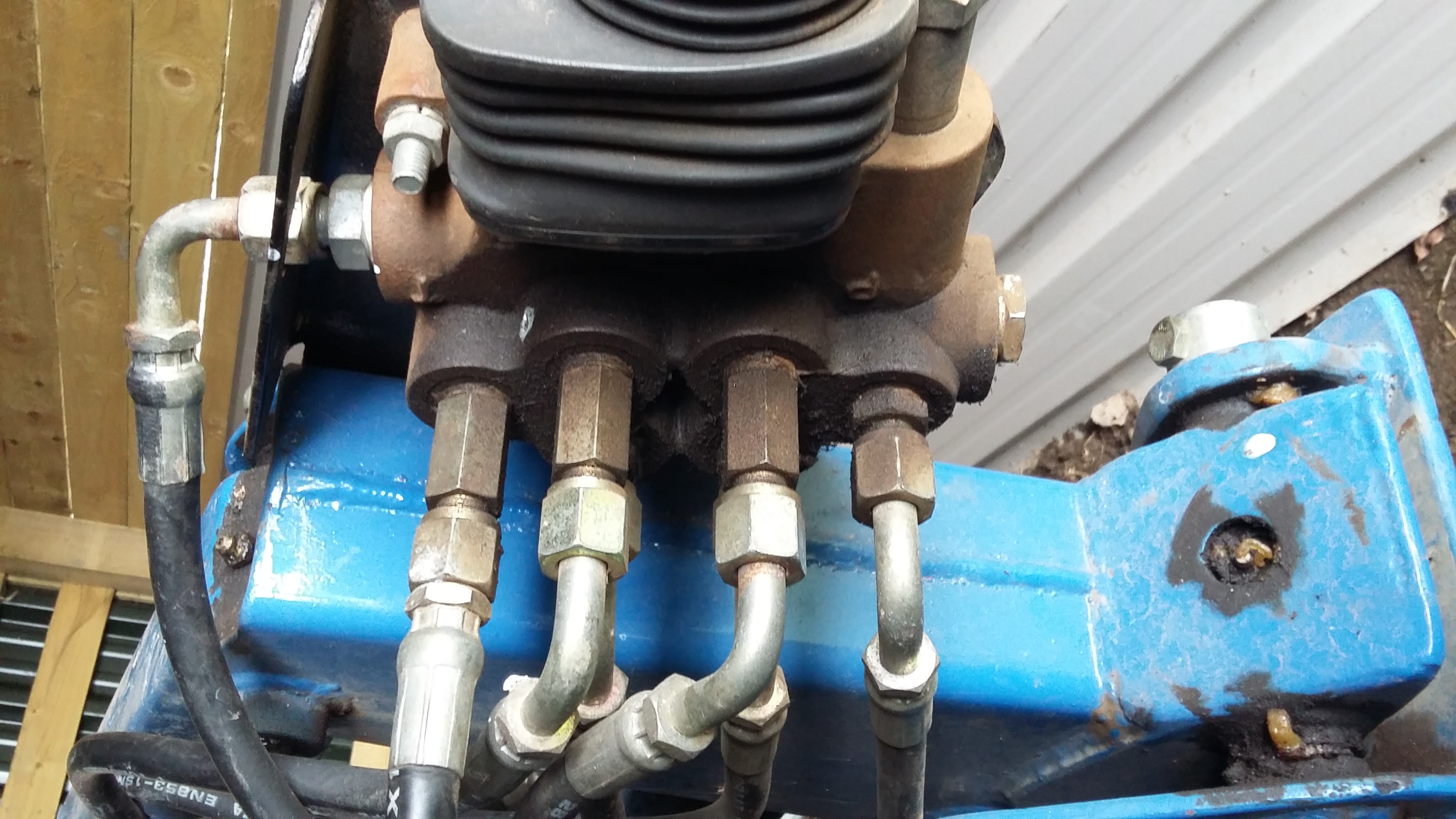

Is the loader a factory when new with a new tractor or an aftermarket add on?
I assume you have a working 3 pt hitch.....
Where does the 3 pt hitch get its hydraulic supply.
Does your existing FEL valve have 6 or 7 hoses?

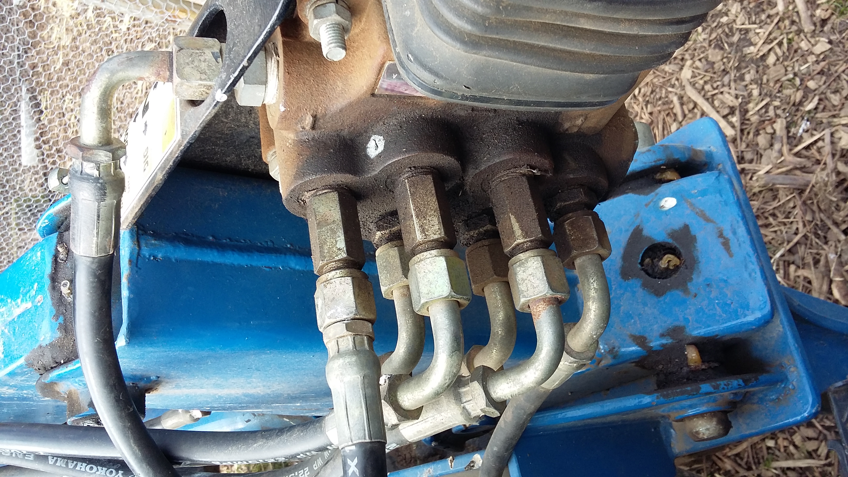

The key here is does your FEL have have provision for a power beyond sleeve or plug.
Look at the details on this link which will help you understand power beyond's physical parts
http://www.princehyd.com/Portals/0/valves/LvtInstS.pdf
When you answer the # of FEL hoses, it will confirm a lot. An aftermarket FEL will likely have 6 hoses. A supply, a return to the reservoir and 4 for the lift arms and bucket,
With the power beyond feature, you now have 7 hoses. The extra hose ( the power beyond hose) is used to feed another new control valve on the rear of your tractor.
This control valve can have one or two independent circuits for two rear remotes.
A suggestion, buy a new FEL valve which has the power beyond feature. Use the existing FEL valve to control two rear remotes.
But do this only after we fully understand your tractor's hydraulics.
Make sense?

Dave my apologies I have just checked and there are in fact 7 hoses attached to the fel control which appears to be a 'Dakon' on the control there is a T and a P which looks like they go to the Tank and Pump respectively (which is logical)theres also a pipe which starts off as a flexible pipe then becomes a steel? one that I think goes to 'power' the 3ph. There is also a 'plug' in the bottom of the unit so I don't know what that is for or could be for
