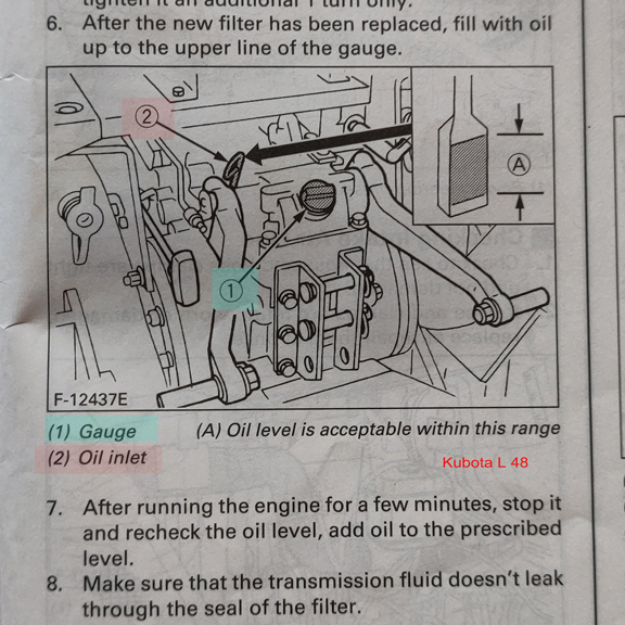

Please forgive my ignorance but can someone tell me where to add Hydraulic Oil to a L48. A local dealer says the dipstick hole and I'm having reservations about that advice. I've included a picture from the manual that shows the oil "INLET" as the dipstick and the "OIL CAP" as a Gauge?.........

HYD oil goes in the capped hole then check level with dipstick.......
   / Adding Hydraulic Oil to a L48 #3
That is the correct place to add hydraulic oil.........................
   / Adding Hydraulic Oil to a L48 #4
You need tractor fluid not plain hydraulic fluid. Tractor fluid has additives that work with wet brakes and clutches. On a modern machine you want "premium" tractor fluid not 303.
Being a Kubota it may have more specific requirements, like for their synthetic stuff.
