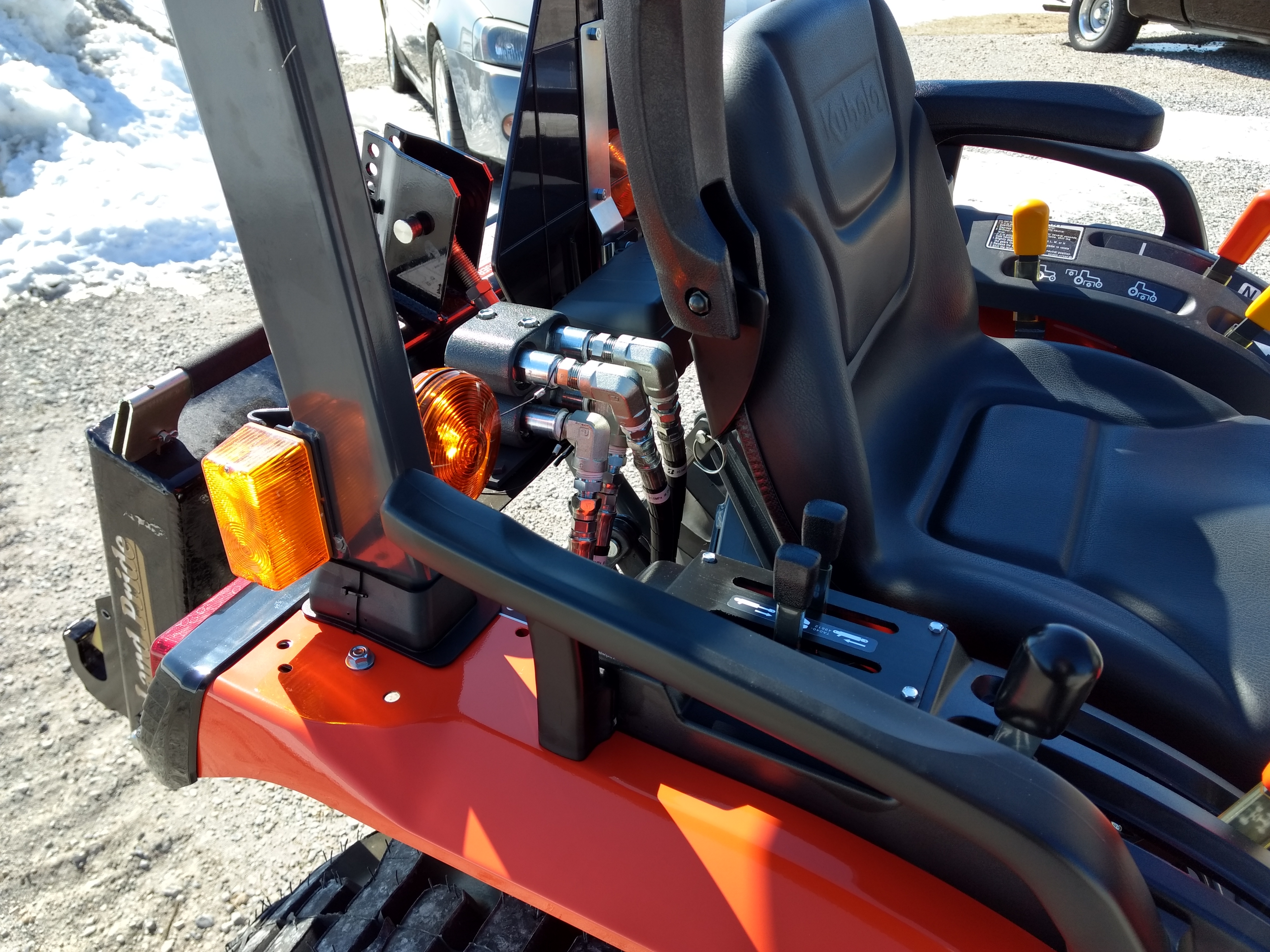

I have a 2015 B2650HSD, front loader, 3 pt on rear, that I am planning on adding extra Hydraulics too. A few questions - do the kits from Landpride and Kubota come with any instructions? I am planning a third function on the front and dual Hyd in the back -- Messicks says this is possible with the following...
Kit #痴 & pricing below.
B7309C 1st Position Valve Kit - $ 815(Will be an additional part that will be needed if you get the 3rd Function installed)
BL7343 2nd Position Kit 60
Then your choice of valve to go with the 2nd Position Lever
BL7373 3 Position Detent Valve - $ 315
BL7393 Float Detent valve - $ 345
Third Function Valve Kit from Land Pride 380-168A - $ 792.85
Any insight and advice is appreciated. Thank you
matt
   / Adding Extra Hydraulics B2650 #2
Yes they come with instructions and you could get help here on TBN or search the web for some videos.....
   / Adding Extra Hydraulics B2650 #3
When I added rear hydraulics I bought 3 stack valves from surplus center. I had a local hydraulic shop make up the hoses. It was a lot cheaper and I liked the valve mounting and location that I came up with better than the Kubota kit. Depends how comfortable you are doing some of the work yourself.
   / Adding Extra Hydraulics B2650 #4
The Kubota 3rd function comes with installation manual and operation sticker. Was going to install myself but got busy and dealer offered a great winter rate of $100 to install. Also got rear ballast on one tractor while there. You have to supply the QDs of your choice.
   / Adding Extra Hydraulics B2650 #5
I initially installed the remote hydraulic kit that Kubota offered that mounted on the ROPS, that just wasn't acceptable. I looked up the kit for a cab model B2650 and installed that with few modifications to the B2650. Phone pics 040 (2).jpg
