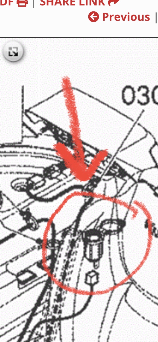

I have a 3560LE on order and would like to add the lighter that is missing (from what I understand the wiring harness is there).
Has anyone done this? I looked at the Messicks online parts diagram for the regular 3560 and it shows the lighter but no part number for it.

Here is the part number RC418-53450
   / Adding cigarette lighter to 3560LE #4
Aren’t the wires under the left fender. You might have to free the connectors from a wire harness.
   / Adding cigarette lighter to 3560LE #6
You are probably thinking of the other spare 12v plug on most Kubotas on the left. I'm pretty sure the 3560le is only a cabbed machine & on the cabled Grands the cigarette lighter outlet is on the right.

https://www.tractorbynet.com/forums/customization/323625-accessory-plug-kubota.html talks about that plug under the left fender. Later in the thread I posted a link to the connector used. No splicing required. I'm perfectly capable of splicing into an OEM harness as well, but prefer to not & use OEM connectors as well. I hard wired a USB port into mine when I put in overkill wiring.
https://www.tractorbynet.com/forums/customization/376458-let-there-light-l4060-light.html
On the cabbed Grands the "under the left fender" plug is in the cab behind the pillar over the left fender. To remove the pins holding the trim on just push the center of the in in a few mm. Easy to see how they work when they are out, but not so much if you haven't pulled them before.
