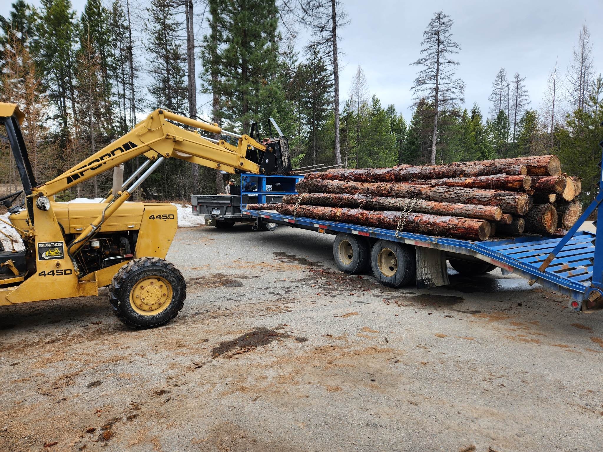

I have a 1996 Ford NH 445D 4x4 skip loader. I bought it as a project with the flywheel bolts broken, so I have gotten to know my way around the machine a bit getting it fixed up and running right, along with other repairs. I have added a quick attach conversion plate to the front end and converted the bucket. I would like to run 2-way hydraulics up there too so I can run powered attachments using the 26gpm loader hydraulic circuit. Ideally controlled with a 2-way switch with detents on the loader knob. I can figure out the hydraulic lines, fittings, and routing, but I am a little in the dark on where to start with a valve block and switching. Anyone have any experience to share? Here's a pic of the machine since everyone likes pictures.

Great tractor and great modifications. The easiest thing to do is add an electric diverter valve to the bucket circuit. Tie in at the loader valve hoses. Check out Summit Hydraulics for their 30 GPM kit: Hydraulic Multiplier Selector Diverter Valve w/ Switch, 30 GPM

Thank you for the hydraulic parts suggestion. This is a lead that will get me going in the right direction, but that specific part won't quite do it for me. I need to be able to use the raise/lower, curl, and 3rd/aux circuit all independently and/or simultaneously.
