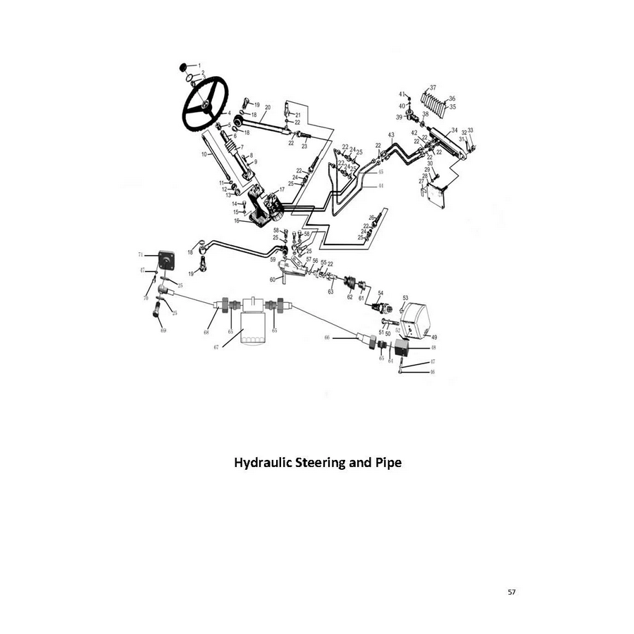

   / Adding an extra valve to my Jinma FEL
I do not have rear remotes on this tractor. Wish I did.
The steering does shut down if I try and use the FEL, so I would assume it has a power beyond port sleeve installed, but the picture I see of it with it installed, does not look like what I have. I think. Is the power beyond sleeve internal? By the picture for a replacement valve, it looks as if it sticks up above the valve body.
Rick
   / Adding an extra valve to my Jinma FEL #9
If your valve has a sleeve installed it will have three lines connecting it to the tractor systems. If it has only two, then power beyond is not in play.
