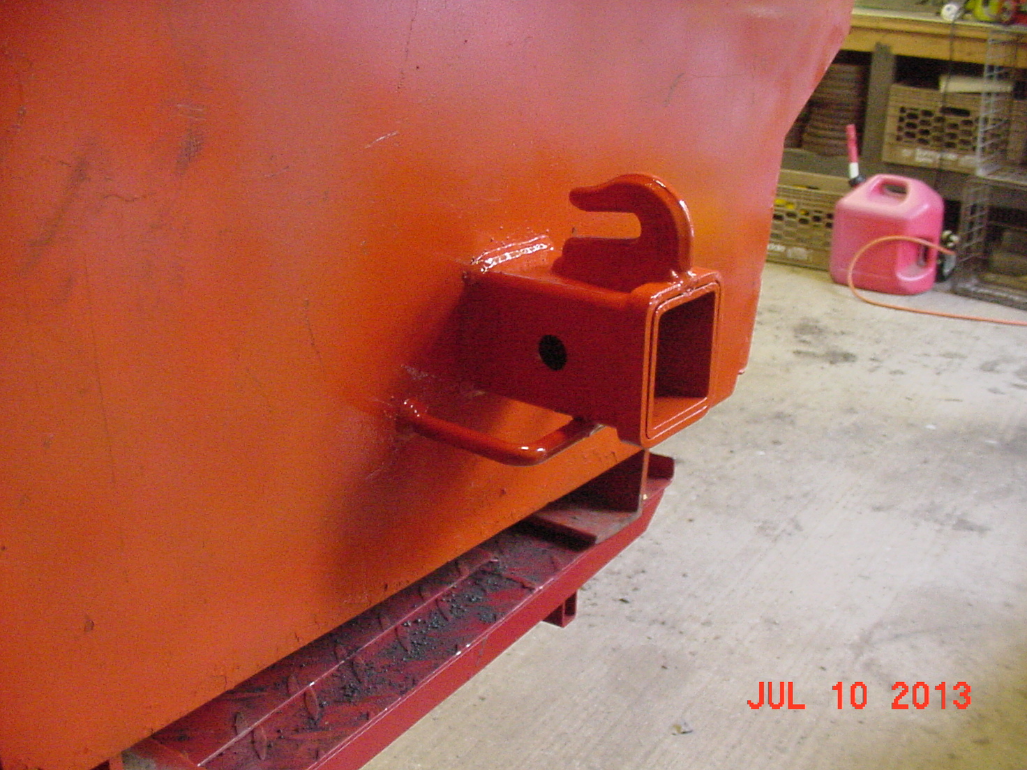

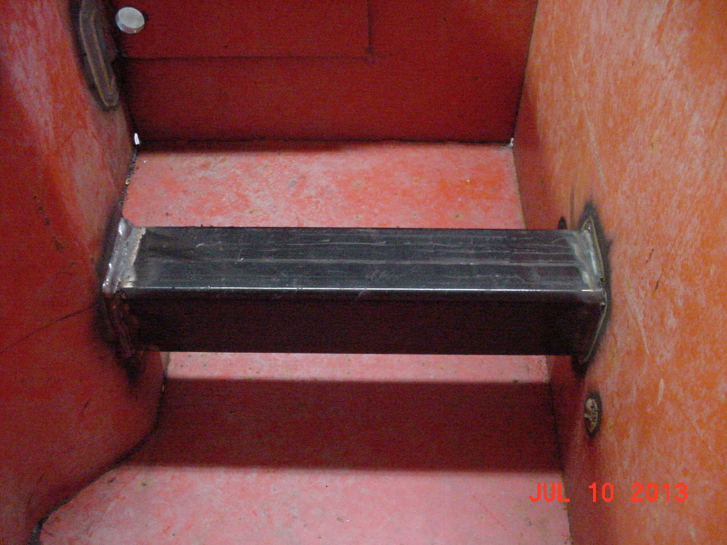

I added a receiver through the ballast box. Works good for moving trailers around. Also added a grab hook for good measure.

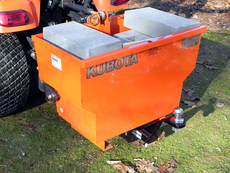

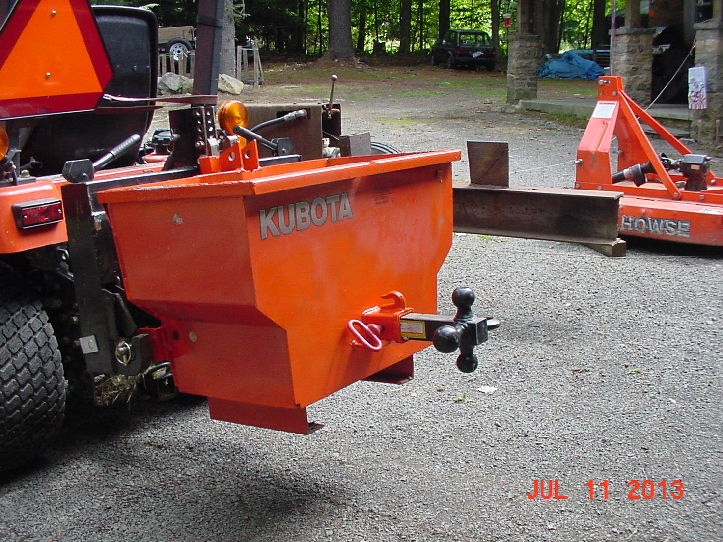

I added this to the bottom of my ballast box. It's Reese p/n 81378 for 23 bucks. It is the same height as the ballast box angle-iron feet so the box still sits nicely on the floor/dolly when off the machine.

Actually, adding the tow ball to the ballast box is a good idea, safety wise. Since there is no down pressure on the 3PH, the ballast box provides the weight to keep the trailer tongue from flipping up on uneven (backweighted) loads.
Personally, I like to back up to a trailer and hook up while sitting in the seat. So I use an A-frame with a hitch receiver tube welded to it. That way the ball and trailer tongue can be seen and the 3 PH just lifted to make the alignment. Hard to do with a ballast box in the line of sight.
