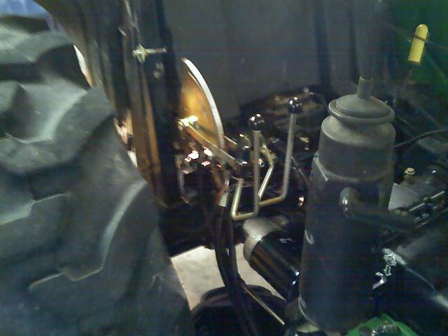

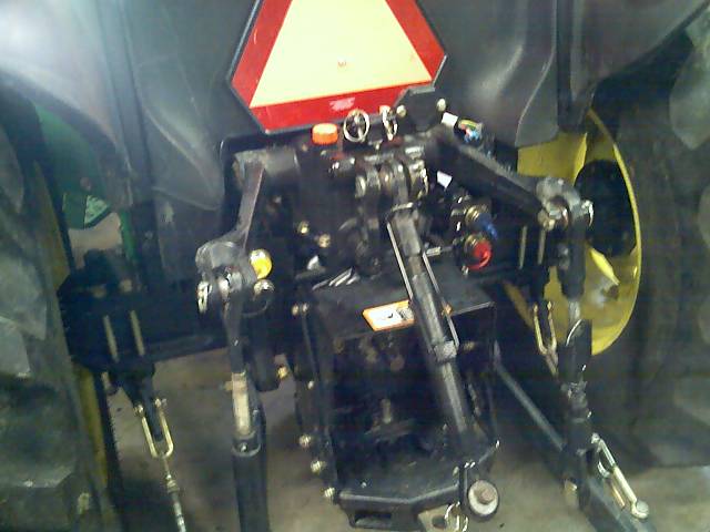

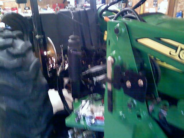

I just installed a second remote kit on a 5205 this past weak. The part# for the kit is LVB25065 it cost $520. The install was an easy one just had to remove the right fender, draft control lever and the seat. Here are are some pics. of the install. I hope this helps you out.
