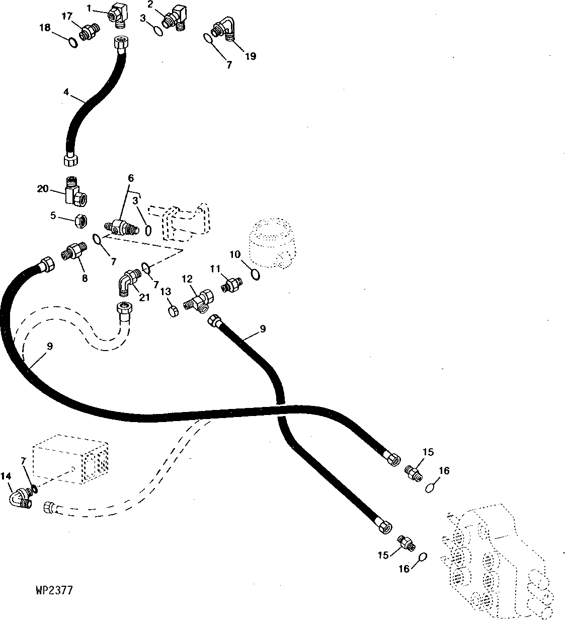

Good afternoon all,
I just picked up a 14six loader for my 2240. It came without the valve. I think I have settled on a prince 3 spool valve with a joystick (2) and 1 for a grapple or angle blade. the Boom also has a float. the valve has a max of 2five gpm. I will get the close center plug for it also. the tractor is rated around 9gpm It sound like this might be a little over board, so I wondering what others might do for a valve before i make the purchase.
also I need to know how to tap into the hydraulic system. it has 1 remote but I would prefer to leave it for other applications. There are 3 lines coming from the pump. 1 appears to be for the steering and brakes(?), the second one looks like it goes to the remote although it looks like it is plumbed into a large cast iron block before it goes there. the 3rd i assume it is the feed to the pump. this is all on the right hand side of the tractor under the floor board. My thought is I can T into the line before it goes into the remote. most likely where it transition from a hard line to a hose. I'm not sure where return should go.
Any help/insight would be appreciated.
Dan...
   / Adding a Loader to a 2240 #2
Dan, the 146 loader is a good match for the 2240. The pressure line is T'ed into the line feeding your remote. the factory setup used a "T" behind the cast block #6 and replace the steel line going to the remote with a hose #4. The return should be routed to the hydraulic filter cover. If your cover does not have a "port" to connect the hose, you should buy one. Returning the oil here assures that all the return oil from the loader gets sent directly back to the main pum so it does not starve for oil. Returning the oil directly to sump will cause the pump to cavitate and you will have jerky operation. The valve you mentioned should be fine as long as you install the closed center plug. Even the factory valve was rated for alot more flow. That is not a problem. An under rated valve would be a problem.

   / Adding a Loader to a 2240 #3
If you're careful you can reattach the original steel line that supplies the SCV to the lower fitting at pressure control valve. BTDT several times back when 2240's were new.
   / Adding a Loader to a 2240 #4
TX Jim is correct you can fit a Tee betwween the pressure control valve and the steel line for the rear valve. Did it when I put the 245 loader on my 2030.
jd110 is also correct, you want to return to the trans filter cover. You do not need as many fittings shown. The Tee with a cap is to allow other returns to the filter cover. My two rear SCVs have a hose from the end cover down to the trans filter cover, so I had a ported cover and only had to buy that Tee. I think I might have an extra ported cover(loader came with one too).

jd110,
Thanks for the schematic, I was looking for that one to get me going. It appears that my filter cover does have the port, at least there is a large nut ~1 1/2" in size on the side of the filter. I will have to look at it again tonight to make sure it is the correct cover.

   / Adding a Loader to a 2240 #6
Some of the later model SCV kits had a hose to replace steel line. Here's a list of the fittings & o-rings you should need to attach loader hyd's to tractor.

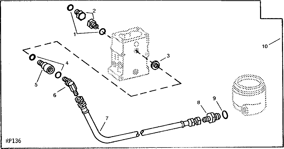

   / Adding a Loader to a 2240 #10
JD came out with the option to return SCV oil to the filter to aid in operating such things as orbit motors similar to the ones used on augers and post hole diggers. SELECTIVE CONTROL VALVE OIL FILTER RETURN KIT
