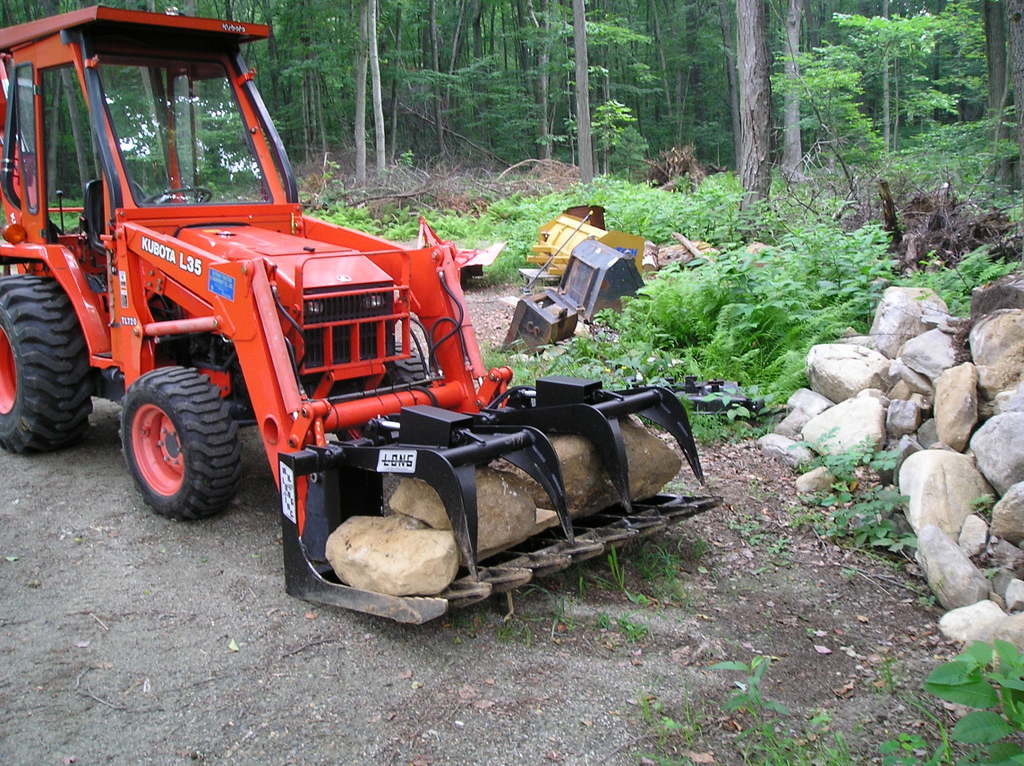

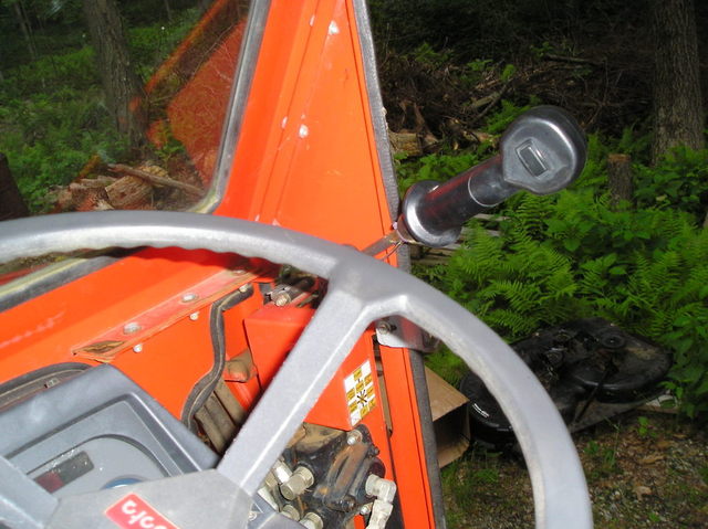

I have the WR Long 3rd function diverter valve with a push button control on the joystick... very easy to use. It's on a L35 also. The grapple is WR Long also, with ATI Quick-Tach . Good strong set up, very pleased so far.

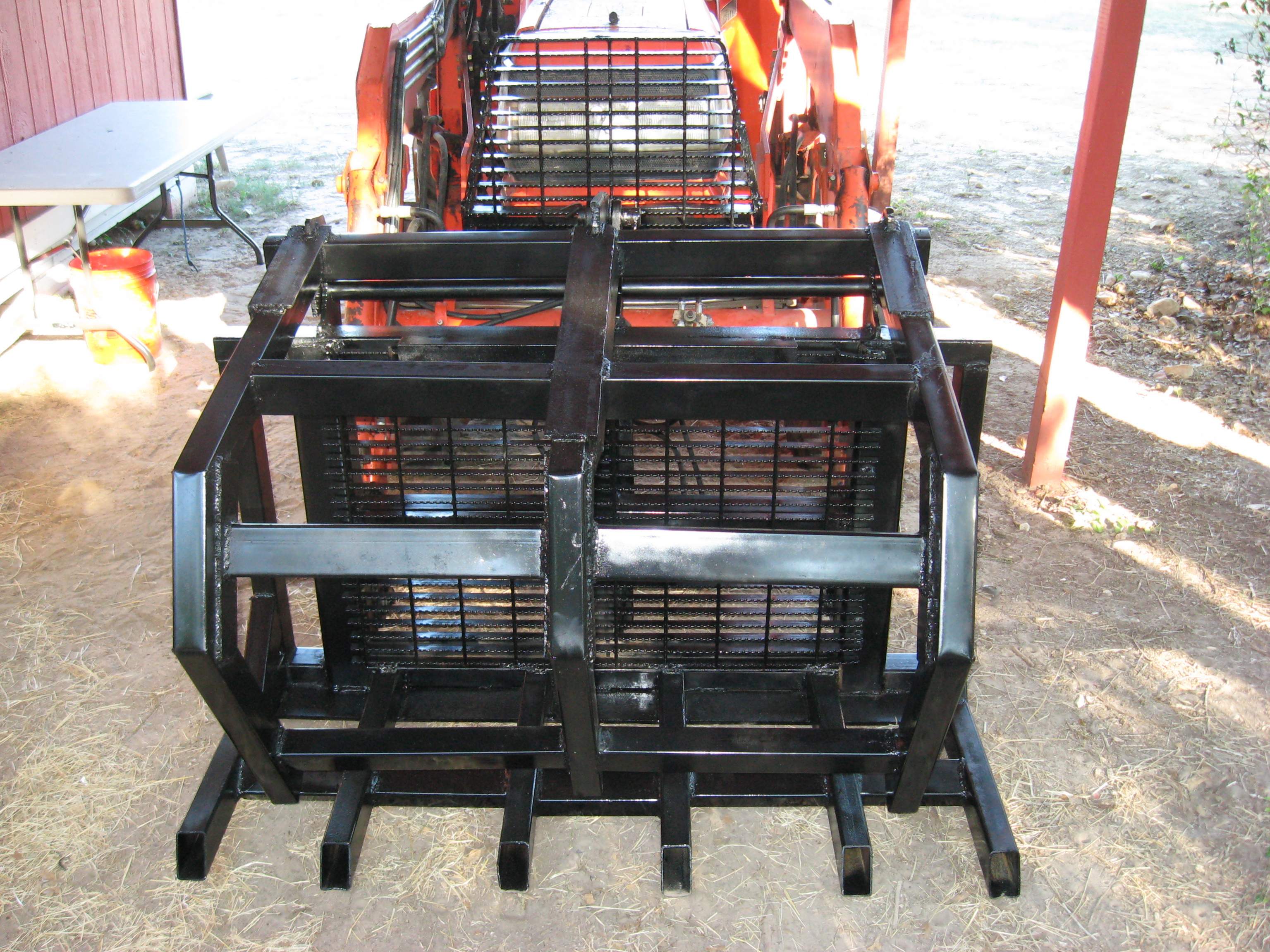

The WR Long Kit works fine - the only issue is they send the low rated psi hoses and they leak at the crimps - Other than that they work fine...if you go to a dealer they may replace or swap the cheeep hoses and make hoses for the psi you need. PAIGE TRACTORS replaced both hoses when they leaked at the crimp.
The cost installed was $690.00
Also I built my own grapple ... and you should look into a brush guard..or you will end up like the JD guy with a new hood ornament!:eek:
