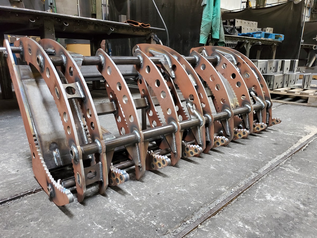

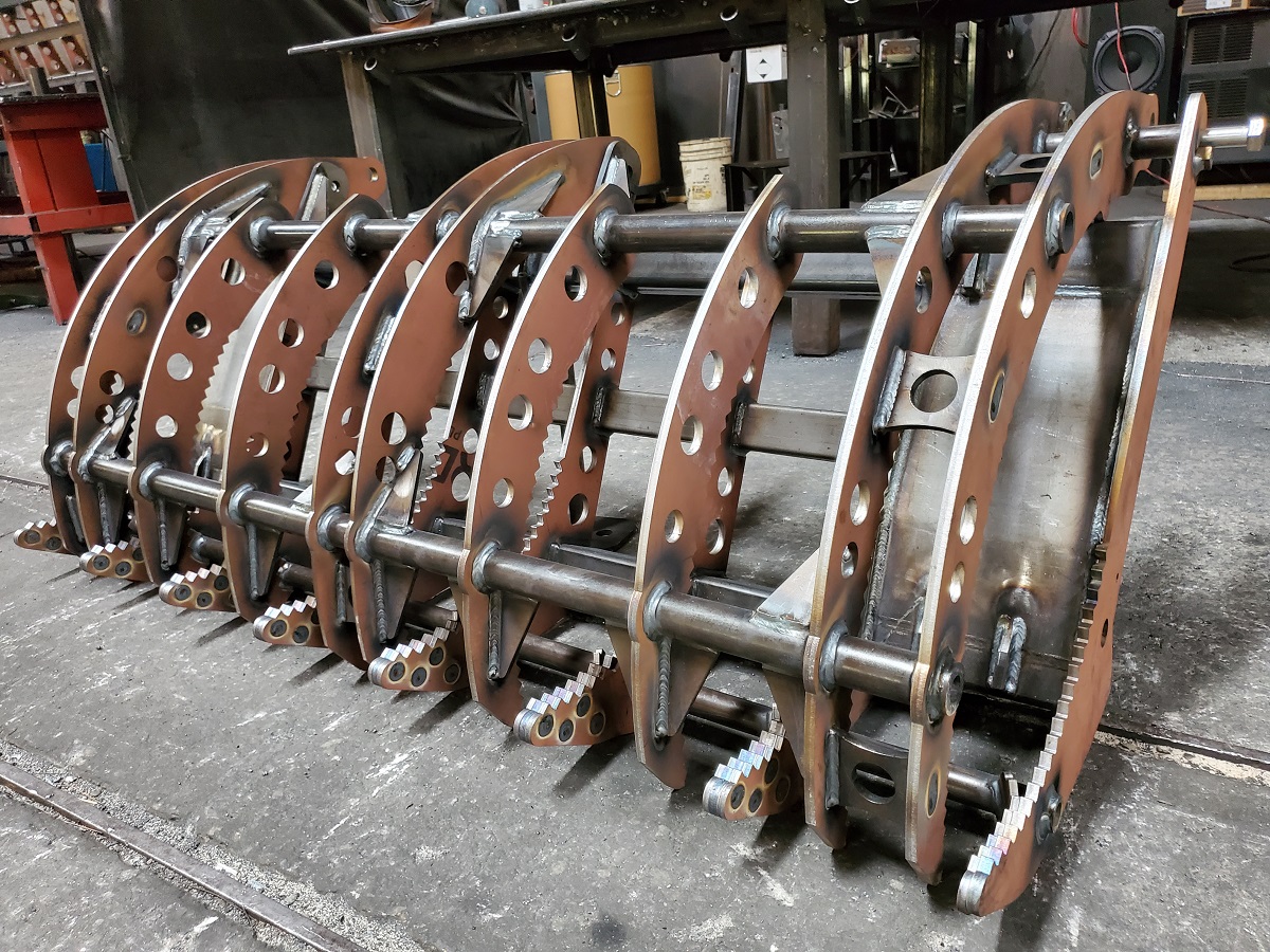

4. Our most popular grapple for it..
The Wicked 60 rake style grapple is an absolute 400 pound versatile brute unlike any other rake style grapple on the market.

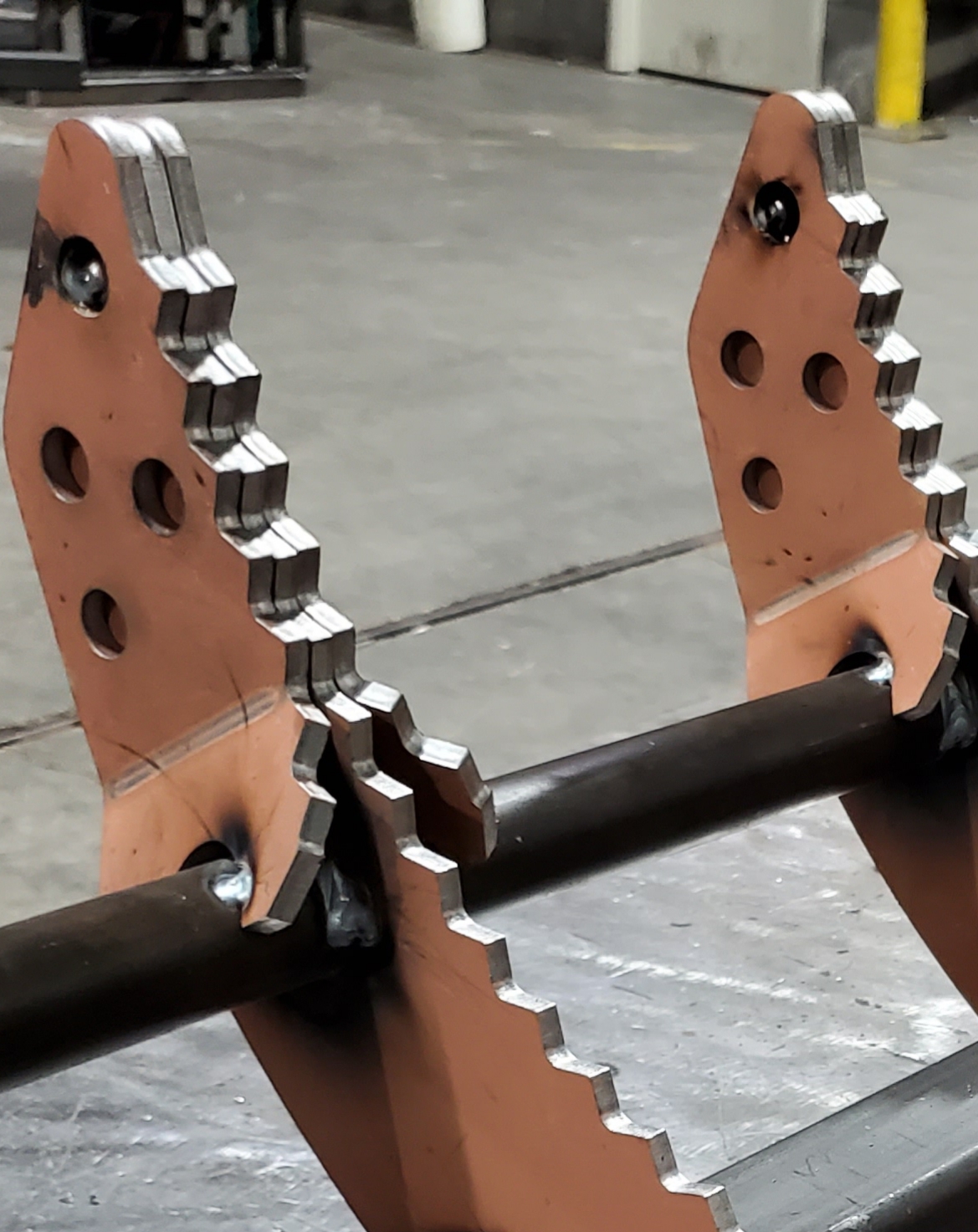

Our Wicked Root rake grapples are really the most versatile and popular grapple offerings in our lineup. Besides being surprisingly lightweight for the intended machines, our unique combination of premium materials(Hardox AR450 steel and thick walled DOM round tubes) makes EA root rake grapples incredibly strong and durable!
The dozer-like tine geometry of the rake style promotes a tractor's ability to push the serrated, laser cut tines through the ground with ease and the design keeps the load as close to your loader pivot pins as possible to MAXIMIZE lift capacity like none other.
The root rake style allows you to pull brush, vines and other debris backwards, which isn't recommended with many long bottom grapples. Besides pulling backwards, you can also pull down. Reach up and snap a limb off the tree if you feel like it.
The root rake style will easier "unload", so you can hover over the trailer, dumpster, pile, etc., open it up and whatever you've captured is gone!
The best recently got better. Check out our new, unique laminated end tines. Unlike anything in the industry!
