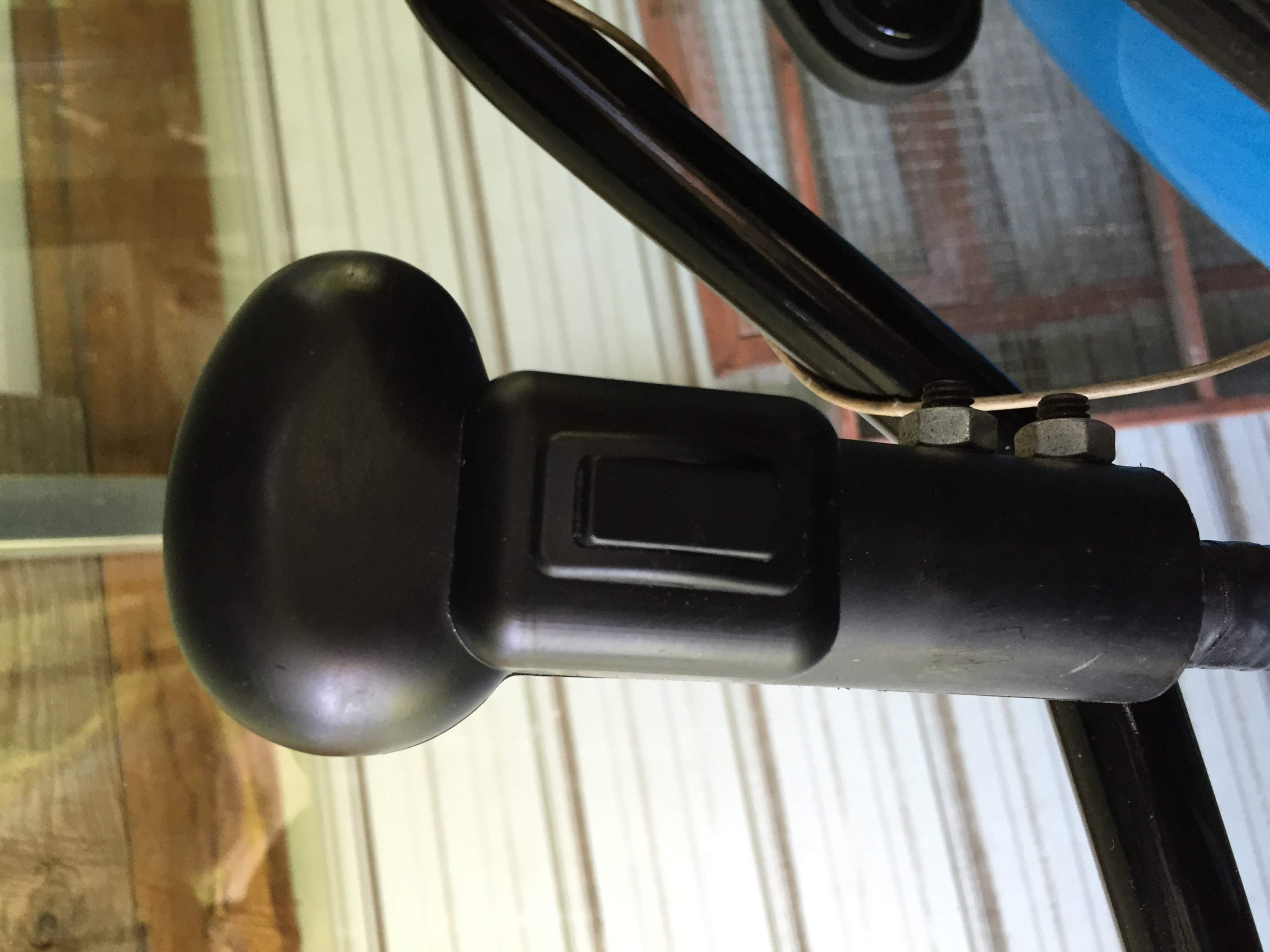

I bought my XR3037 and a 3rd function valve installed at the factory before it left town.
I'm not certain who did the work as the cost was listed as part of the purchase.
It was a line item with no Installer mentioned.
It was expensive to have the switch mounted on the joy stick but well worth the cost.

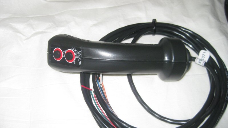

If you have one, could you post a pic of your switch on the joy stick? Also if you don't mind, how much was it?
   / Adding a 3rd float rear valve #9
Here is what I sell if you are interested. Sorry about the sideways picture. :eek:
Runs $200 shipped to you.

I've misinterpreted your post.
I, at first, thought that you wanted a third function for your front Bucket/Grapple.
Then again, a third function on your joystick can be for what ever you wish it to function.
Mine was purchased through my dealer here in North Florida, now defunct, and my information was that an after marketer
down the street from the production facility in NC installed the switch and the cost?
Gulp...$1100 but believe you me. It's worth every penny to not have to maneuver the lever to my right side
every time I need to close the bale up front.
