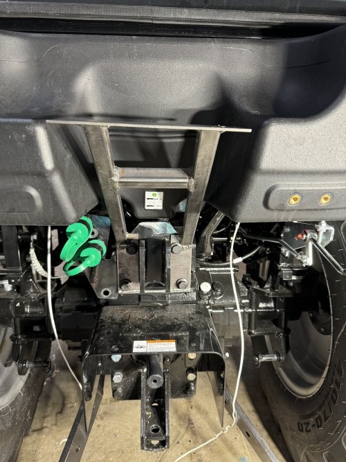

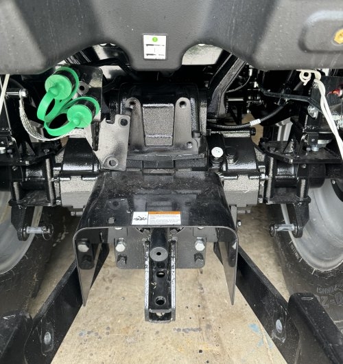

Since there isn’t a lot of info floating around concerning adding rear remotes to a MT242HC I thought it a good idea to post this project in case others might be interested in doing the same. I’ll be adding a 6-circuit hydraulic multiplier offered by Summit Hydraulics. Starting out I’ll post a picture (soon as I resize it down) of the top link support that was removed from the tractor so that I could make a support for the main valve assembly. The single factory installed rear remote mounting bracket has also been pushed to the side temporarily. The valve block is heavy and I wanted to make something substantial for the mount. Before you ask no I really didn’t need all 6-circuits but, what the hell.

Forgot to mention that my LS came to me with a detent in the factory installed single rear remote and because that won’t work well with the overall plan I’ll be modifying it so that it becomes a spring return valve. The kind folks over at Tractor Depot put the necessary spring in the mail to me.

Here’s a test fit of the bracket that I had fabbed up by another TBN member. Once I’m sure everything fits as it should I’ll remove, prime, & paint before re-installing and moving on to the plumbing and wiring.

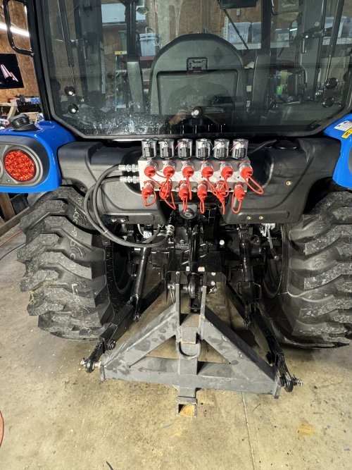

After getting the bracket mounted this is how it turned out, very solid on the mount. Notice I mounted a camera under the valve block to help aligning implements. Next time I get out to the barn I’ll get a picture of1 where the switch box was mounted.

That looks great! Excellent job!
