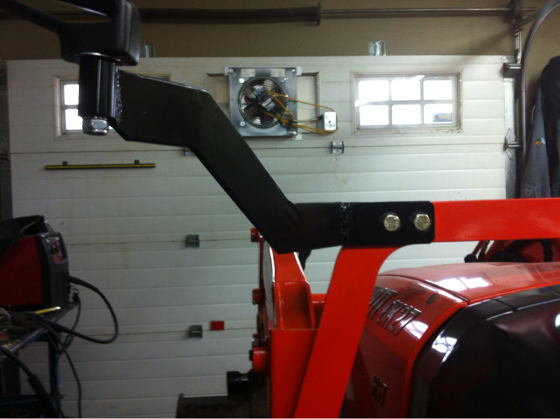

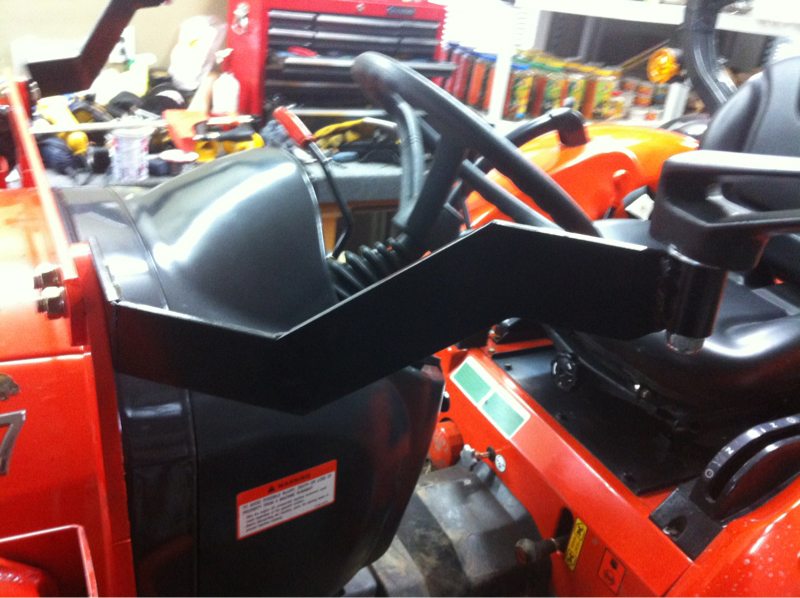

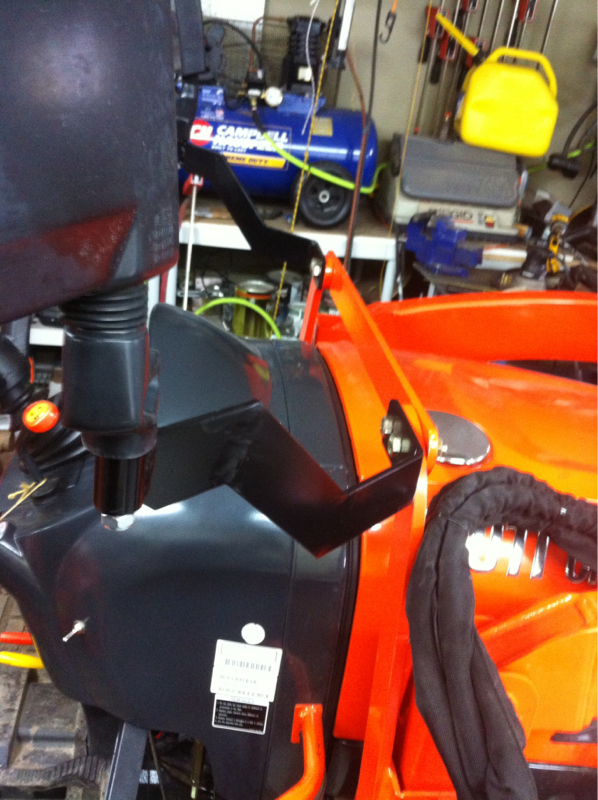

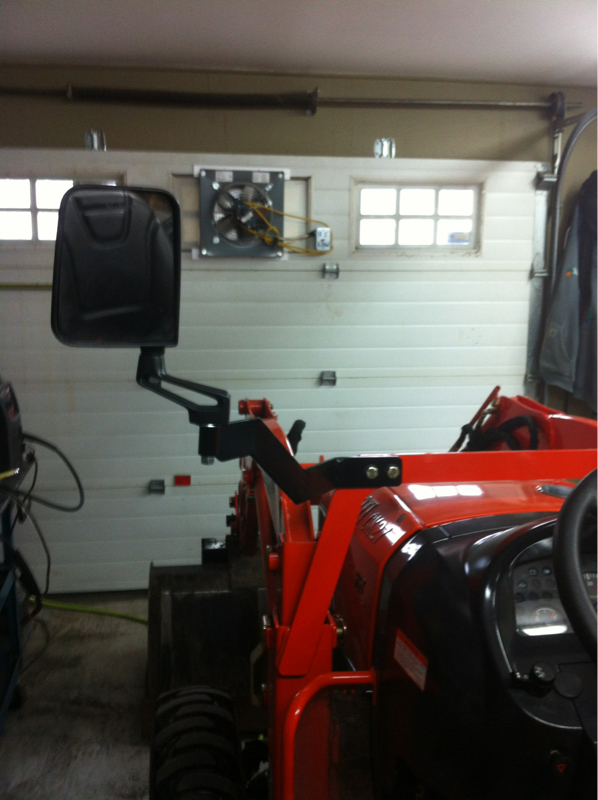

I have a very small lot and my tractor is mainly used for working my 6000 sq' of garden. Naturally I have lots of backing up to do. I almost go in reverse as much as forward. I wanted to add side mirrors so this is what I came up with. 1987-95 jeep mirrors from eBay, $15. I then fabricated brackets out of 1/4 x 2" flat bar and mounted them to the loader cross beam support using factory bolts. (The bolts were 3/4" longer than they needed to be from the factory).
No my only issue is that the 2 mirrors have different focal lengths. The right one is your typical "objects in mirror are closer than they appear". I may have new glass cut for them if its a problem.

Nicely done! I know what you mean about backing up a lot when working a garden in close quarters.

Really nice. Looks like they came with it. Wish I could put some on my 135. I get really close to the tree line when brush cutting and would have to clear a lot of limbs. I mean a lot. Good job. :thumbsup: -kid

How bad do they vibrate ? Ilike the exhaust fan in the garage door .

I don't know if you have a roof on your tractor, but if you do you may wish to consider this setup http://www.tractorbynet.com/forums/customization/246150-whats-my-mirror.html
I don't have any vibration issues and since there are side "gull" mirrors, I get a good overall view behind me.
