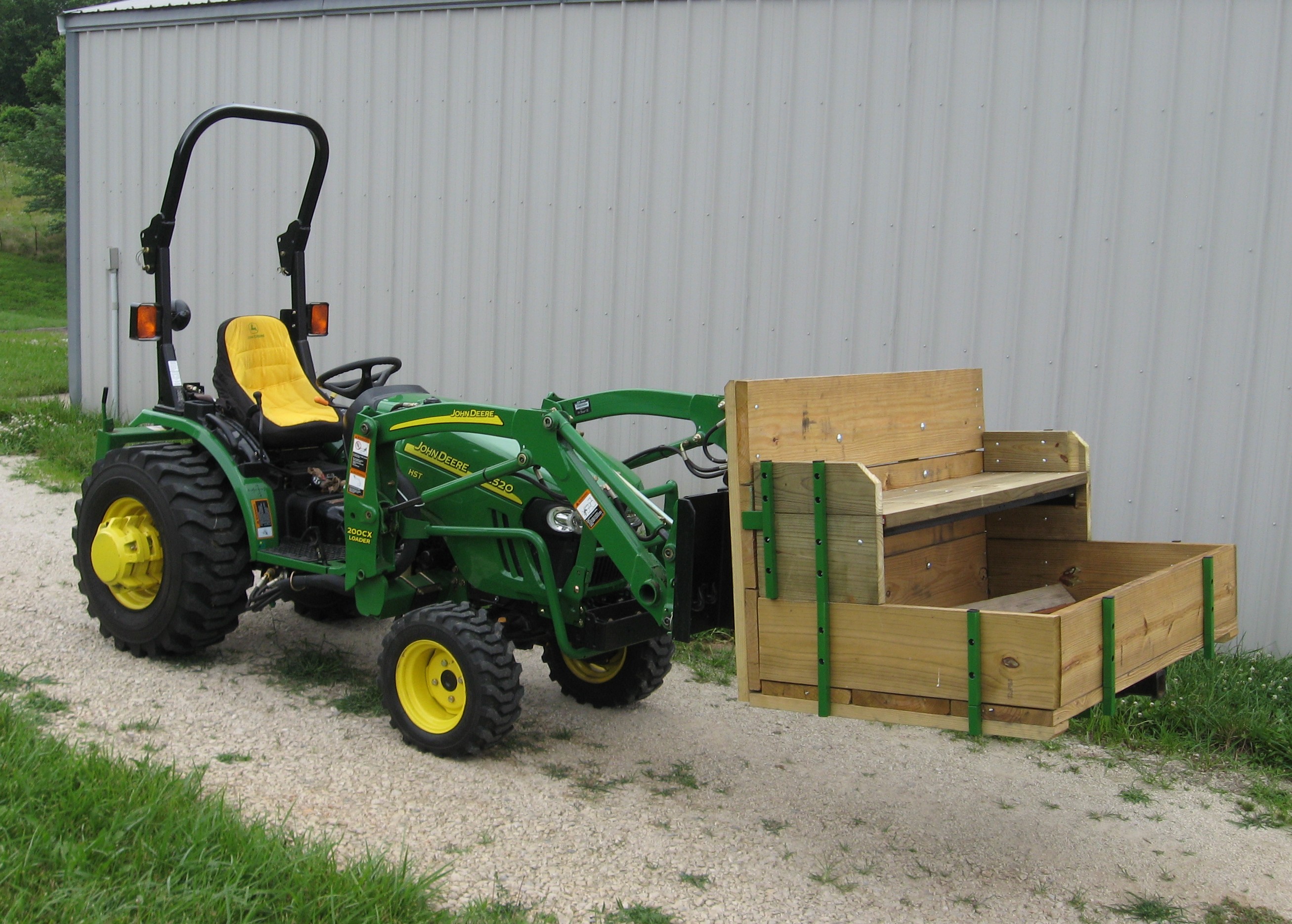

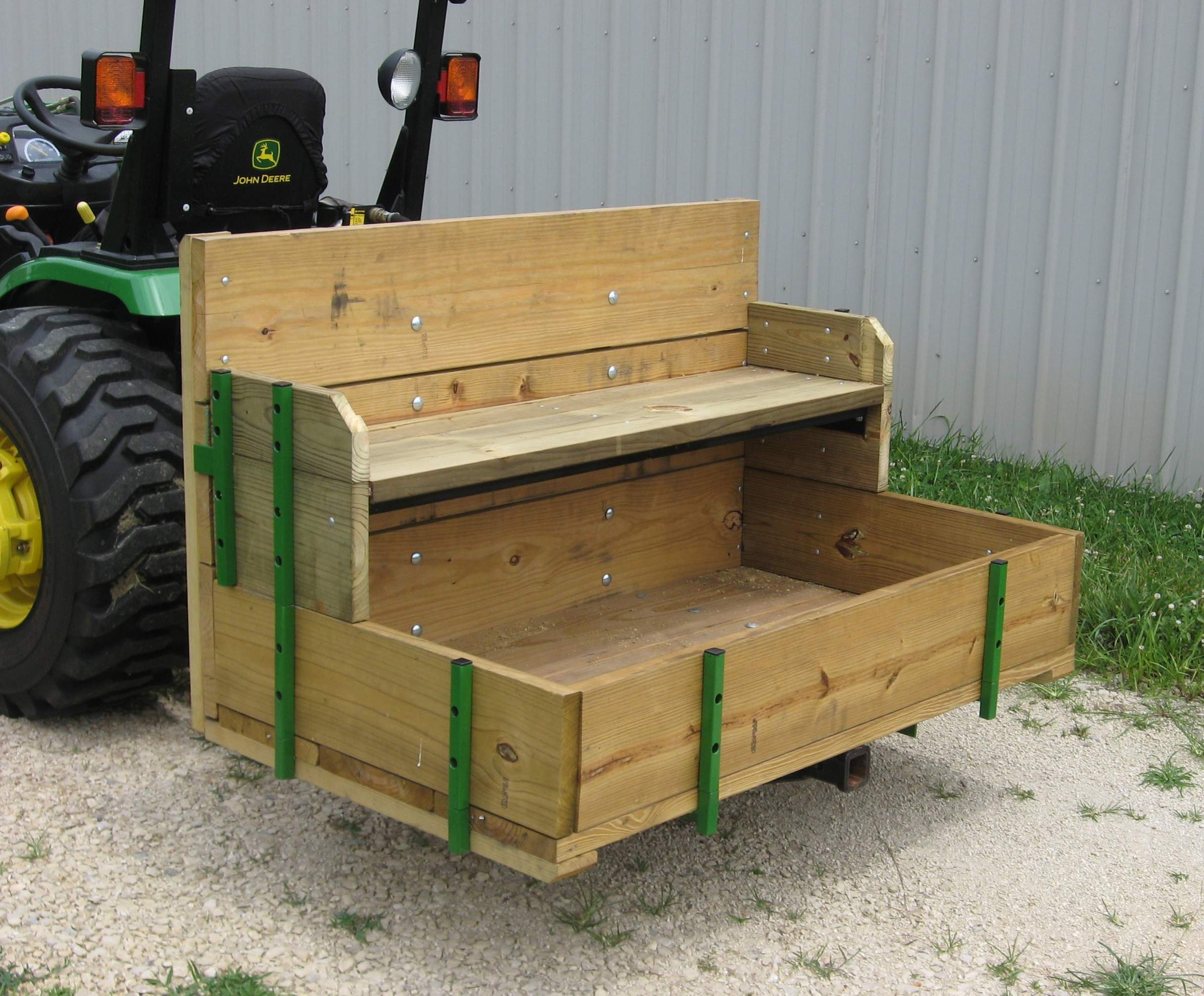

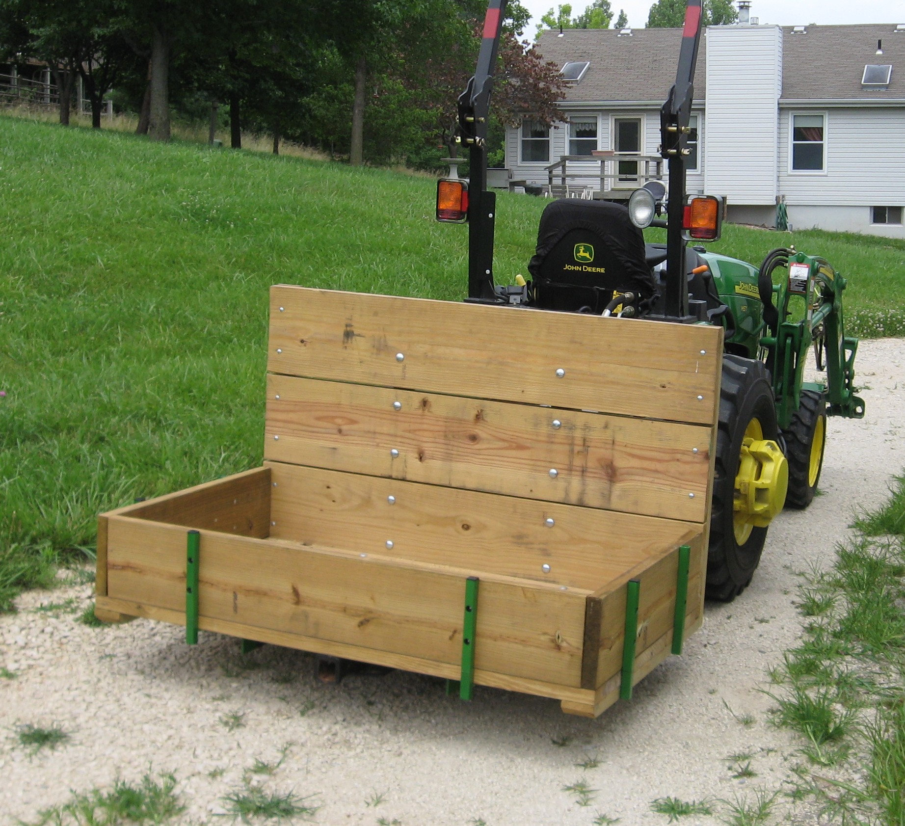

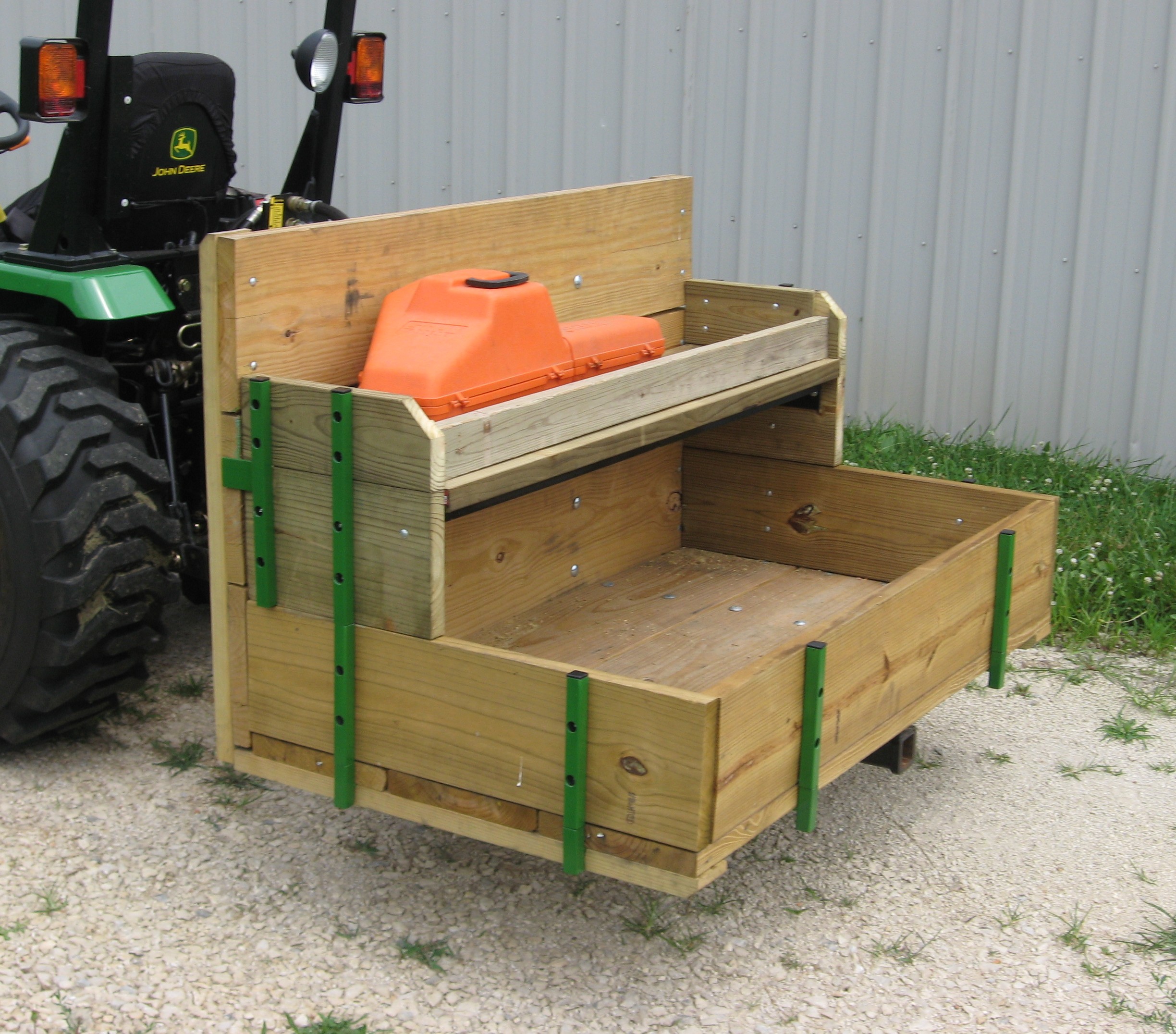

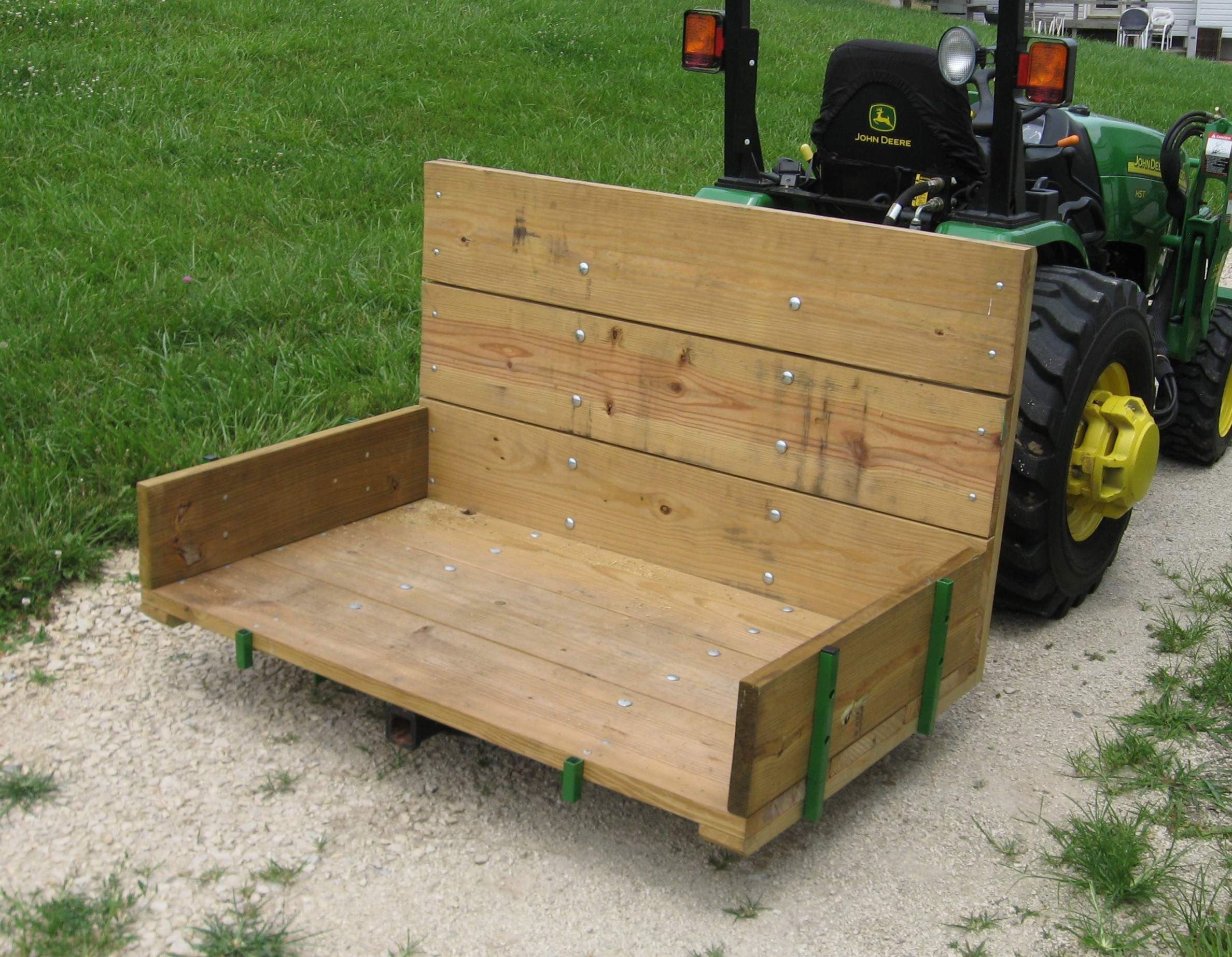

I used 1 inch and 3/4 inch square tubing to make stakes and stake pockets for sideboards for the carryall. Also, made a removable mother in law seat/tool shelf that attaches to the stakes.

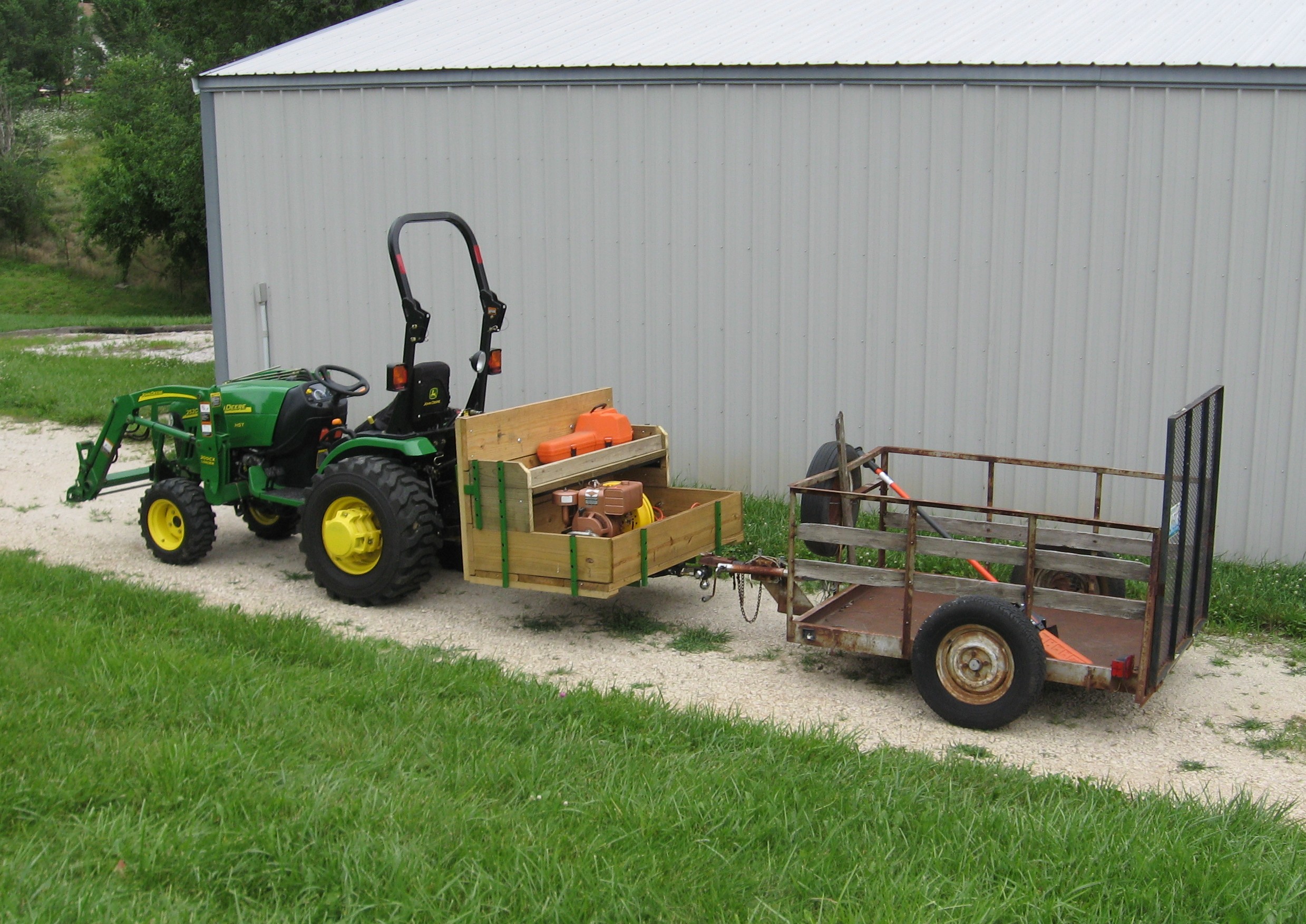

In the second to last pic, you can see how the final product will function as my tree trimming rig. The carryall holds my tools and generator (for electric pole saw) and the hitch on the carryall allows me to tote my tree limb trailer behind.
With my front quick hitch, I can mount it on the loader.
In the seating configuration, I think the wife and nephew will enjoy carryall rides.

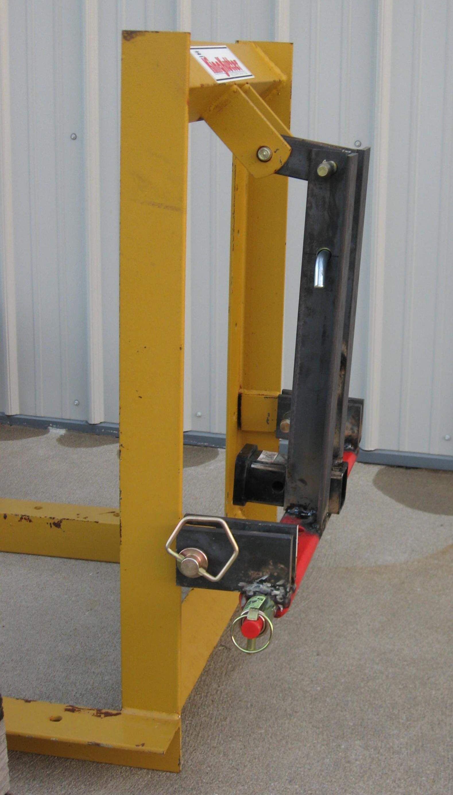

I'd like to see a few pictures of the 3pt hitch framing attachment (on the back of the carryall) arrangement please.
A nice looking gadget. I like it.

Since this was a King Kutter carryall frame, it did not work with my iMatch, so I made an adapter. Here is the best pic of the adapter.

A pic maybe of the rear of the carryall where the points of attachment are located? I am interested in the framing that it is build on, of which it attaches.
   / Added Side Boards and Mother In Law Seat to Carryall #5
Great looking rig Runner . I just got the same carryall frame & thats as far as I,ve got so far :D . Thanks for showing. Bob

I agree, this is great in and out of the box thinking! I have an old frame that needs new boards. With a little welding, it could be much more useful. The reciever hitch is a great idea

I really like how you put the hitch-box on the end so you can pull a trailer!

Very nice. Do you have safety chains or a means to insure it will not slide off the FEL forks and dump you when you are using it to trim trees?
