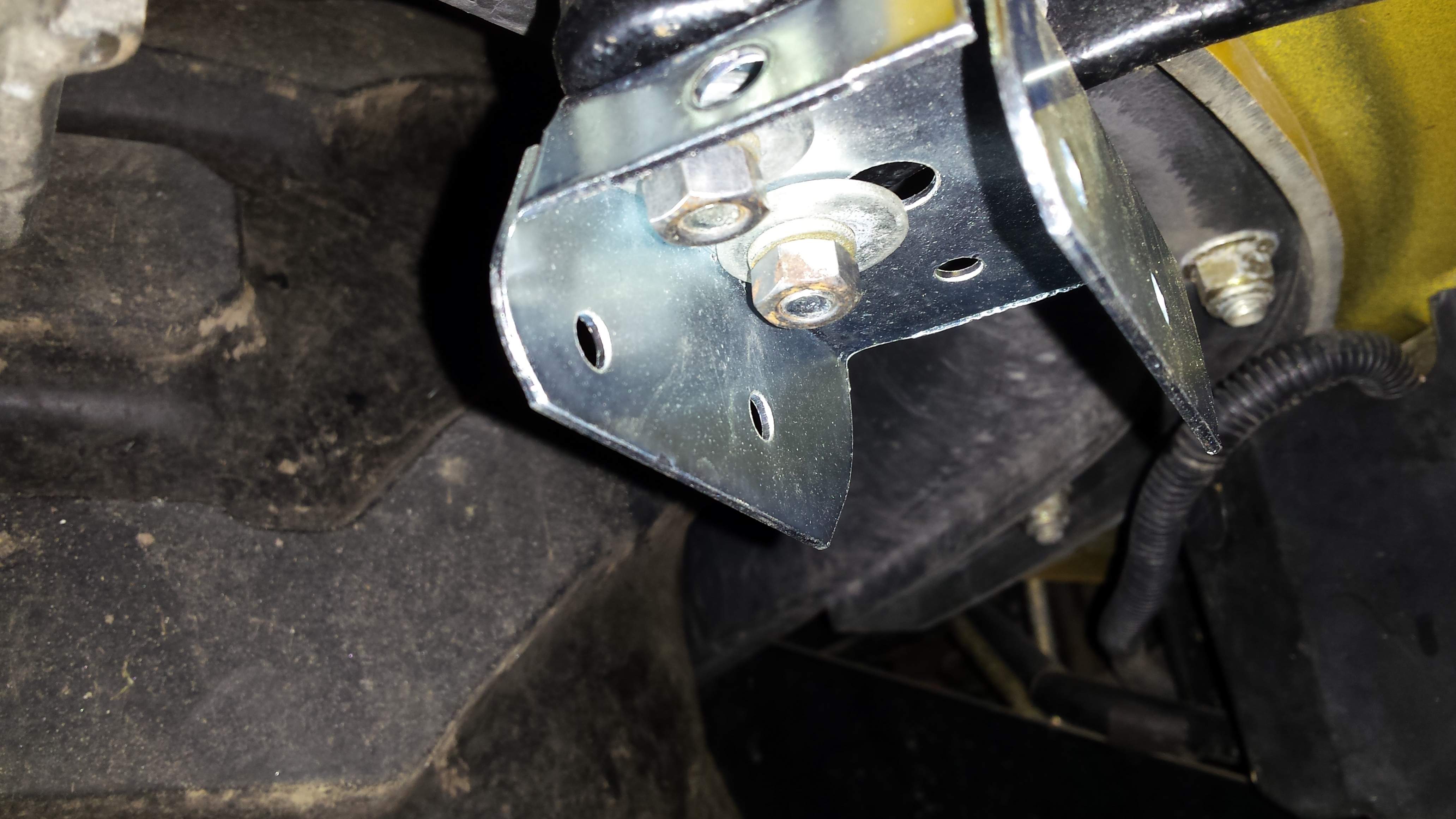

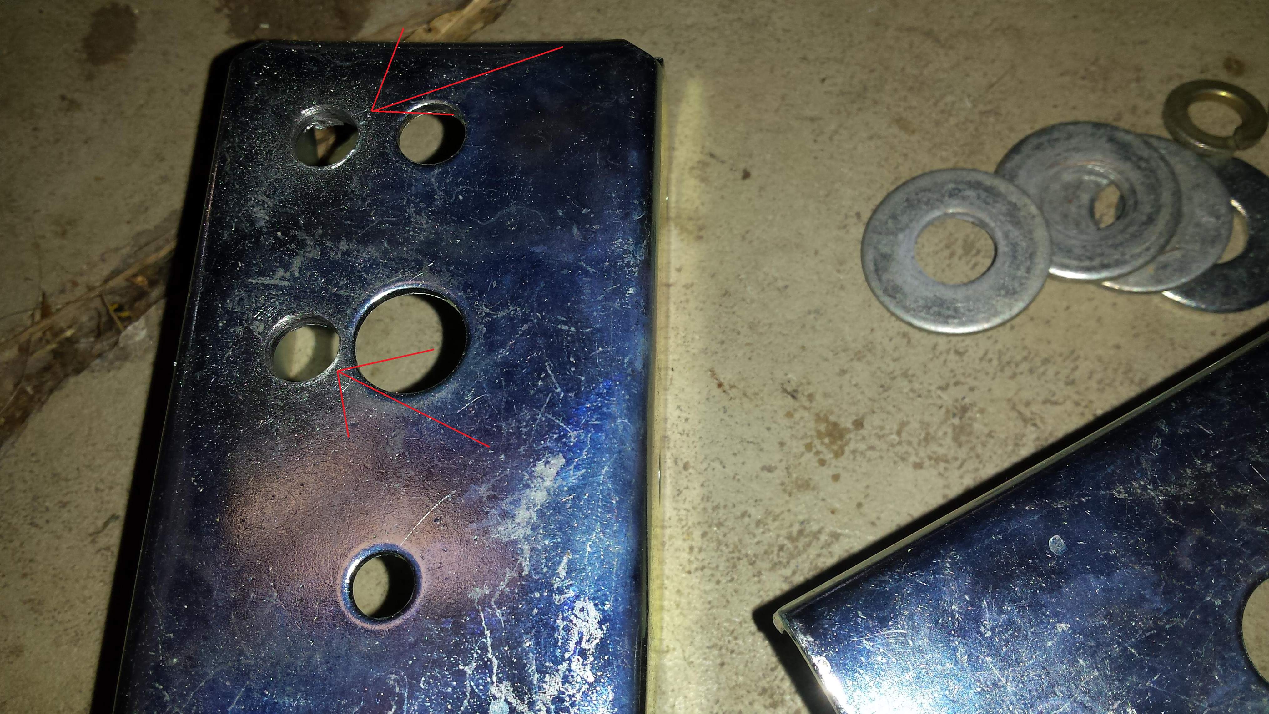

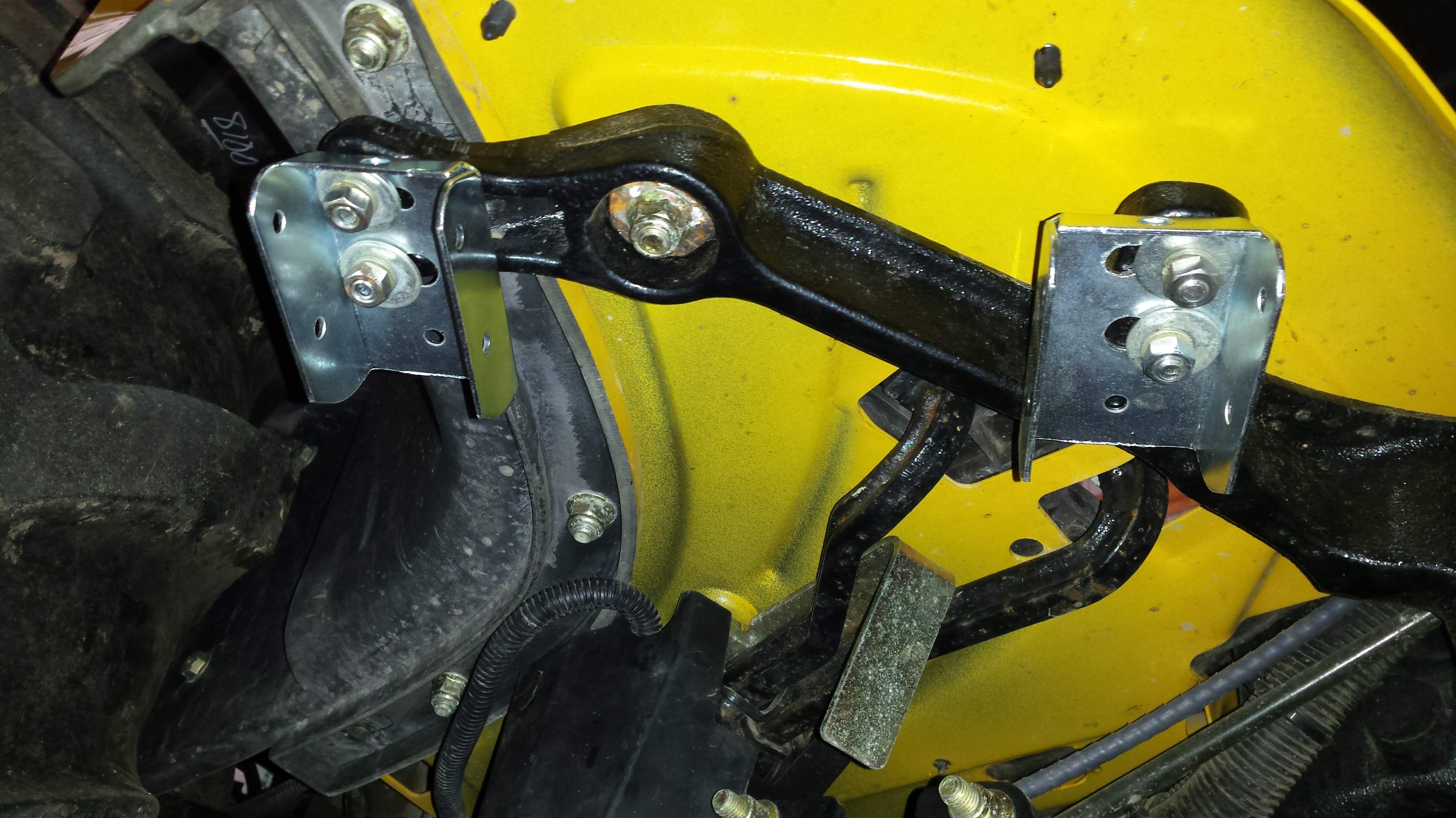

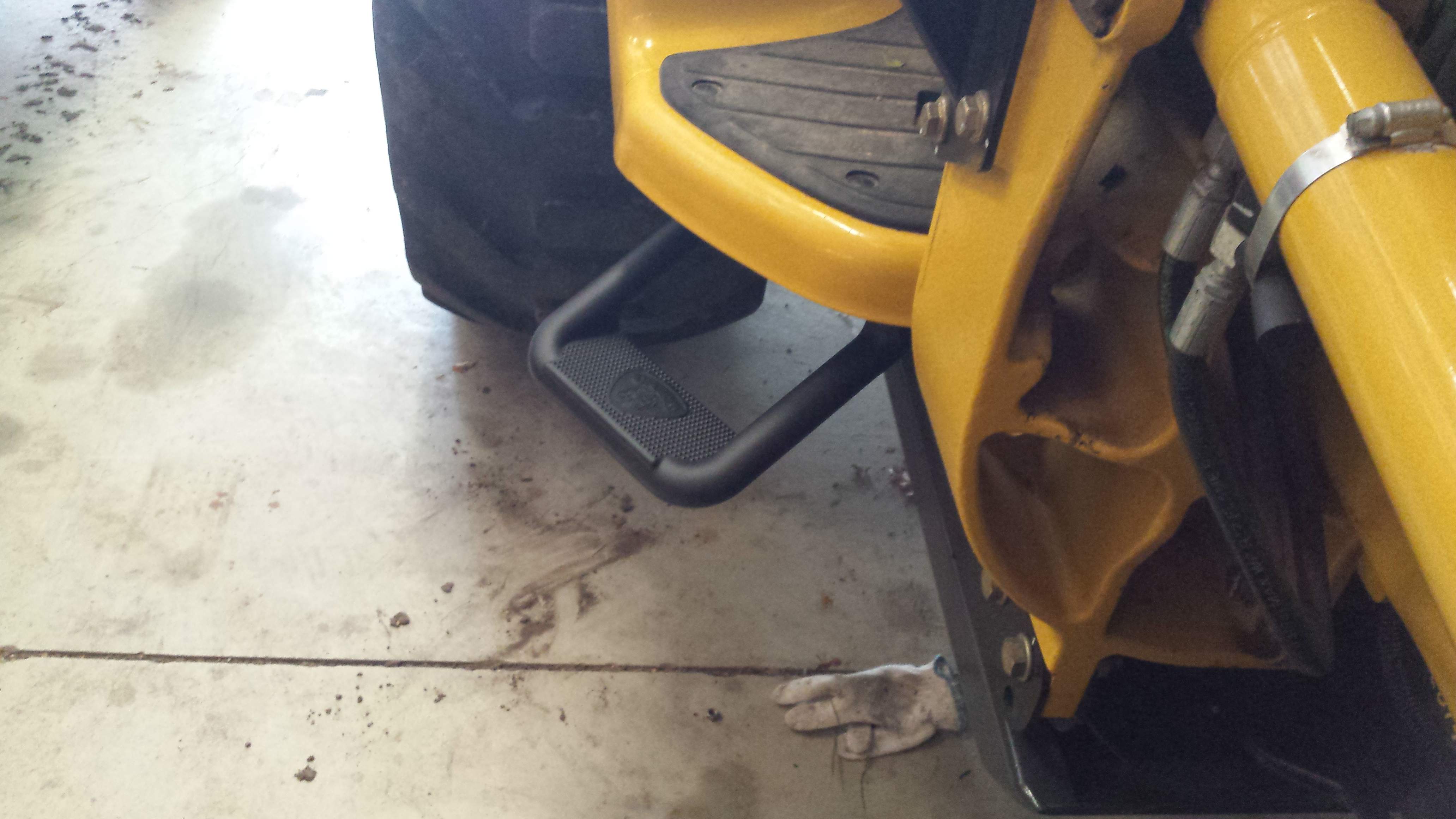

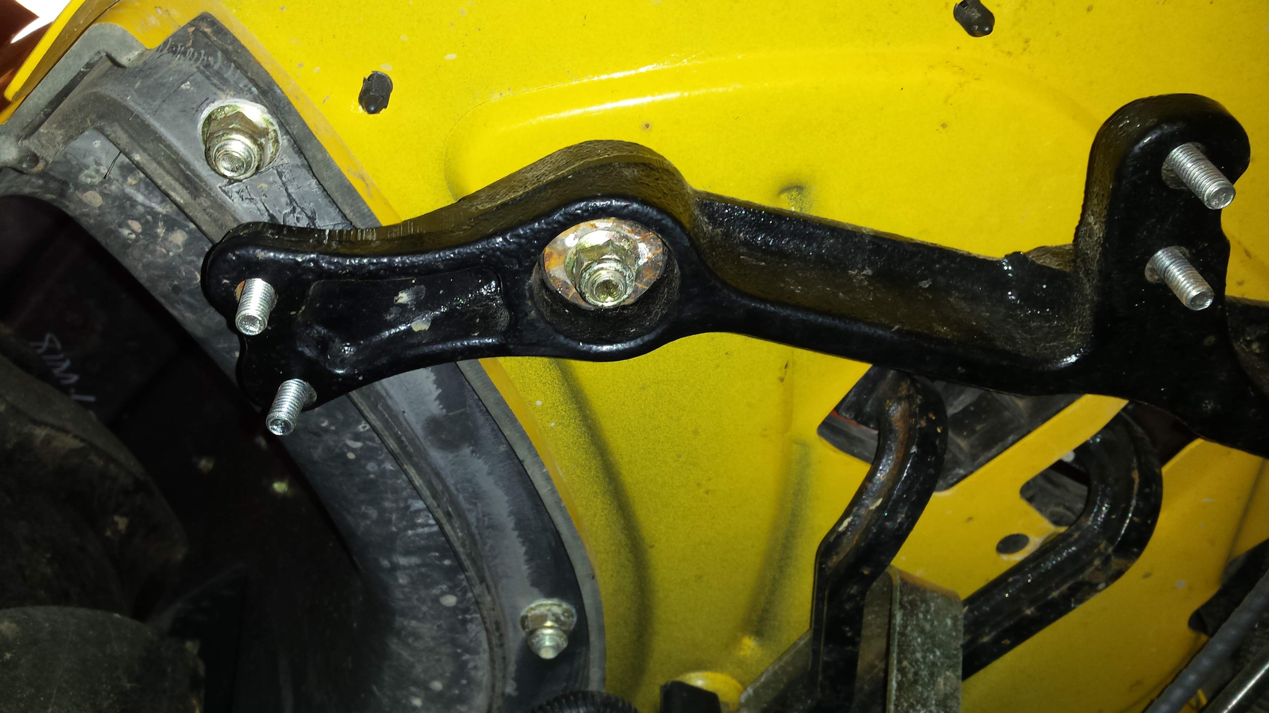

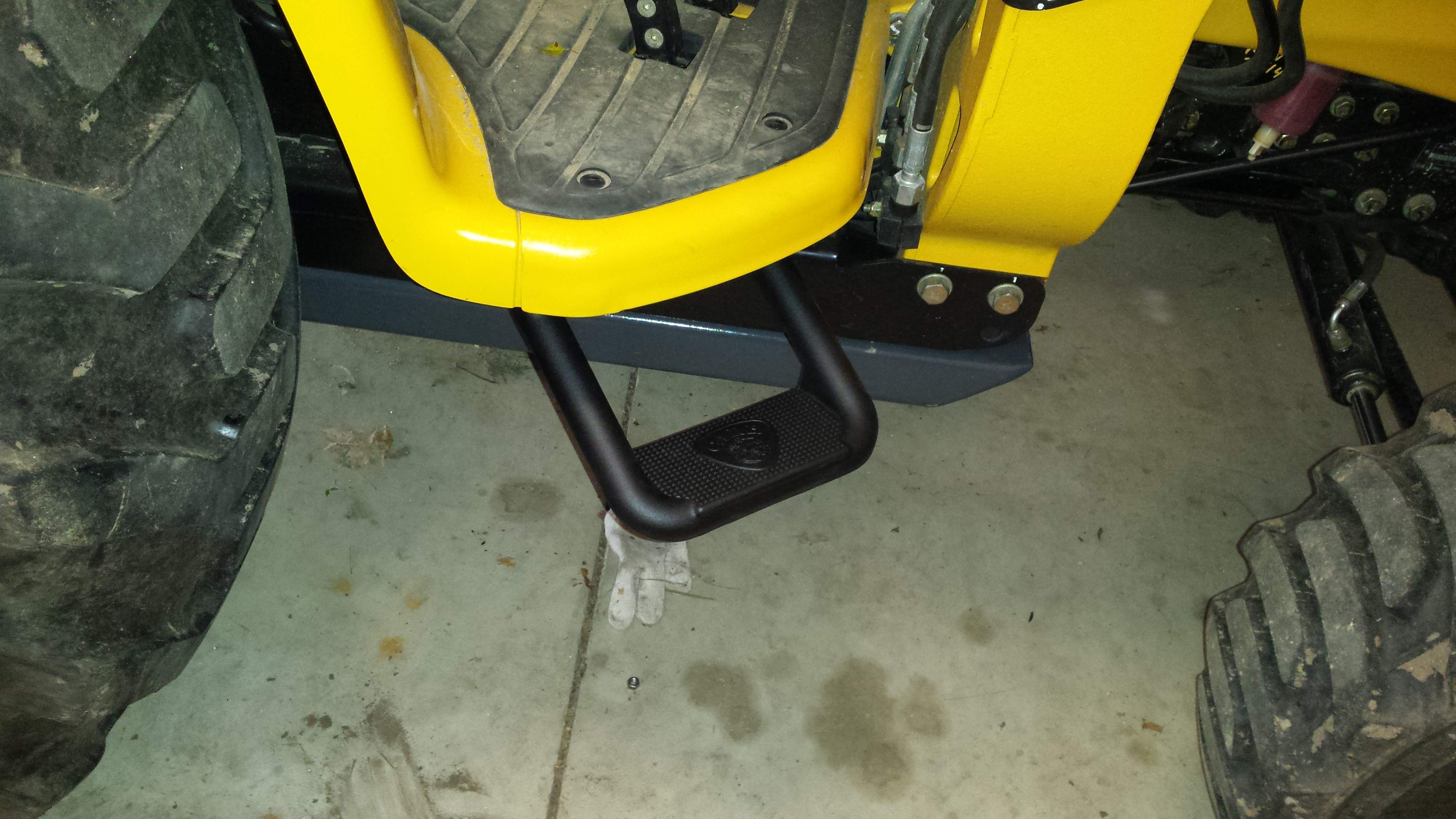

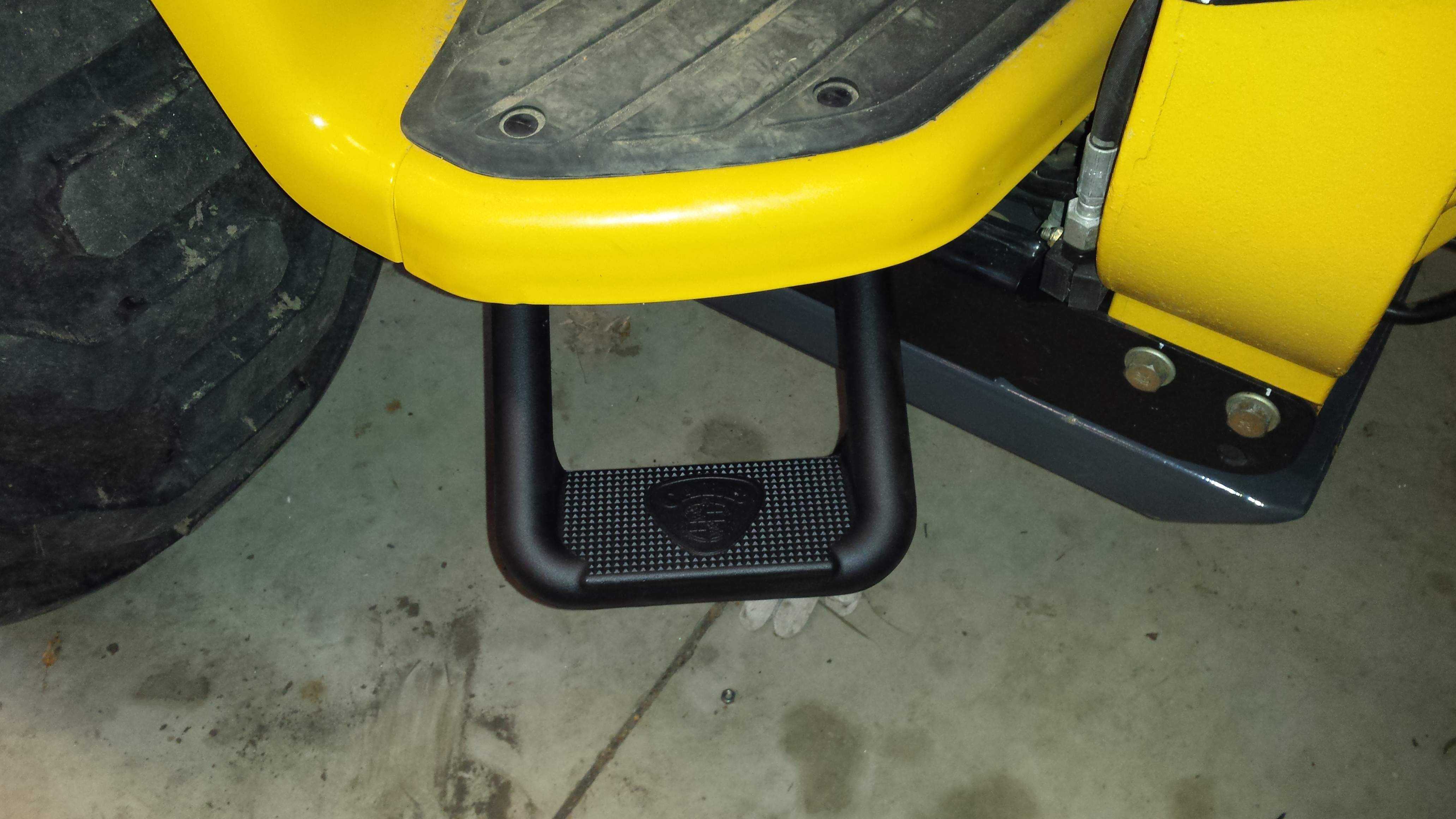

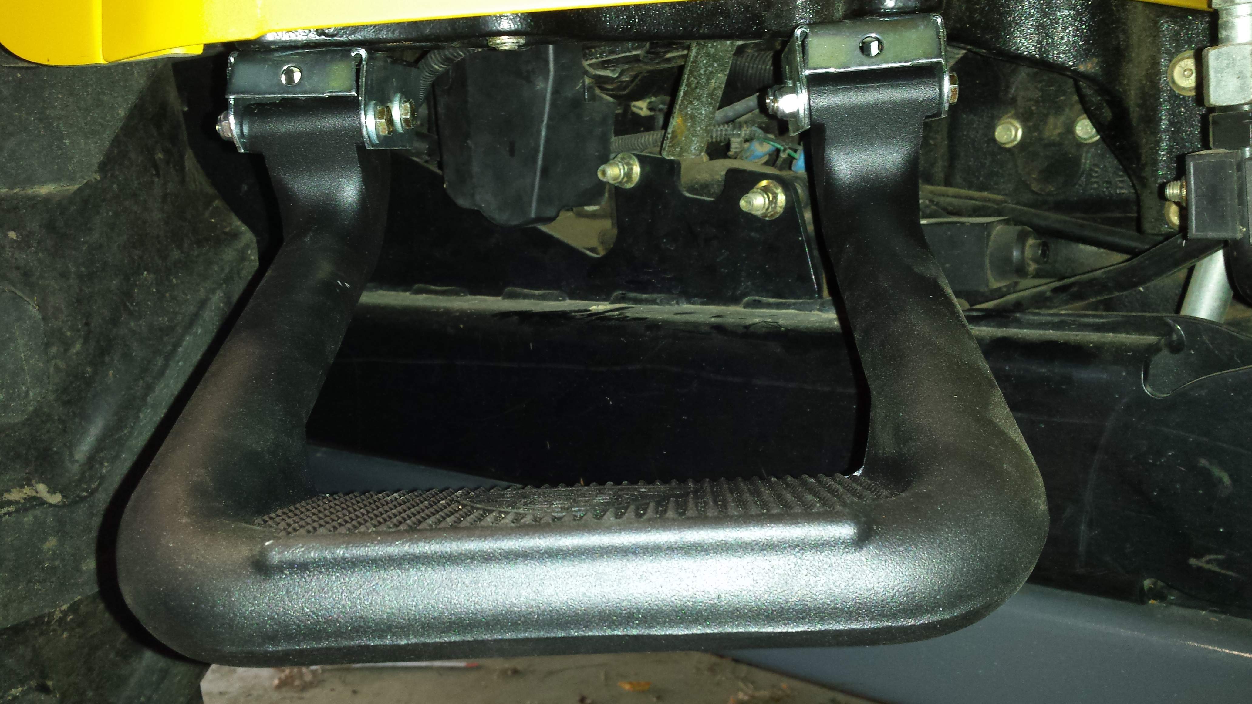

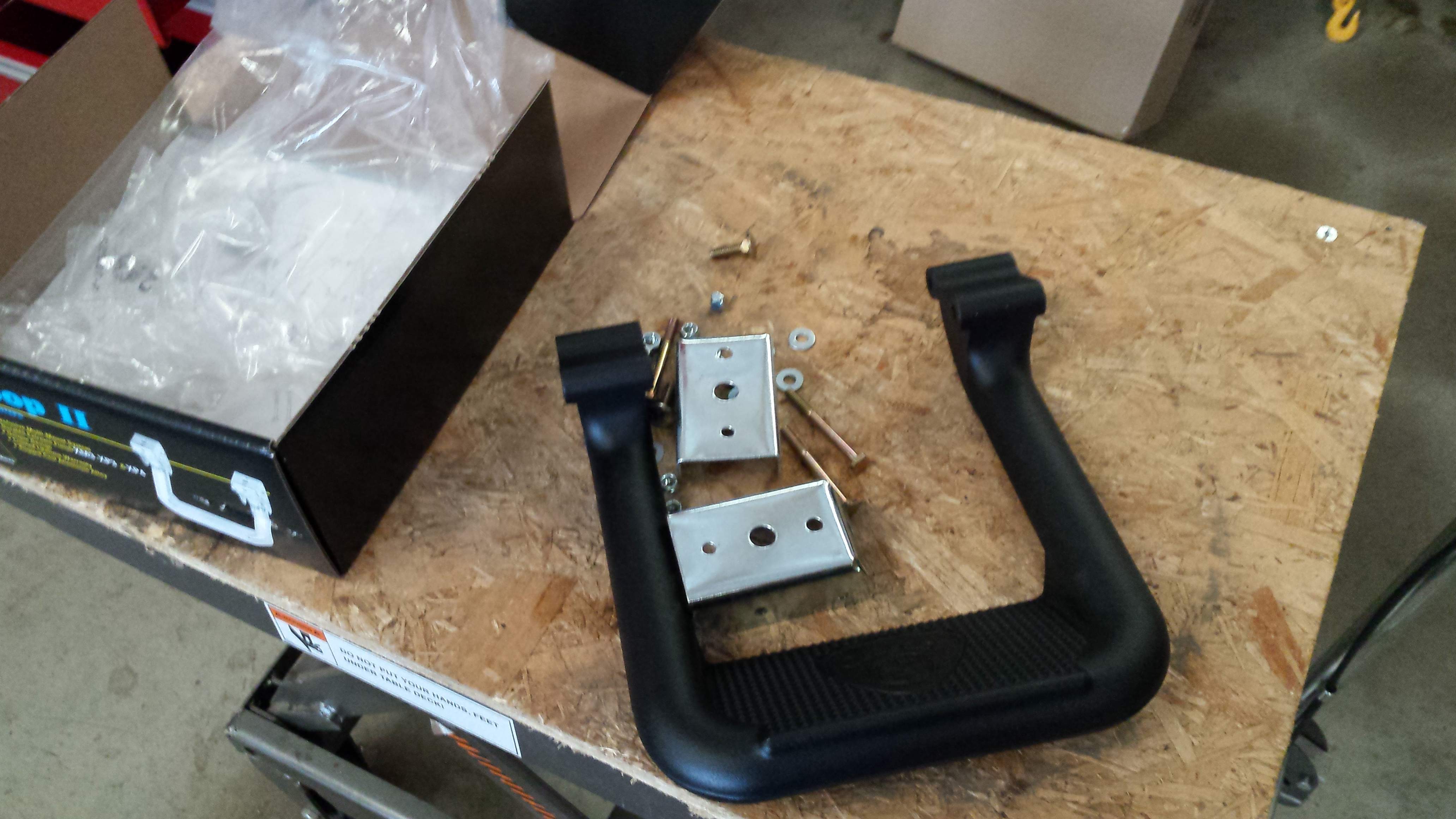

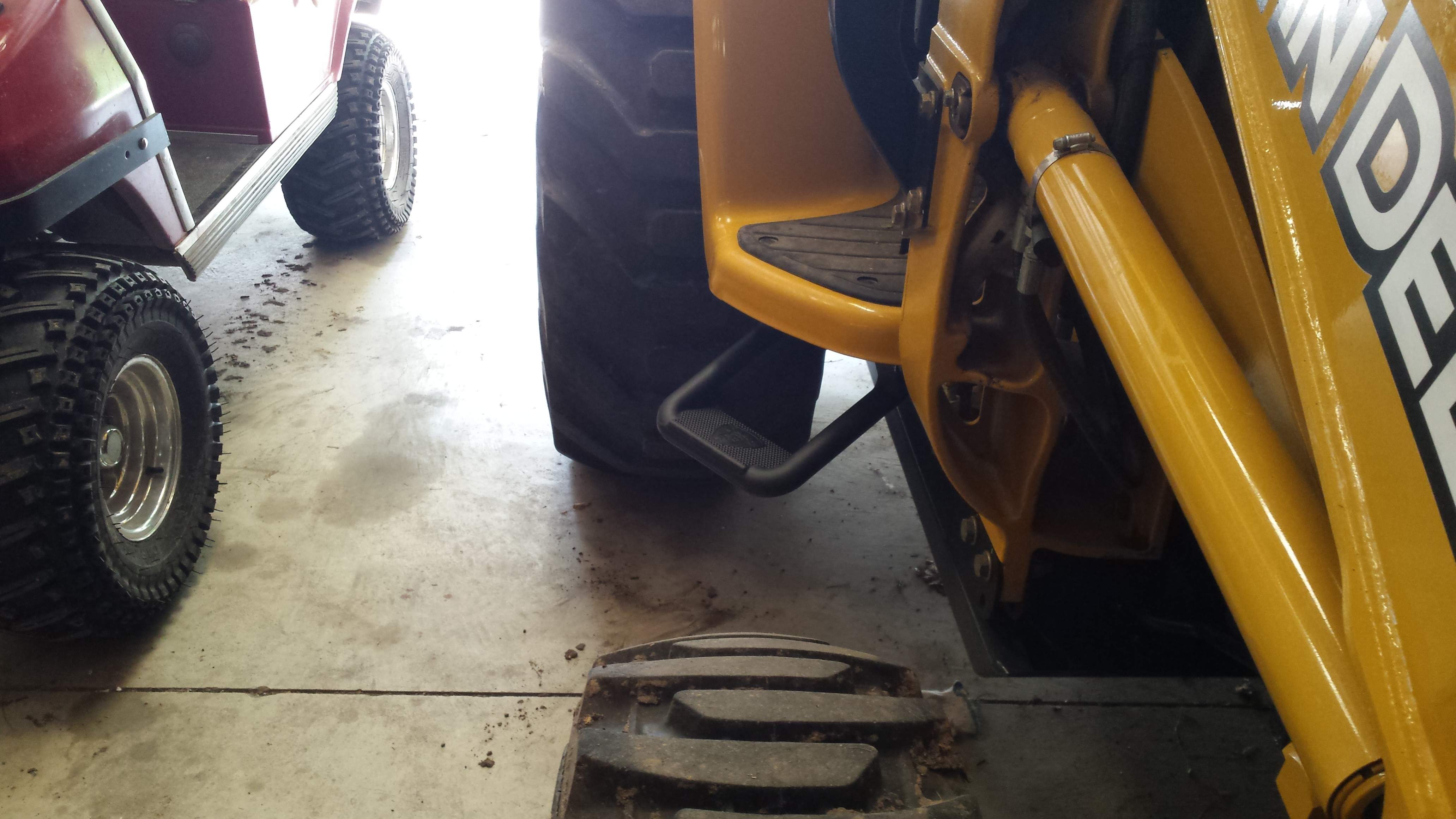

I added a right hand side step to my 110 TLB. I just want to let others know how easy it was if they want to try it. I had to drill some holes in the brackets that came with the step.
I used the 4 existing holes that were on the tractor.
4 carriage bolts 5/16 x 1 1/4
Carr 102521-1 HOOP II XP3 Black Powder Coated Step (the step is made in USA)
Amazon $33.43
   / Added RH step JD 110 TLB #3
That's kool. I been wanting add a step on the right side of my tractor for a long time.:thumbsup: Thanks for the tip
   / Added RH step JD 110 TLB #4
Great job Doc, I may just copy your idea on my 110.
