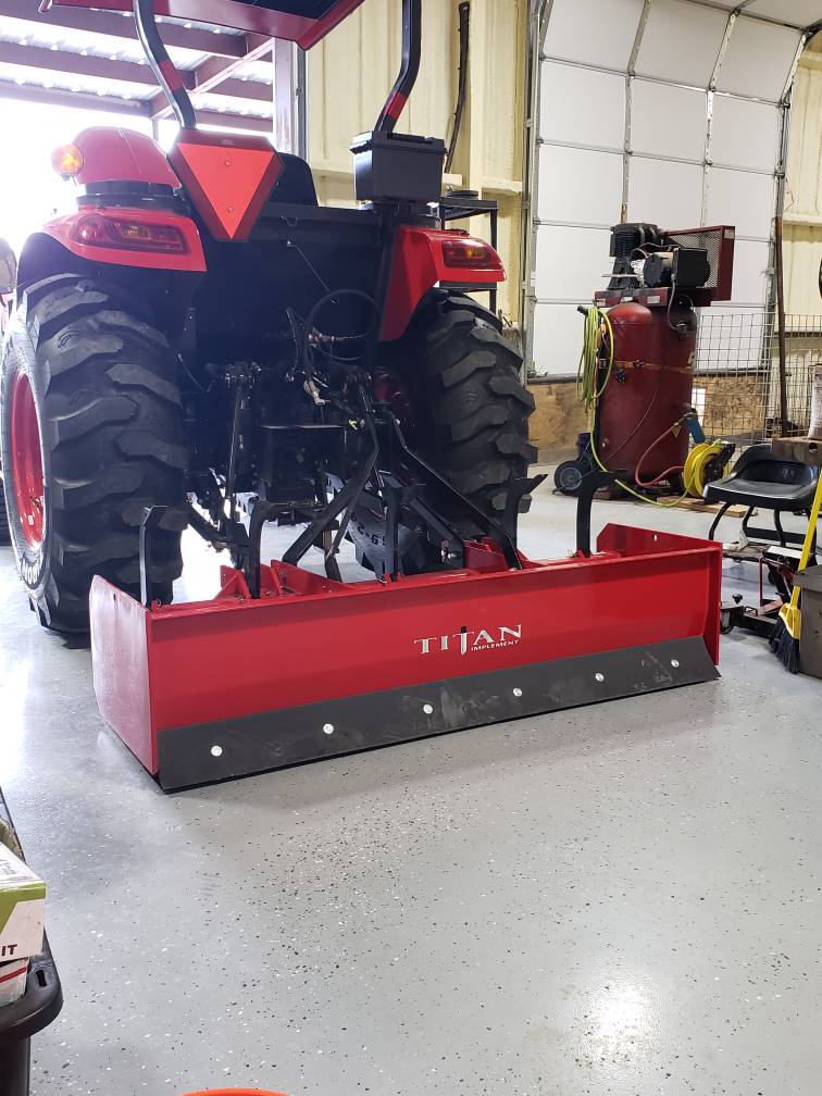

Added a hydraulic top cylinder and bigger tool box on my new 5835R 20200718_164924.jpeg20200718_165536.jpeg20200718_164928.jpeg

Nice Work! Looks like the top link is threaded as well. That seems like it would be a nice feature when the throw of the cylinder comes up a little short. :thumbsup:
   / Added hydraulic top link & bigger toolbox 5835R #3
Top links usually have ball eyes on both ends, and they are wider than standard cylinder ball ends so you don't need spacers to keep the slop down. Implements are not always square to the tractor and the forces on them are not always equal on both sides. Without that flexibility the cylinder shaft may get bent.

Looks great! Does Titan have box blades in red or did you have to pay extra? Thanks for the pics.
No extra cost. I think they have gray and red

What stroke cylinder did you go with? The 10"? B.
