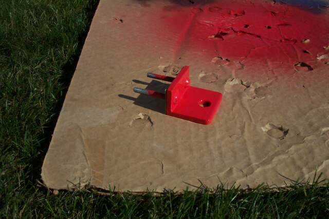

Well, I know it's not the best idea to add a trailer hitch to a zero-turn radius machine (Gravely PM260Z) but it sure comes in handy to pull a little lawn sweeper or a tow-behind sprayer. The only trouble is you have to remember at all times that the trailed attachment is back there and not to spin a 360 degree turn. Not quite sure what would happen, but I'm sure it would be bad. See picture of hitch with 'wet paint'. The bolt 'studs' were welded on so that I can use wing nuts to easily attach and detach from the mower. /forums/images/graemlins/cool.gif

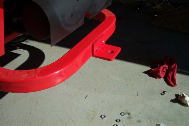

The hitch was made from a piece of 3/8 thick 3 x 3 angle iron. The bolt studs are 3/8. One leg of the angle iron was cut down to make it fit nicely on the mower frame. It's way stronger than I will ever need, but it's what I had laying around. Here's a picture of it mounted on the mower.

I know that with a tractor it is critical where tow loads are applied--if they are not applied to a properly designed and placed draw bar there is great risk of flipping the tractor under certain conditions. I raise this because I am not familiar with the Gravely and it is not clear from the posted pictures exactly how the tow load is transmitted to the machine--will the tow load tend to raise the front wheels?. Flipping the machine would be a lot more dangerous that any damage that might occur from a tight turn!!
   / Added Hitch to ZTR
Yes, the load will tend to raise the front wheels. But, the mower is designed to hold two or three cans of grass in the rear as a clipping collection system. So, my light duty loads should be no trouble. I have already towed a 25 gallon sprayer behind it to spray my entire lawn.
