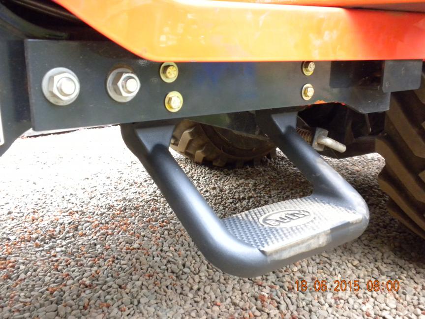

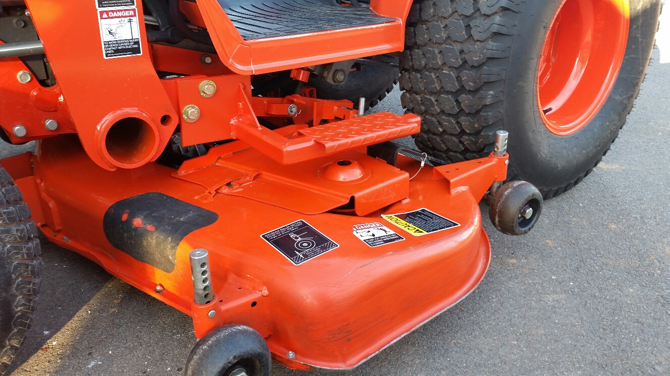

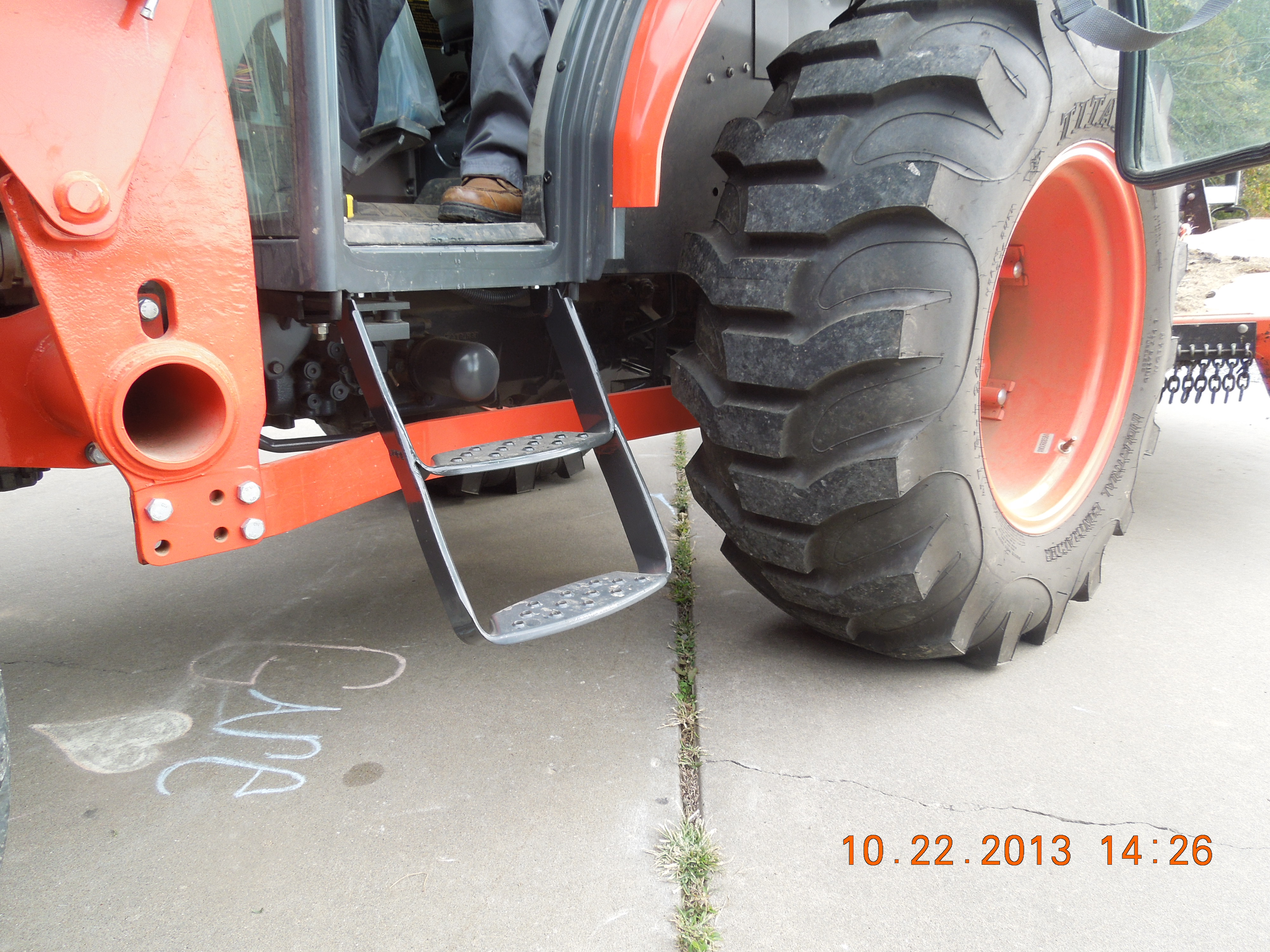

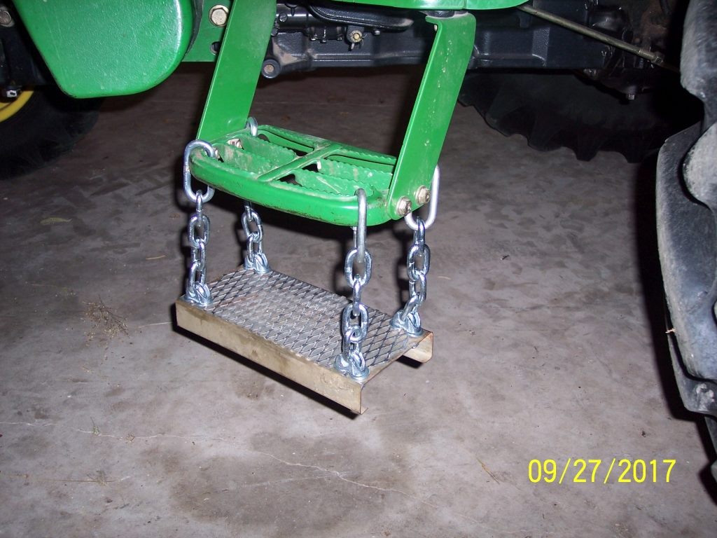

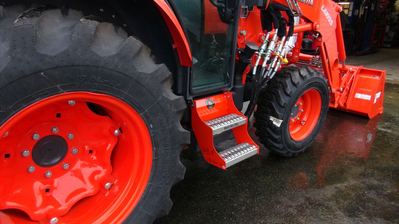

Several people have run into the same situation and added steps: sure helps.

If anything you can apply some non-skid tape to the metal ring.
Hardware shops sell it and it sticks really well. I've got black tape on the leading edges of my wooden stair steps and yellow/black striped tape (3 rows) in front of my workbench in the shed (concrete floor). It's never 'come up'.
   / Added a Step, to get on the tractor easier #8
Low steps are great until you bust a shin on one or you lop it off on some hidden object. Like all the new pickup trucks today have running boards on them. I call them shin busters.
   / Added a Step, to get on the tractor easier #9
Hasn't happened yet, but when it does, we'll do what we did on the OEM steps on our MF375, Case CX80 and M8540HDC and L5030HSTC: remove-repair-remount.
No slipping problem with this prior 'old man step', the one I put on the YM240 in 2006 and posted about it then. I recall only once in all that time coming off the tractor and my big-cleated 'milking boot' muddy and slipping. But since I was still holding on to the steering wheel with my weight on the other foot (expecting that anything could happen with all that mud) this was a minor inconvenience, not a problem. My steps aren't as elegant as other photos here (with new unblemished paint :)), but they work as intended. Design goals attained!
