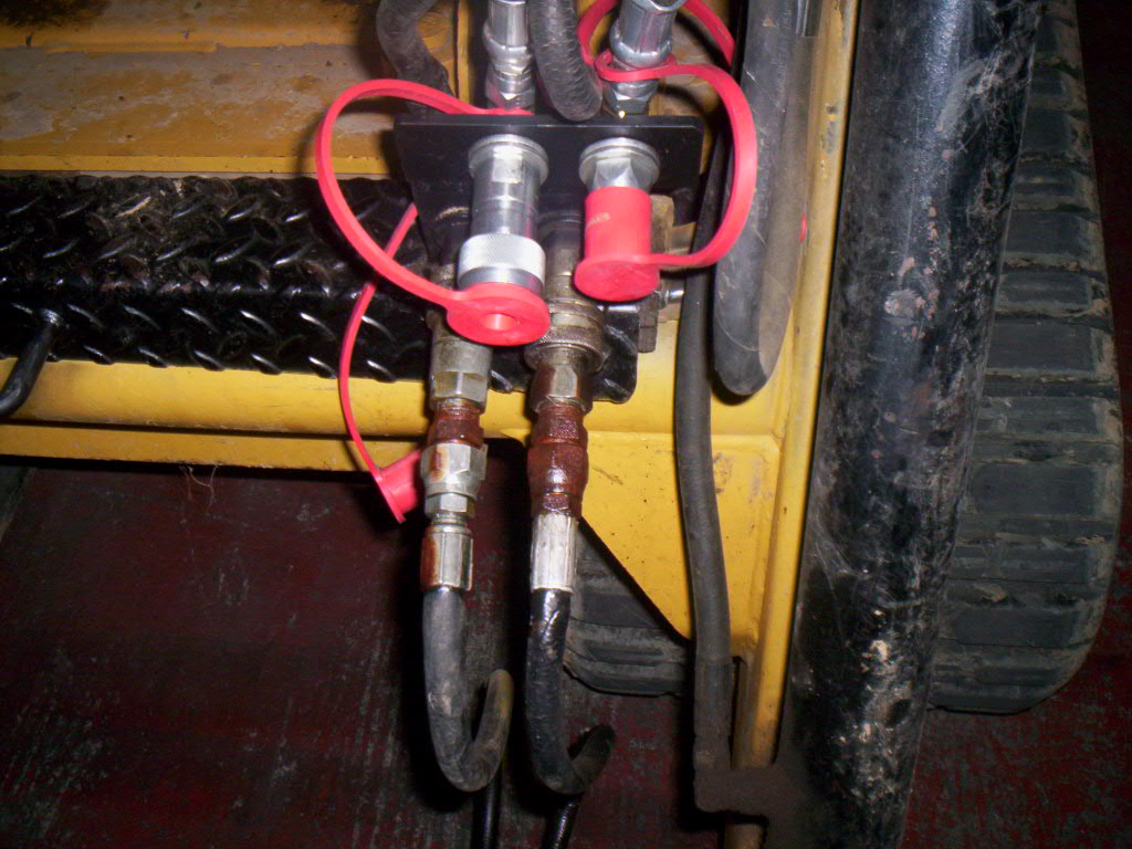

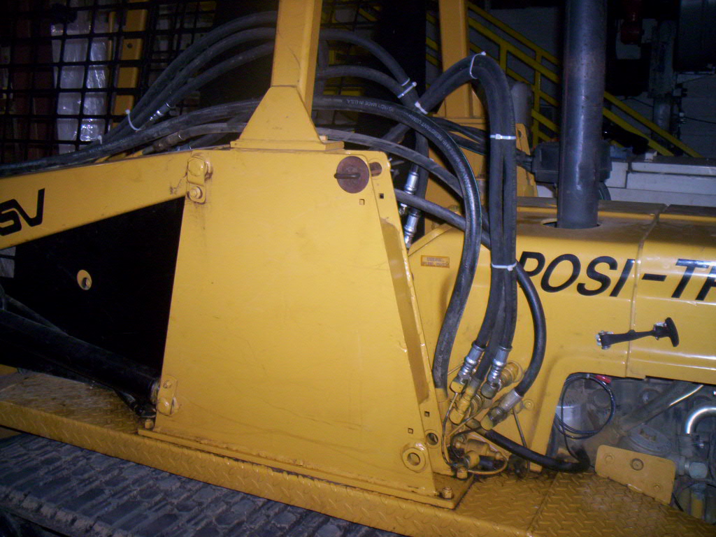

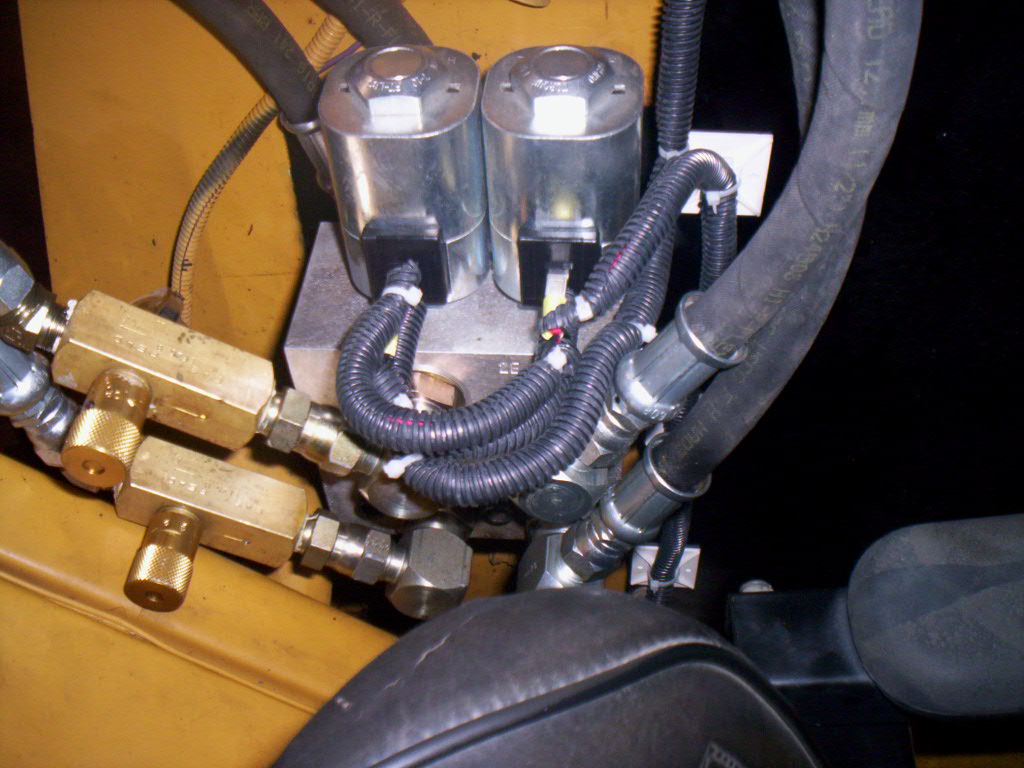

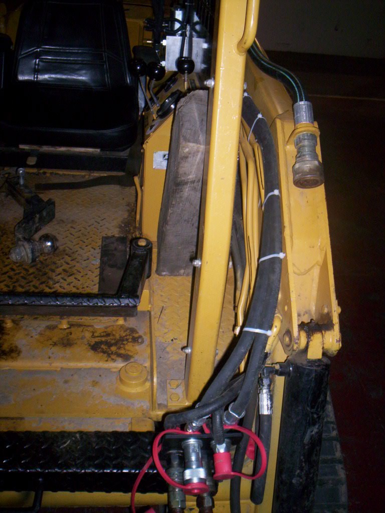

Here are a few pictures of the selector valve I added to our ASV 70. I got the valve from The Surplus Center. It is so that I can toggle between my rotator and my 4 n 1 bucket.

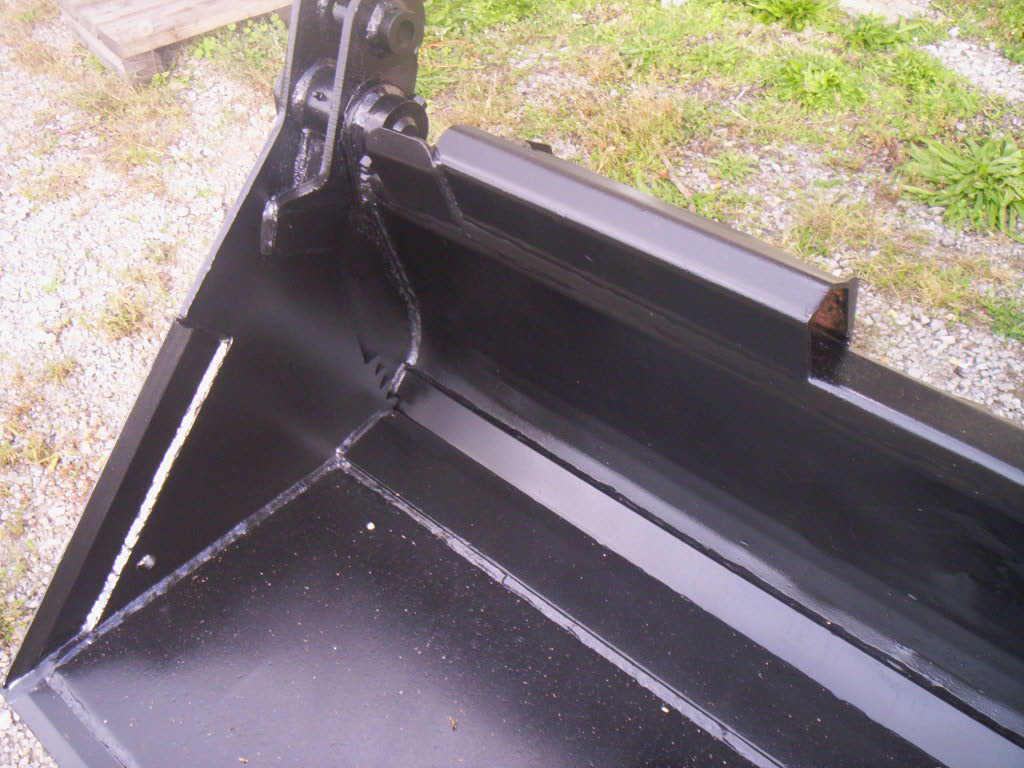

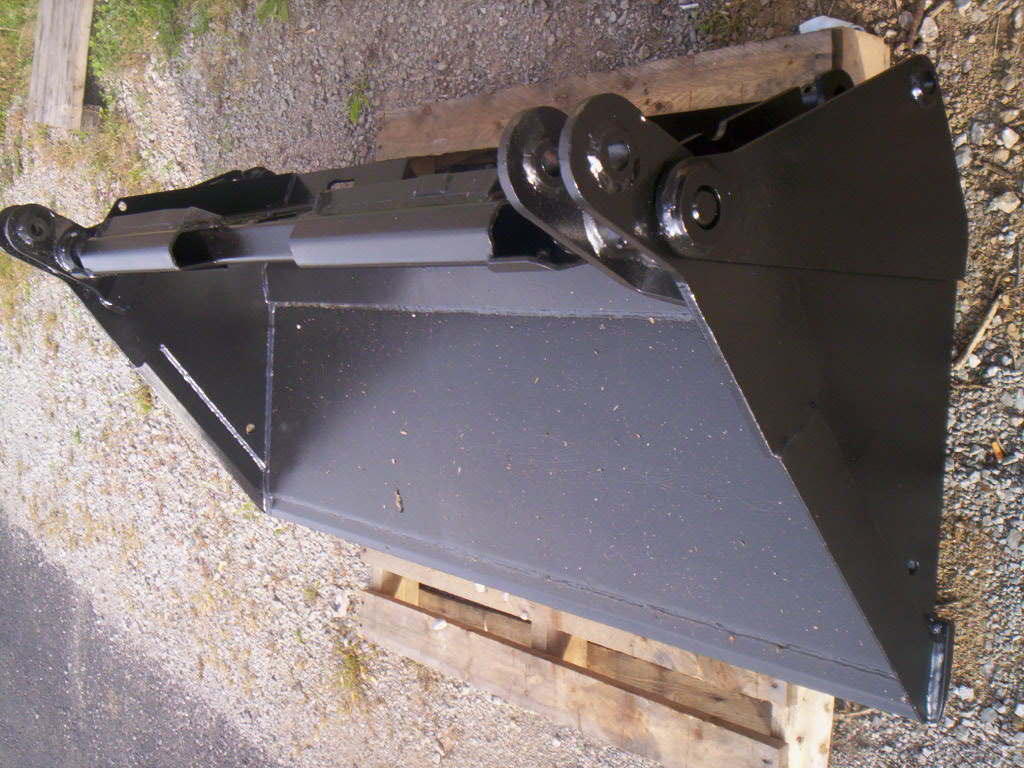

Here are a couple of the 4 n 1 bucket. I have the cylinders off right now. One was leaking from the rod seal so I sent them both off for rebuild.

Nice install, but for safety reasons, I would add a fold down steel plate between your head/arms and your valve and hoses. Pressurized hyd fluid has no mercy.
