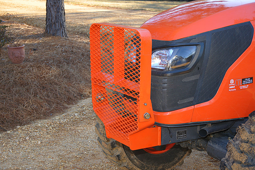

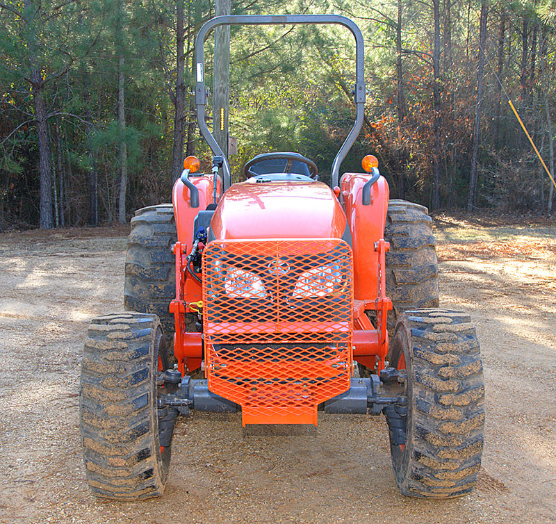

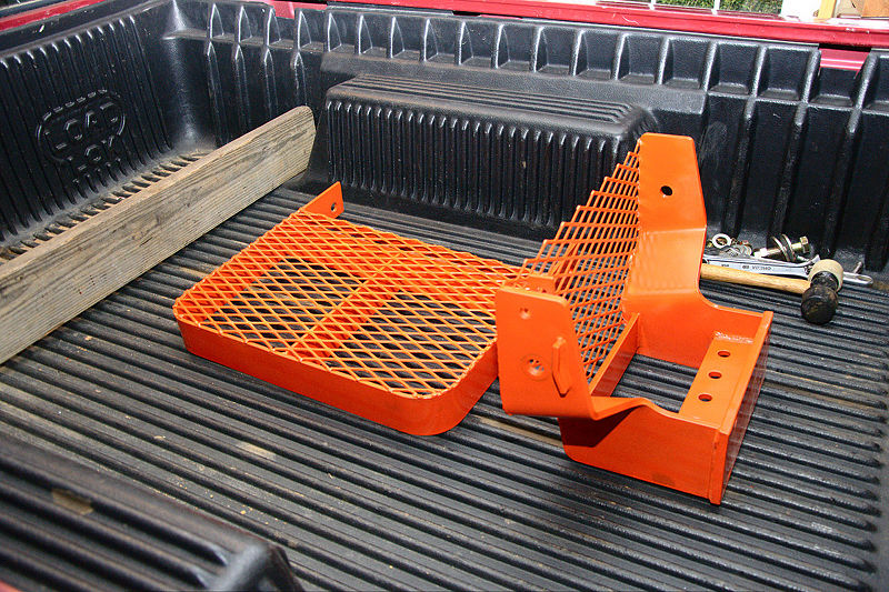

Today I finished up modifying my Kubota MX5100 brush guard with an expanded metal grill. Cut and welded the metal last weekend. Primed and painted after work during the week.
Unfortunately, because of the way the brush guard articulates, I had to use two separate pieces of expanded metal, leaving a bit of a gap between them on the finished product.
I should've done this last year BEFORE I jammed a stray limb through the nose of my tractor. :(

Looks real good I have the same grill guard I was thinking about the same thing!
I stuck a limb in from under the tractor and it took out the bottom tank of radiator. Did yours damage the radiator to where it had to be replaced?I could not believe the cost of a new one!!!
   / Added a grill guard
No. Thank goodness it only punctured the black plastic nose right at the bottom, resulting in a nice 6-inch split in the nose. Given the location of the impact, it would've taken out the battery before hitting the radiator if it had penetrated much further. Luckily it didn't.
I figured it was time to add a grill now that I've got a grapple and am spending a lot more time uprooting, moving, and piling gobs of brush.
