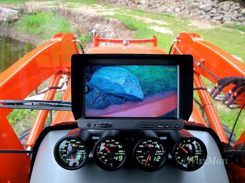

I had originally purchased this to mount on my JD855 to aid in using a rear blower. Never installed it as I upgraded to the LS this year, so it was just sitting there.
I find it difficult to use the SSQA, pallet forks, grapple and tree/post puller due to lack of visibility so I decided to mount the camera on the front of the tractor. The install was a bit frustrating as the instructions are written in Chinglish but after four hours I had it wired up correctly.
I did not want to drill holes to mount the monitor so I used a bungee cord to hold the camera on the dash behind the front WW motor module. It is a great location as it does not interfere with visibility and is easy to take a quick look down when I need it.
For the camera, I made the mount easily moveable by using neodymium magnets to hold bolts added to the license plate holder of the camera. This allows me to reposition the camera to the attachment or FEL frame wherever I need it for each application.
It has made operation much easier and is well worth the $70 and time to install IMHO.

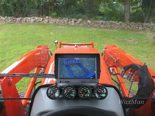

So you can see things like this when using the front loader or forks. IMG_1161.JPGIMG_1160.JPG

How did you power the camera?
   / Added a front camera to my LS4140 Cab #6
Lighter plug. It has a switch so I can turn it off when not required
So even though it's a wireless camera you still had to run a power wire from the camera to the tractor operating station.

Here’s another reason. On my xr4140 the quick attach and loader arms are almost perfectly aligned making it a challenge to line up properly, especially seated.
I could have powered the camera from a front light (but then I need the lights on all the time) or directly from the battery but it was not a big deal to run the wires the few feet to cab. It took about 15 minutes to route them along the FEL/Third function lines.
Also, I had heard that the wireless cameras can sometimes be iffy. I never tried mine as a wireless.
