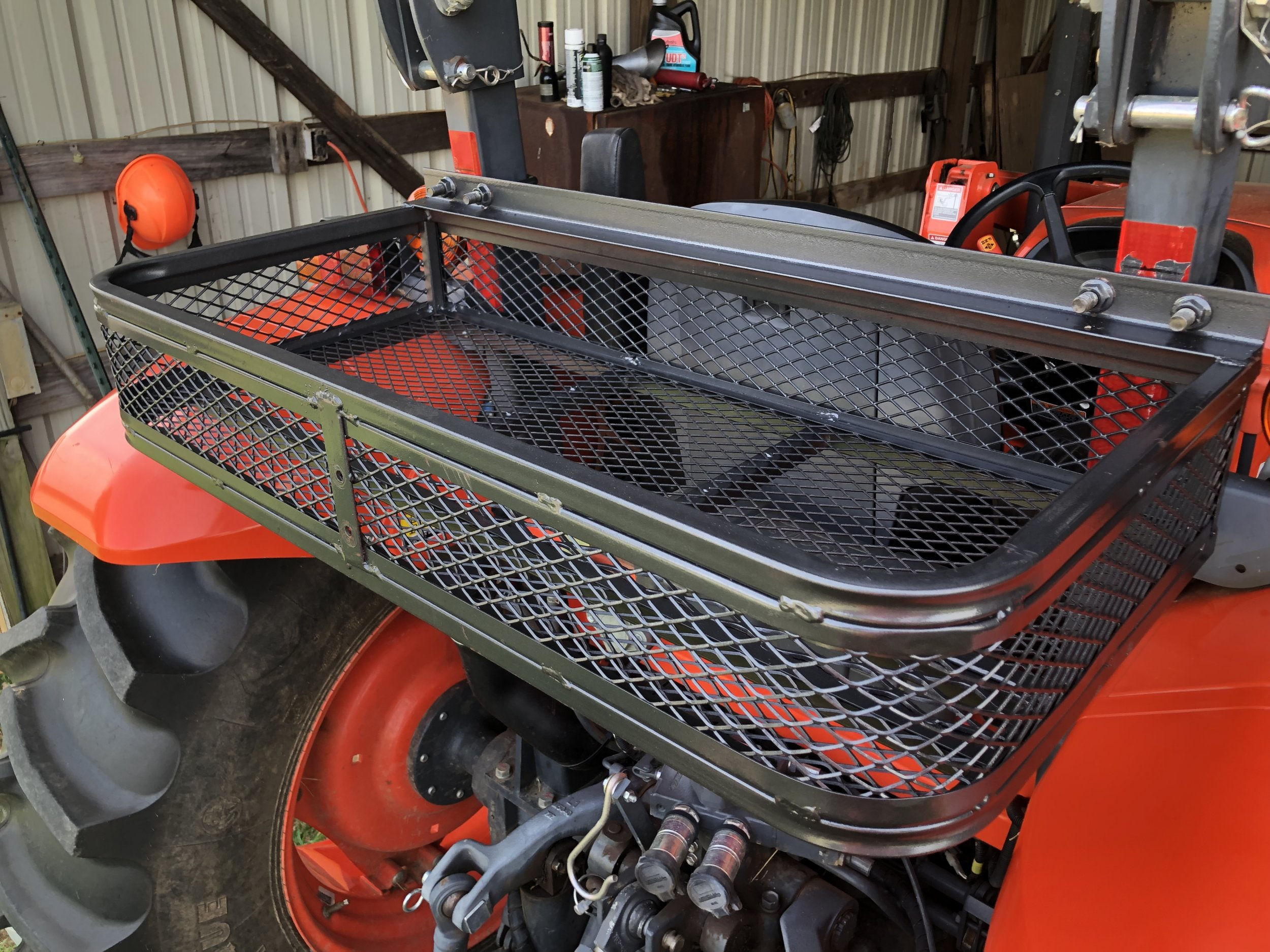

I'd bought front and rear baskets a few years ago for the ATV but decided I really didn't need them on the ATV. So I decided to use the smaller one on the M7060 ROPS to carry anything that will fit in it, a cooler with water, Gatorade, etc. when working on the other side of the property.
Pretty easy to mount. I just welded on a piece of angle iron to the top for a bracket and added rubber bumpers on the bottom to rest against the ROPS. I also had to fill a void in the center with some expanded metal that I had laying around. Drilled holes for the U-bolts, painted and got it mounted.

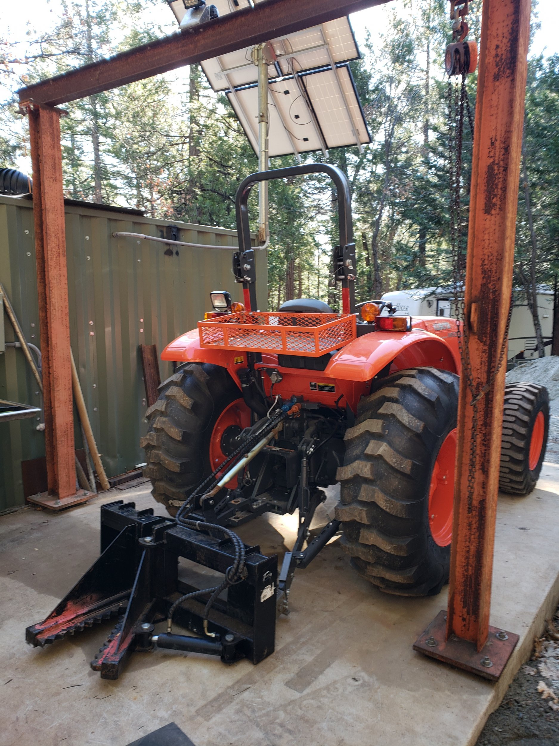

That is nice.
   / Added a basket to ROPS #3
Looks pretty, I had something similar until it got in the way of my top link.
   / Added a basket to ROPS #4
That would be nice to have on an OOS but I couldn't deal with it completely blocking my view of everything behind me.
